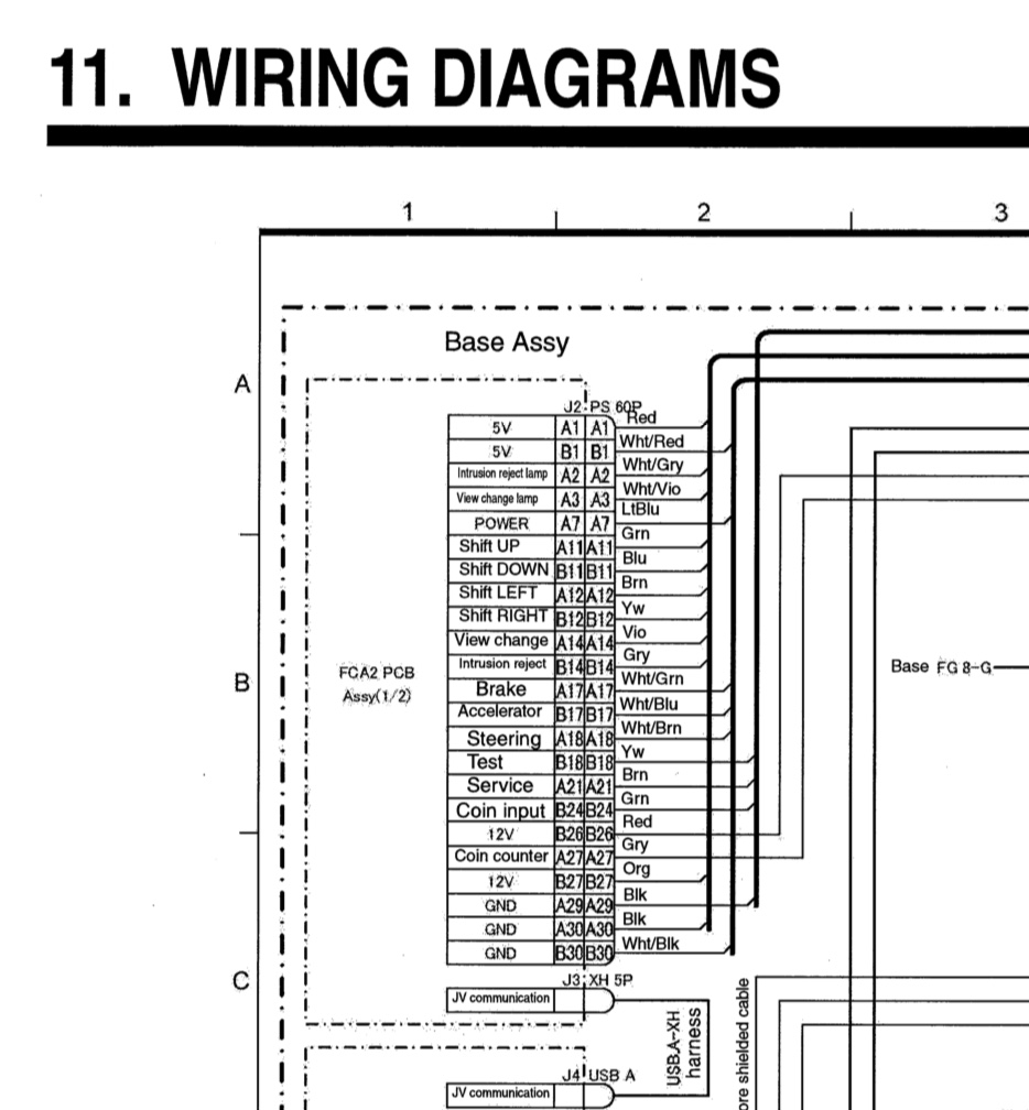

I am in the process of trying to get my Namco V290 IO to work with Wangan Midnight Maximum Tune on Chihiro... my path so far has been to hunt out the schematic. Since the game boots, my plan is to go into the test menu and try out the mappings I found in the manual at: https://www.bandainamco-am.co.uk/files/38
I've highlighted the pinout section in the jpeg attached.
Have you dug up your manual?

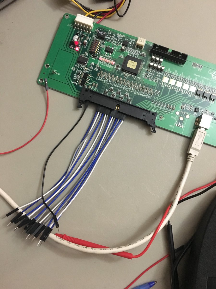

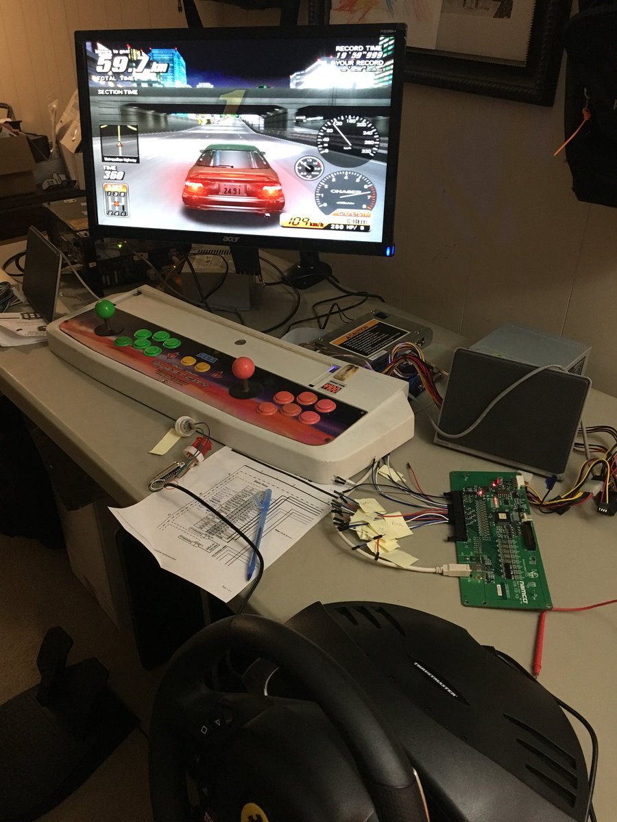

I'm gonna try to pin it out tonight... @Symphony I don't see why you couldn't try similar.

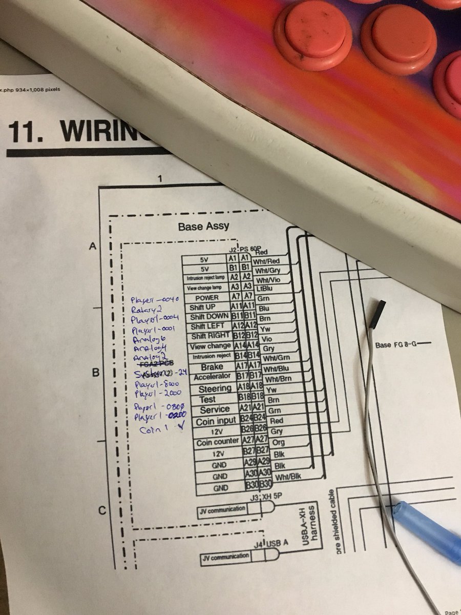

I'm literally using the schematic as a rough guide, spot checking the pins for +5 or +12v before grounding them, and going into the JVS Test menu to see which inputs are triggered.
I printed out the diagram, and have just been writing down the results of the probing.
I just picked a ground, broke out the signals I want to test with jumpers, and am now working through the Test menu.
The Analog's go to all 0000 when you find them, and the rotaries go to all FFFF. The other inputs will alter the values in SYSTEM, PLAYER 1, COIN 1 & 2.
Next I'll go into the game test menu and verify what is getting triggered.
You can see here in the in game test similar things occur when you find the right pins...
Note in one picture when I have it grounded out the "Gas" input is zero'd out, where as when it is NOT grounded you can see the value floating.

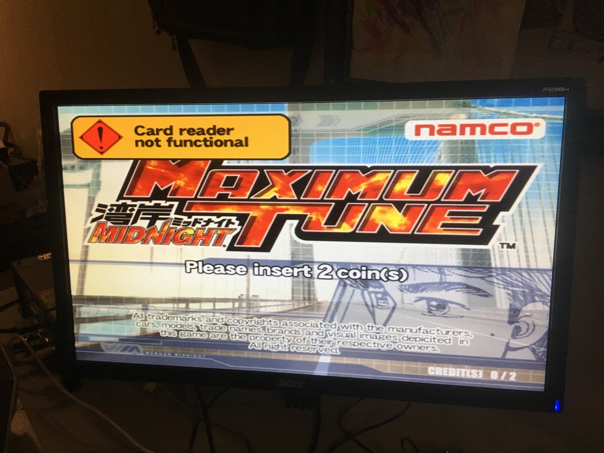

It ain't pretty, but I've got Wangan Midnight Maximum Tune running out of the cabinet on my bench now. I'll make a proper harness soon, and make sure it is playable. All of the pins seemed to map out to the diagram I originally posted. (I had seen reports of other people finding schematics that didn't match so I wanted to double check in my case).
I would imagine you could do something very similar @Symphony, Just a little bit of time and patience, and they should pin right out for you.
