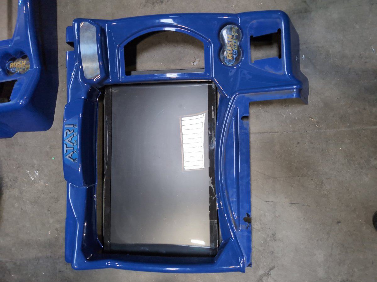

Here is a photo of the cut bezel + LCD. I have two of these. Feel free to DM me if you are interested and to get a shipping quote. They are 1080p60 32" with VGA input and they accept 640x480 over VGA as well. You will need to rig up a mount with wood or a VESA mount but it shouldn't be too hard.
Thanks for the pics man that looks decent.
I was trying to figure out exactly what was modified on that and I couldn't even tell what was cut. Can you let me know just so I can pinpoint it lol? I'm surprised those 32" fit like that to be honest I would have thought they would be way wider than that.
Also it looks like the 32" is still a bit larger to fit as far as width goes (I see the bezel on the right side in the other space next to the monitor cutout) so does that mean that like part of the screen would be cut off the whole time if using those monitors?

Apologies that the photo doesn't show it super well. The inside edges have been cut to fit the 32" monitor; if they were not cut, the bezel would sit on top of the monitor in that photo.
Yes it will have some cut off but the previous owner just adjusted the image to make it 4:3 and *technically* off center to fit it appropriately within the bezel. When installed on a cab it looks very good. You could also have it adjusted to have a more narrow 16:9 image as well.

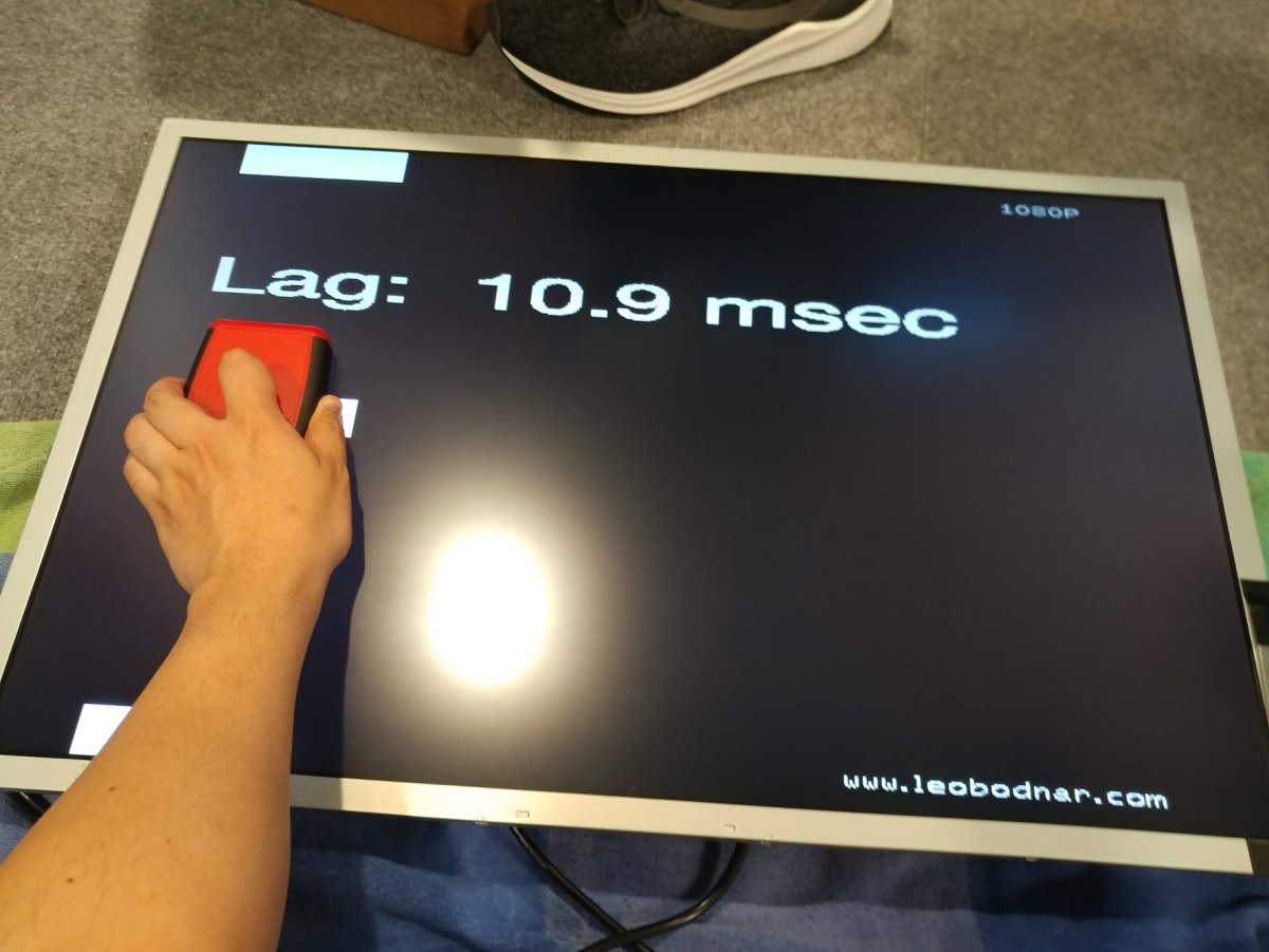

TBH the bigger issue with this monitor will be pixel response/refresh time anyways. High speed scenes look a bit blurry, and I struggle with this when I increase the note scroll speed in DDR/ITG. For racing it may give a smear effect, although I don't know how severe.
I haven't looked into the testing methodologies of how 23ms was determined, but I personally measured a U3011 with a Leo Bodnar tester (which is based off a photo diode, similar to the Time Sleuth) many years back, which is where I got my number. This was done at 1080p since Leo Bodnar devices are locked to 1 resolution. Time Sleuths can test different resolutions, but it's probably not worth the effort for me to dig out my gear and retest everything.
I tend to ignore numbers I claimed online unless I can verify how they tested for a variety of reasons.
