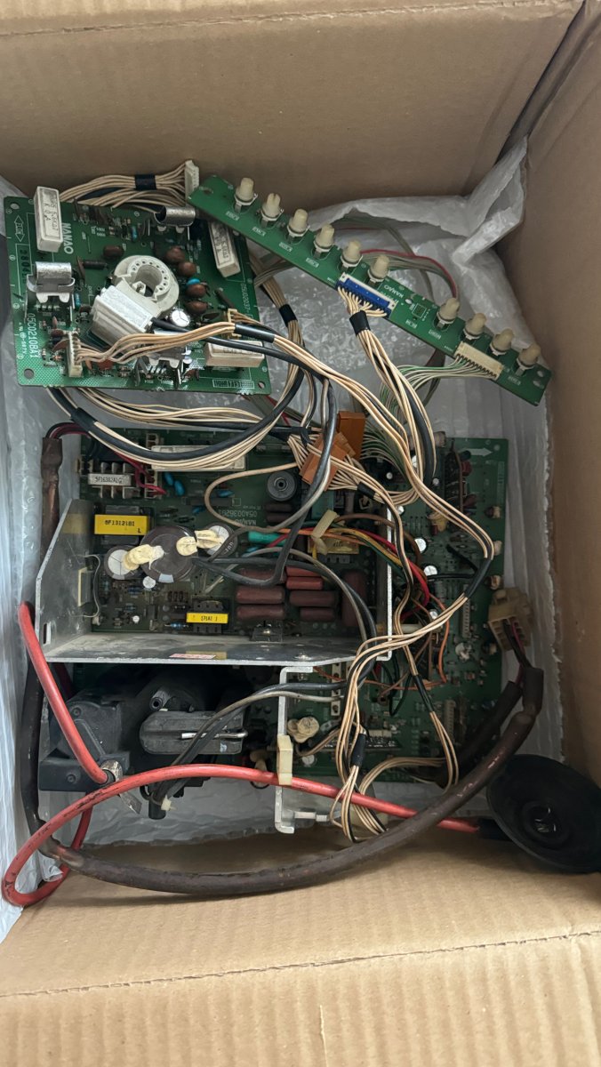

Hello.
I have a nanao ms8-29 for sale. (From spain) let me known if you are interested

Are you sure you're not looking for a MS8-25? MS8-26 has a very high impedance vertical yoke, so that isn't compatible. MS8-29 could probably work. You will want to drop B+ by some margin.

The HV too I think yes? The HV setting is kind of dependent on tube sizes was my understanding.
