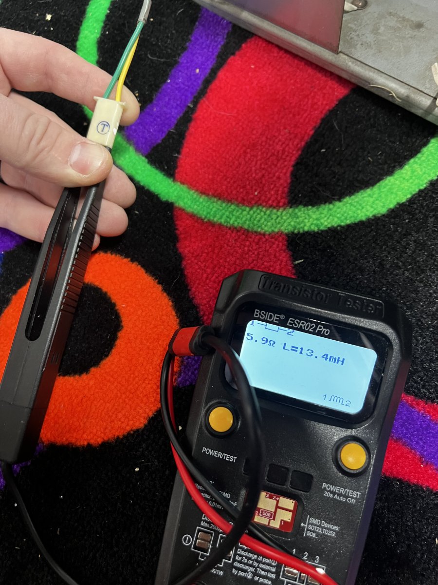

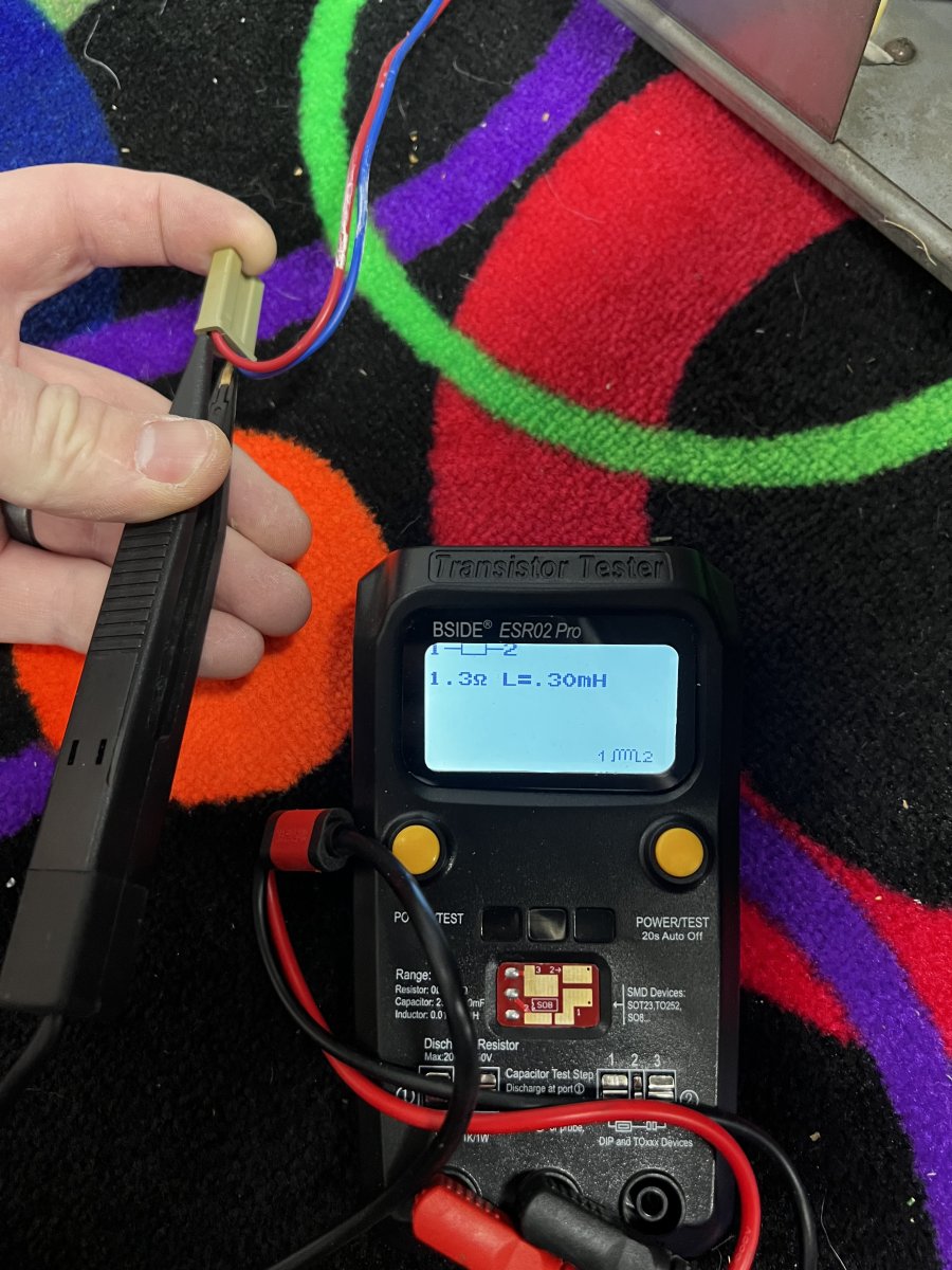

Here’s the yoke measurements:

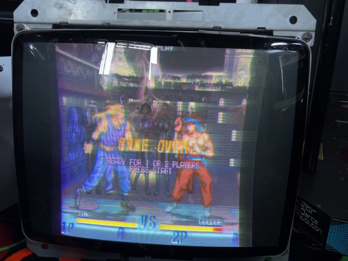

There were some connector modification I needed to make to get the connectors to work with the chassis, connected everything up and got this:
Looking over the yoke measurement thread, I’m thinking the yoke may not be compatible with this chassis. Has anyone been able to make this swap? Additionally, if this is compatible, are there any resistors that should be added on the yoke?
Is that with the width pot maxed? Did you also adjust the horizontal size limit pot?

How did you splice the new connectors from the Toshiba D29CR55 yoke to mate to the Nanao MS-9? Did you remove the old wires completely and solder new wires to the headers of the yoke or did you snip the existing wires and crimp new terminals to match the MS-9 connector? Sometimes the vertical section can have three headers with different inductance readings depending on which two were used.
The image looks like yoke incompatibility but we know that the Ms-9 and Toshiba yoke are compatible. I assume this chassis is known working?
Admittedly I remember it having horizontal adjustment issues in my e29, but didn’t pay it much mind there.. I have a few MS9 chassis I can test with this tube, but I’d rather not pull another just to discover the same issue 😅
Snipped and crimped
In my e29, yes.
I also checked b+ voltage and it’s at 77.55 VAC.. slightly above the suggested 76 VAC that is suggested, but still in the right neighborhood.
Is this a recapped chassis?
Anyway, fault is 100% on the chassis. Try replacing the caps near the geometry adjustment pots on the chassis.
That explains it. Check Q508.

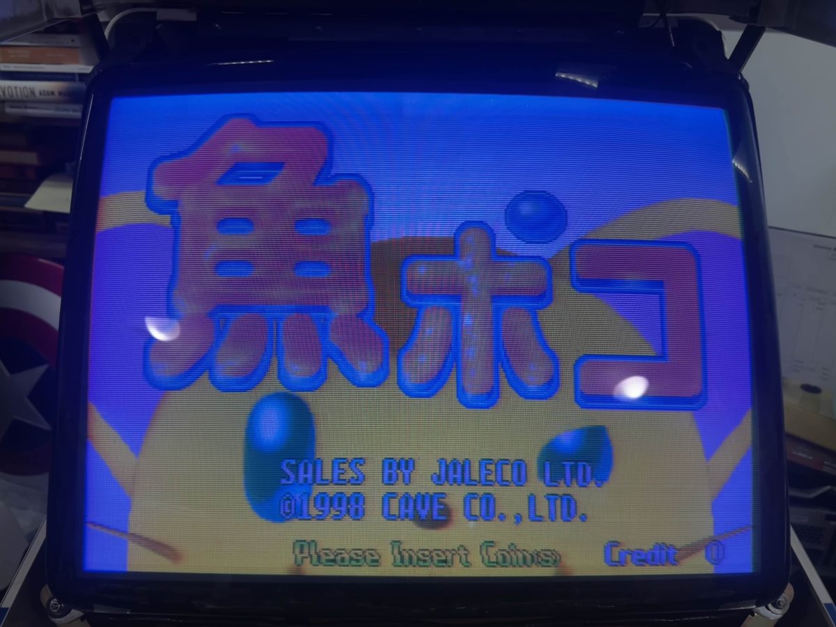

so, following up on this FINALLY!
Turns out Nem was on the right track. I was speaking with @cruzlink2 about this issue since I had recapped it and it persisted. He suggested I follow his advice here:
https://x.com/Cruzlink2/status/1602763213170524160?t=ZIWT-tPauR52a3iodHsoEg&s=19
and sure enough, that was the issue. Pulling the solder off the contacts, scraping the mask off the traces and linking the pins with the traces a bit better resolved the issue. it's looking good now
believe it or not, it looks much better in person. now that I know this chassis was the cause of the issue, I'm going to put my spare MS9 on the TOSHIBA tube/yoke I mentioned above. given that it's the same model chassis, it'll likely work great. I'll update when I get the other chassis back from repair.
