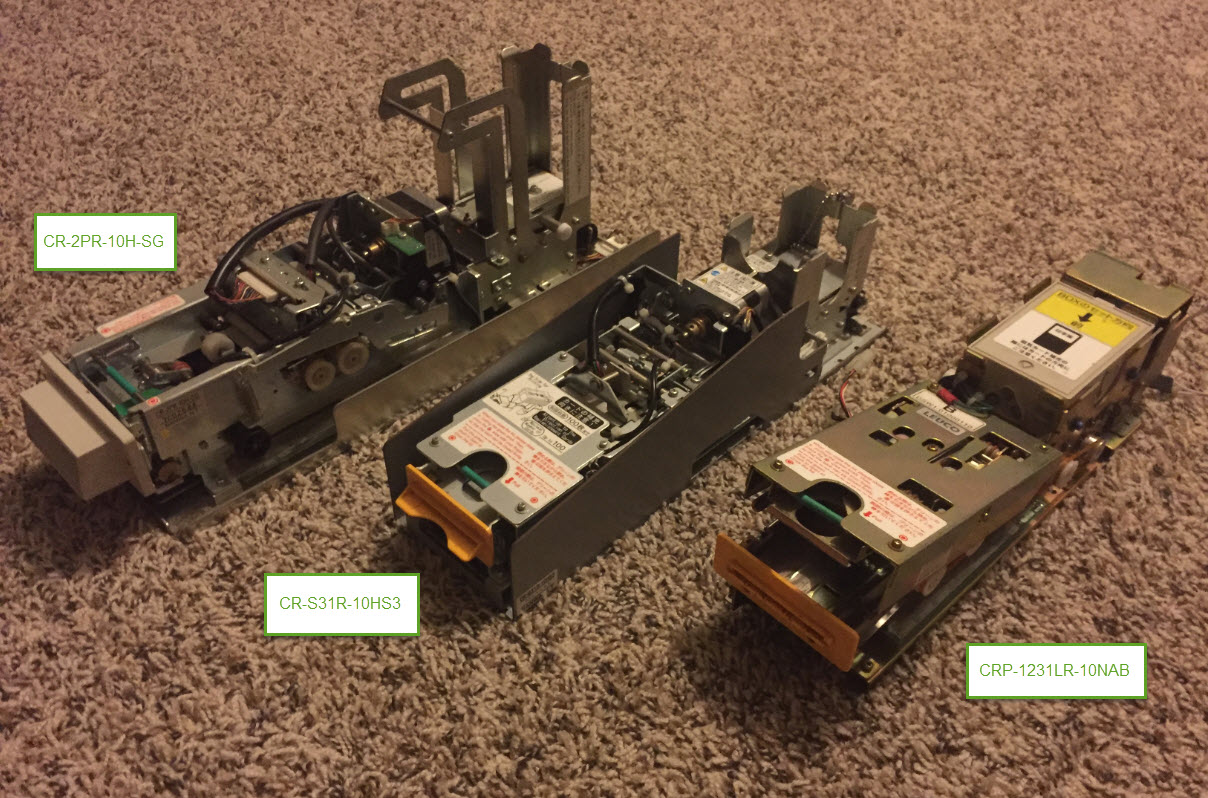

As @winteriscoming mentioned, all wiring is identical between MT1/2 and MKGP1/2. The shifter triggers the item in MKGP1/2. DIPSW 4 is the only difference when running either game on the same hardware.
The card reader for MT3/3DX/3DX+ is completely different from the MT1/2 Card Reader. The MT3/3DX/3DX+ card reader has an additional set of DIP settings on it.
The MT1/2 Card Reader will work with MKGP1/2.
Middle: MT3/3DX/3DX+ Card Reader
Right: MT1/2 Card Reader (works with MKGP1/2)
There are 3 sets of DIP Switches on the MT1/2 Card Reader that need to be set to work with MKGP1/2.
I can't find the post I made a while back that has the MK2GP switches documented. If anyone needs the settings I will try to post them.
Maximum Tune 3 card reader
The card reader I have works in both MT 1-2 and MK 1-2 with no changes. Admittedly I only tested MK through a couple races, but it wrote data to a card without issue. I used a DOC card, which lacks the ability for the thermal printing to be erased, so the face ends up being a mess. MT and MK both utilize cards where the face can be erased and printed info rewritten.
