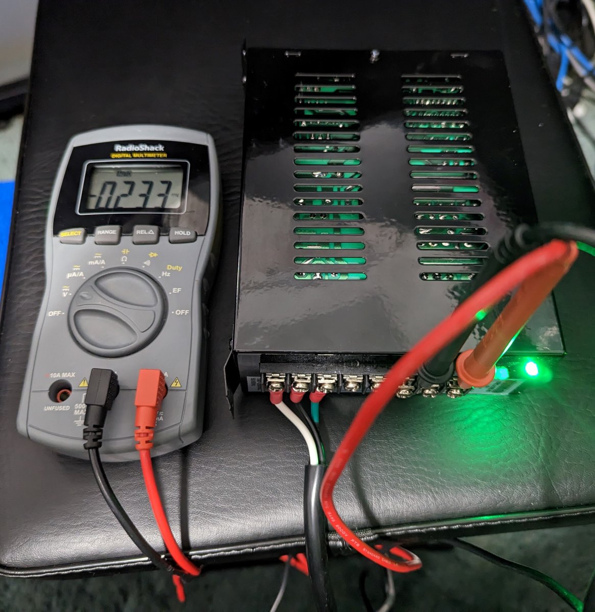

I just got a new arcade PSU and have wired it up to be plugged into the wall. Before I plug any boards into it, I want to try and dial it in to as close to 5.0v as I can. I freely admit that I'm not an EE but I have had this MM for quite a while (even replaced the battery today) and Im just not making heads or tails out of this. Here are some images:
Ive got the PSU plugged into power, with the + probe in the 12v port and the - probe in the +5.
As you can see my readout doesn't seem to make sense (at least not to me) Turning the adjustment knob does make a difference but it doesn't get me anywhere near 5v.
Here is my MM selected to direct current readout:

Ok yeah that doesn't look good for the meter. Your PSU should at least be in the ballpark without a load hooked up, but when it does come time to dial it in, you will want a board hooked up.

Power supplies have to be tested under load. Turn 5v most of the way down, hook up something that draws power, and measure/adjust from there.
+1 for this - huge variety of power supplies and implementations out there, but some (many) of them need to have a certain level of load to supply an accurate reading, or in some cases to generate any current at all.
Meanwell in particular are notorious for this.
What's the make/model of the power supply you are testing?
Correct me if I'm wrong and maybe I been using my dmm wrong for many year but.....don't you put the black comm lead on GROUND and red lead on +5v or whatever lead you want to read? If I put my Black comm lead on 12v audio and +5v it wouldn't read either....
Why would you do that?
+ probe goes to the voltage you want to test, - probe to gnd.
Also when measuring AC voltage (like a wall outlet) you need to set the meter to AC. The power supply +5, +12, and -5 are DC voltage.
Also as everyone has said, most power supplies need to be tested with a load. Just turn it all the way down, connect it to a game, then measure and adjust it while it's on.
Not trying to offend but I would take a moment to watch a few youtube videos about how to use Multimeters we all start somewhere.
It is a little cryptic when your first ever starting with this stuff but its really easy when you understand what is happening and the symbols.

You need to set the meter to DC mode which has the V with a solid and dashed line on it (one position below in your video).
When you change your meters mode in the video you will notice the squiggle ~ this is for AC alternating current like what comes out of your wall.
You wont see anything DC really when set to AC mode. Your power supply takes AC from the wall and converts it to DC 5V 12V etc, something useable for electronic boards.
I also would not change modes or turn on your multi meter while power is applied to it but thats just me.
Also and maybe I am wrong as someone else pointed out, it looks like you have your red positive probe on 5V and your black negative probe on 12V.
This really is not advisable at all if this is what is happening. You are shorting your 12V rail to your 5V rail.
The screw terminal marked GND is where your black / Com probe from your meter goes and your Red probe from your meter goes to the voltage you wish to check (IE + 5V DC).
THIS IS FOR DC measurements not AC
Current / Voltages flow from positive to negative / GND. So if you dont have a ground source you wont have a path for electricity to flow properly.
Think of it this way your multimeter is inbetween the path of flowing electricity and your meter is sampling/measuring that flow. So you need to have your source of electricity 5V flowing through your meter to a ground GND.
You should also have something connected to your power supply that is pulling electricity from it maybe a cheap board you dont care about or something.
Some power supplies will not output or do not output fully unless it has a load (something pulling electricity from it)
Your output you measure from the power supply can also vary a little bit depending on the board connected to it because the demand/load of that board can be different. This is another reason to check this way.

No offense taken, I appreciate the breakdown.
The video I linked to shows the guy placing the probes in the first two terminals. While my PS is not a suzo happ ( @hatmoose its a RetroArcade MH-16A) it has the same terminal set up as the one in the video.
I was wanting to test it without a board connected because I only have three available to try, two of which I don't want to even run the risk of burning out, and the other I know is a busted board (Neo Geo 1 slot with an Issue I cant recall at the moment). I wanted to get as close to 5 as possible then install it fully and then really put it through a test. If it blows the Neo, no big loss. But I dont want it to even risk blowing the other two boards, a PGM and a Primal Rage.
In the video I posted (of me) I do have the probes reversed, but at first as you can see in the first images, I have them set as the guy in the Youtube video did. Regardless, I dont know where the disconnect/misunderstanding happened because for some reason it worked on his end, but on mine it was all out of whack. That's on me.
My brother in law's MM is reading near 5v now that I have it set to DC as you mentioned.
