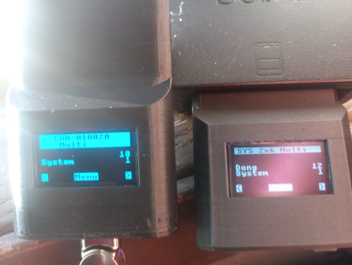

Its a sd2psx. I'm using it for research, im not interested in dongle conversion and bootlegs. I like collecting knowledge and ps2 based tech.

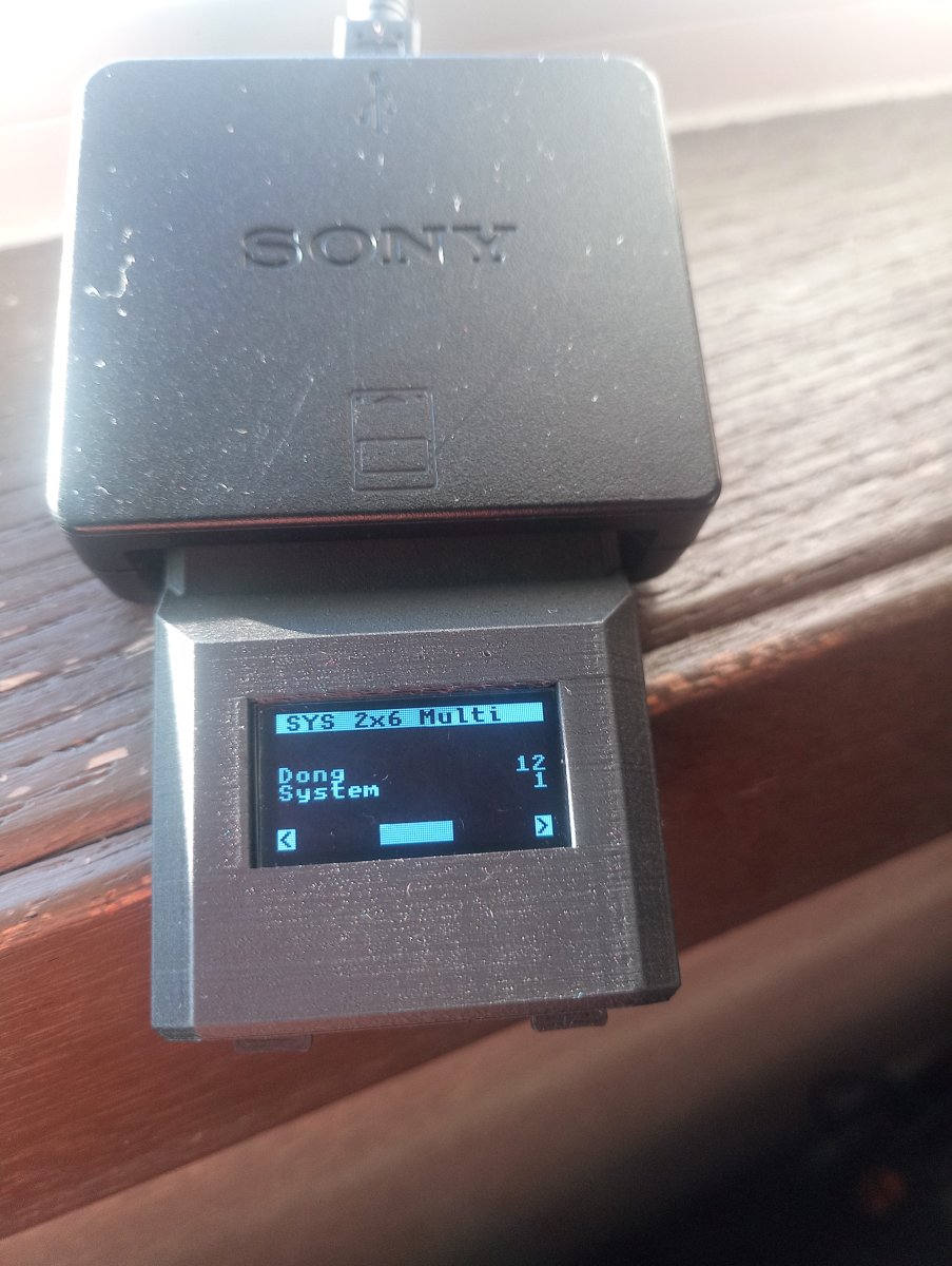

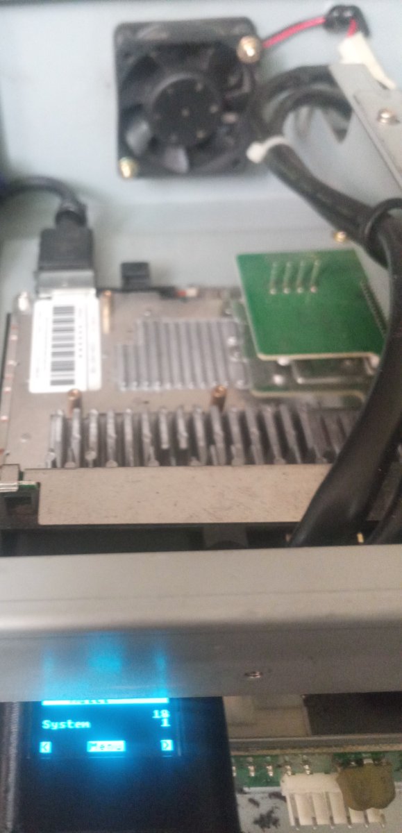

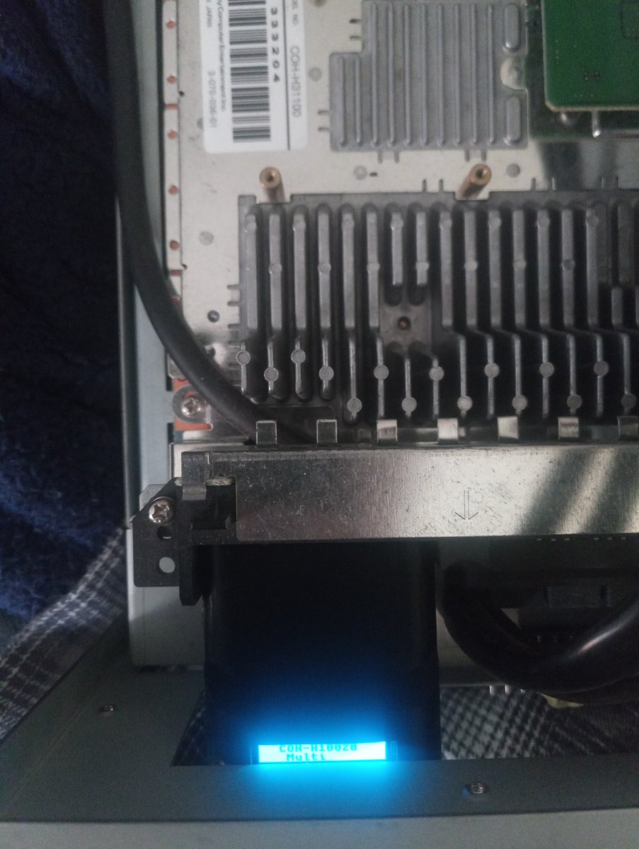

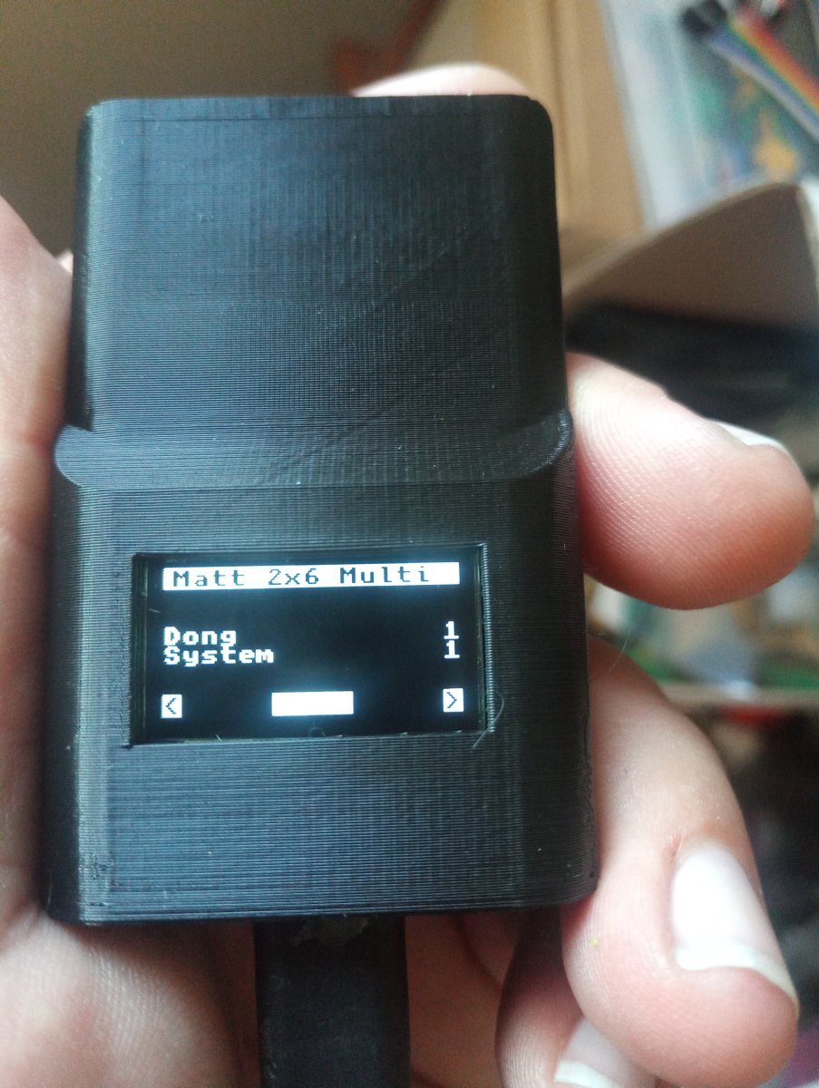

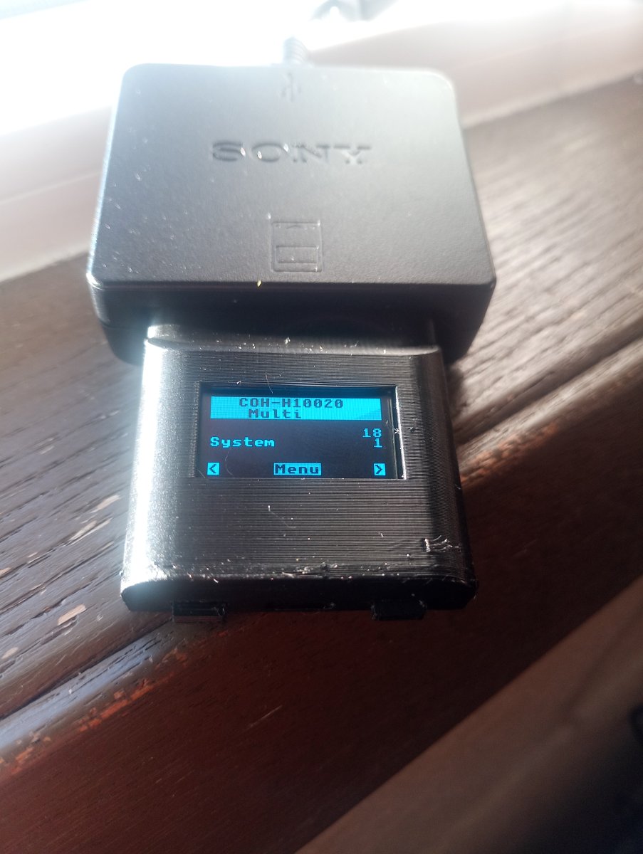

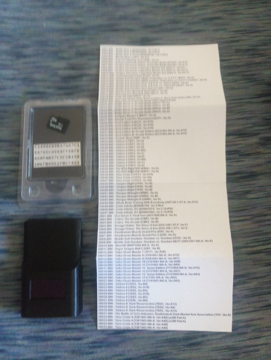

It is possible to make a multi from a sd2psx (I made one for a friend and baked his name in it) and it doesn't fit in a 256 without the use of a multi-tap as a extender.
