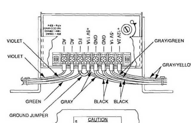

Yeah I think you’re right. I didn’t see it labeled on the wiring diagram but I didn’t look that hard either. But I just found a drawing of the psu in the manual and it has a -5v connection.
looks like it doesn't use -5v? I can double check... my harness later.
Also looks like the 24V is indeed AC.
Indeed the image @KaPH33n just linked is what I saw the first time around, but the image I posted is in there too. Hooray documentation!

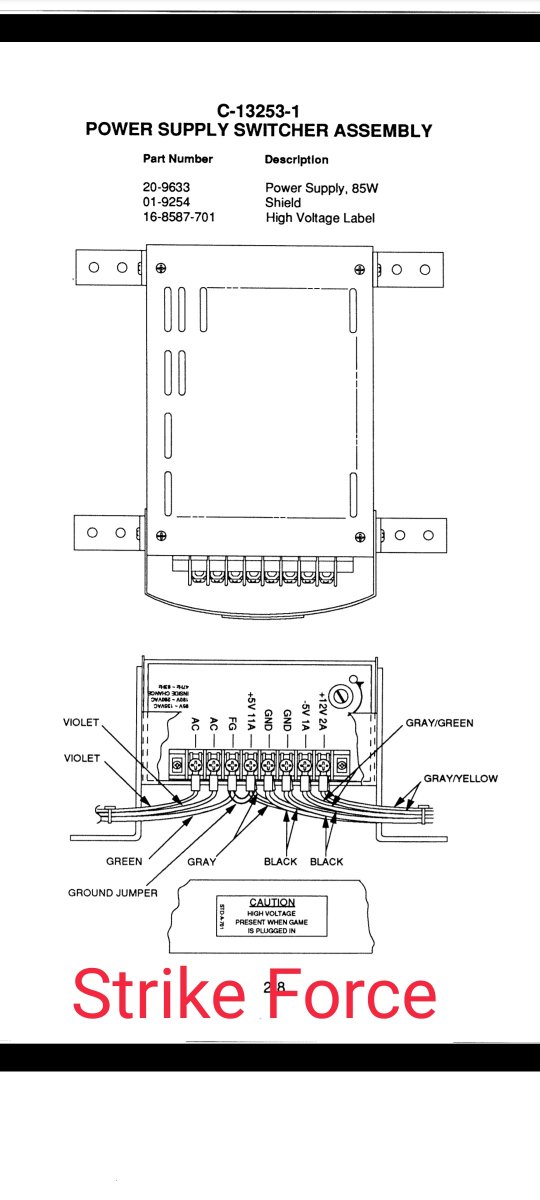

Has anybody else here noticed that the drawing shows earth ground and +5Volts jumpered together …. 😳 seems to me that would be a really bad no no ….. any thoughts?
This figure has had me scratching my head, too. I believe this to be errata in the document, much like how the the control panel fuses are nowhere to be seen in the schematics or diagrams.
I went and looked at other Midway games that were released around the same time to compare how their power supplies were shown in their manuals. Strike Force has the same drawing as Terminator 2, showing the +5V source tied to earth ground. However, Total Carnage shows earth ground being tied to DC ground, which makes much more sense in my mind.
Hopefully someone who has experience with these games can weigh in.
