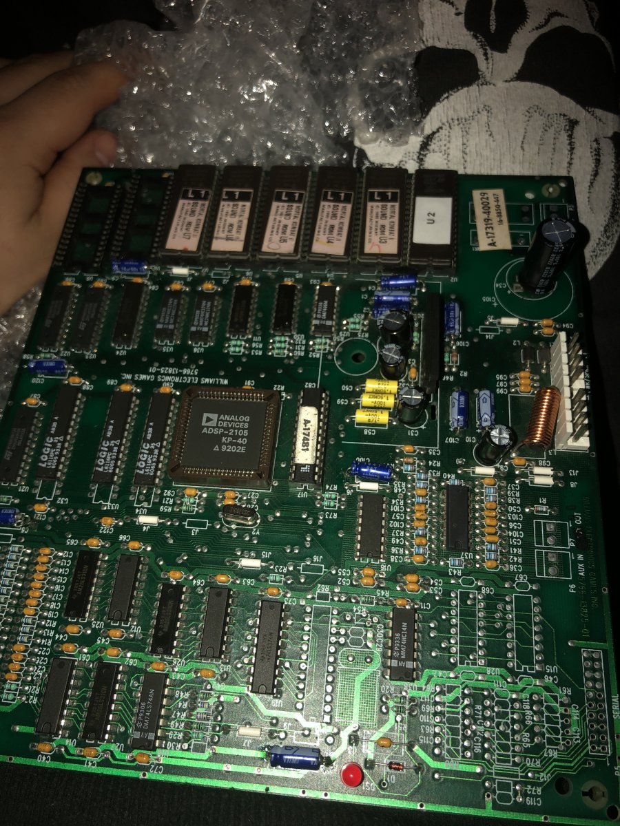

Ok so this is what ive done :
Replaced the caps on board with a cap kit
Replaced the clock krystal
U37 replaced
Replaced the gal chip
The black amplifier under the metal peace..
Also replaced the u2
Checked the eproms in the board with a program there all good …
I dont know what else could be wrong?
Im almost ready to give up on it.
No only static i hear man and its driving me mad tryn to fix it
I was going to say ribbon cable but you stated that you have a spare working one. What about the DAC? Or maybe the headers on the ribbon board adapter are bad? There is interference happening so it could be a chip you missed that is going bad to make that kind of sound.
