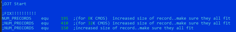

Well, there are some other ways, Midway made internal versions that use the 8k x 8 sram. These are identified as M1.3 instead of L1.3 for example.
The 8k version has a little less player records but 195 should be more than enough.. ;)
I can build a version for you of L1.3 w/ 8K chip support. Actually it's already in the source leak. (but with PIC security still intact.)
