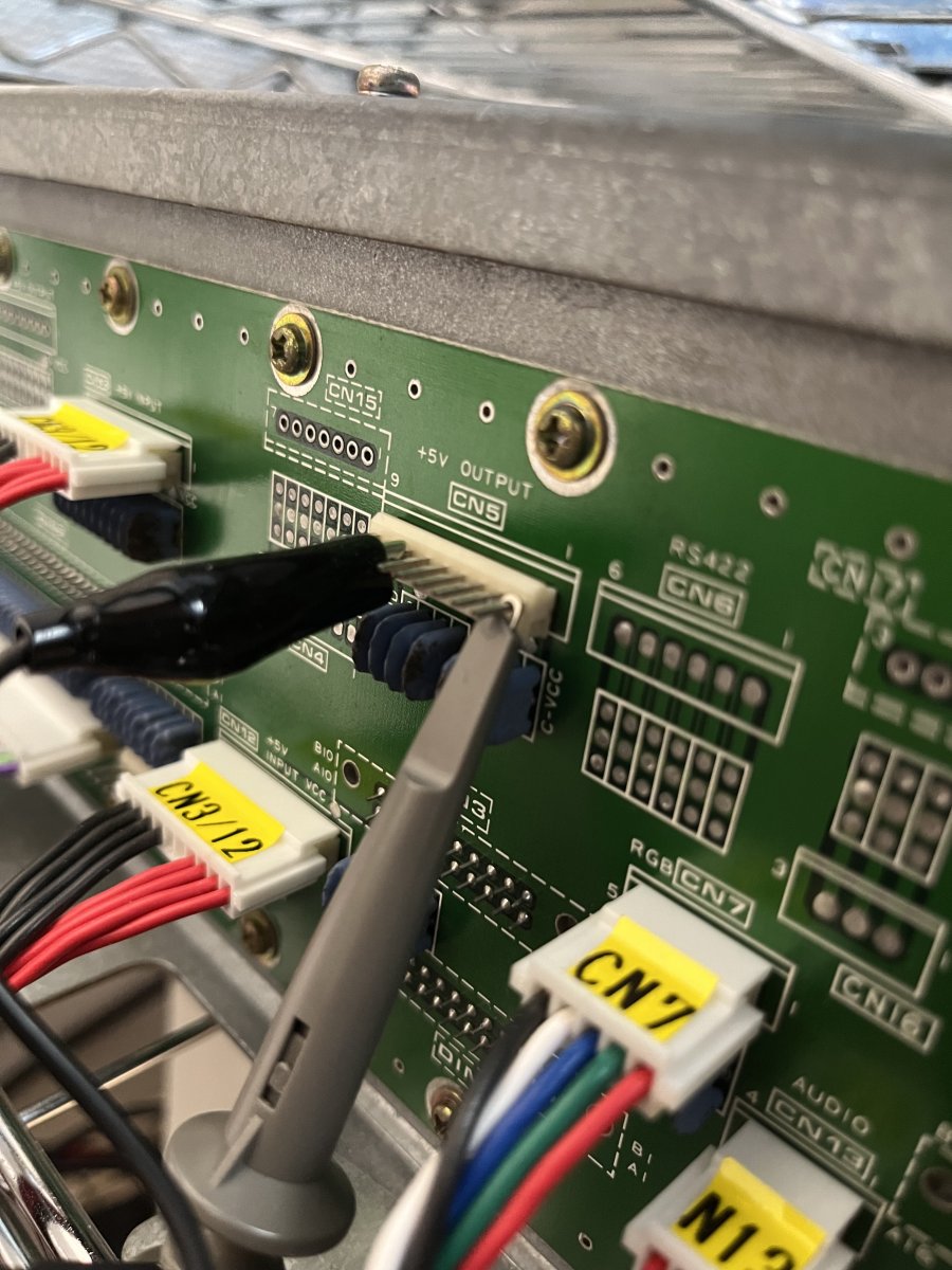

Based on @mugen's post here:
I inspected the +5V output from the board.

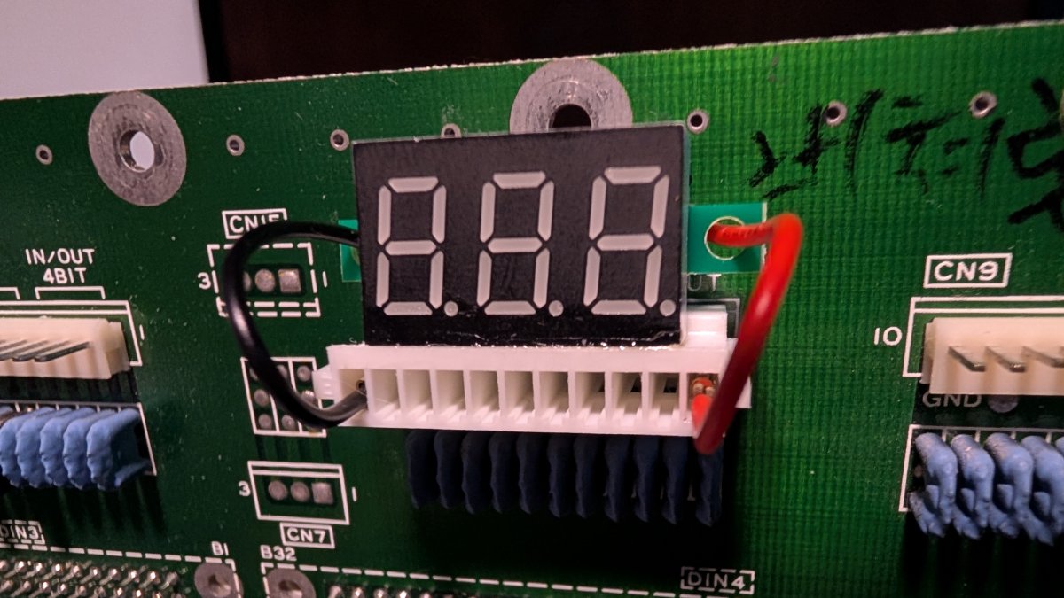

I never thought of using the +5v output for testing voltage, I always used the solder joins of the +5v inputs. So, I decided to make something fairly cheap and easy and the result is a cute little voltmeter!

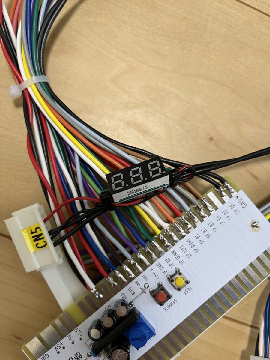

Nice!
My Model2A harness has a voltmeter on CN5 line.
(CN5 is mainly used to connect GND.)
