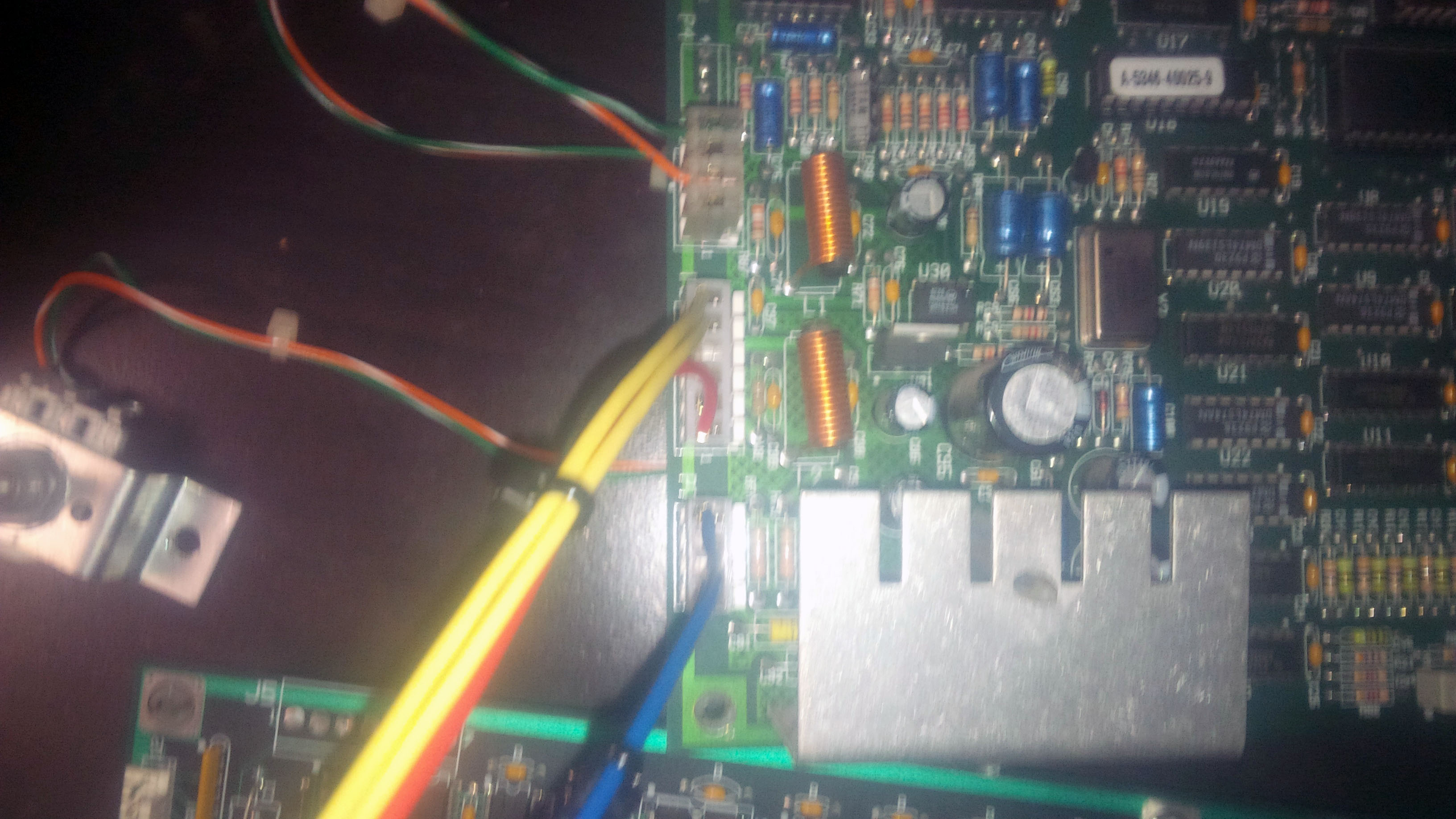

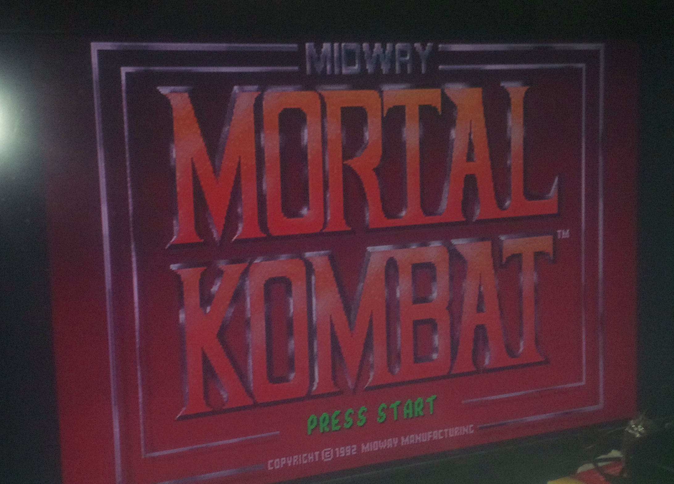

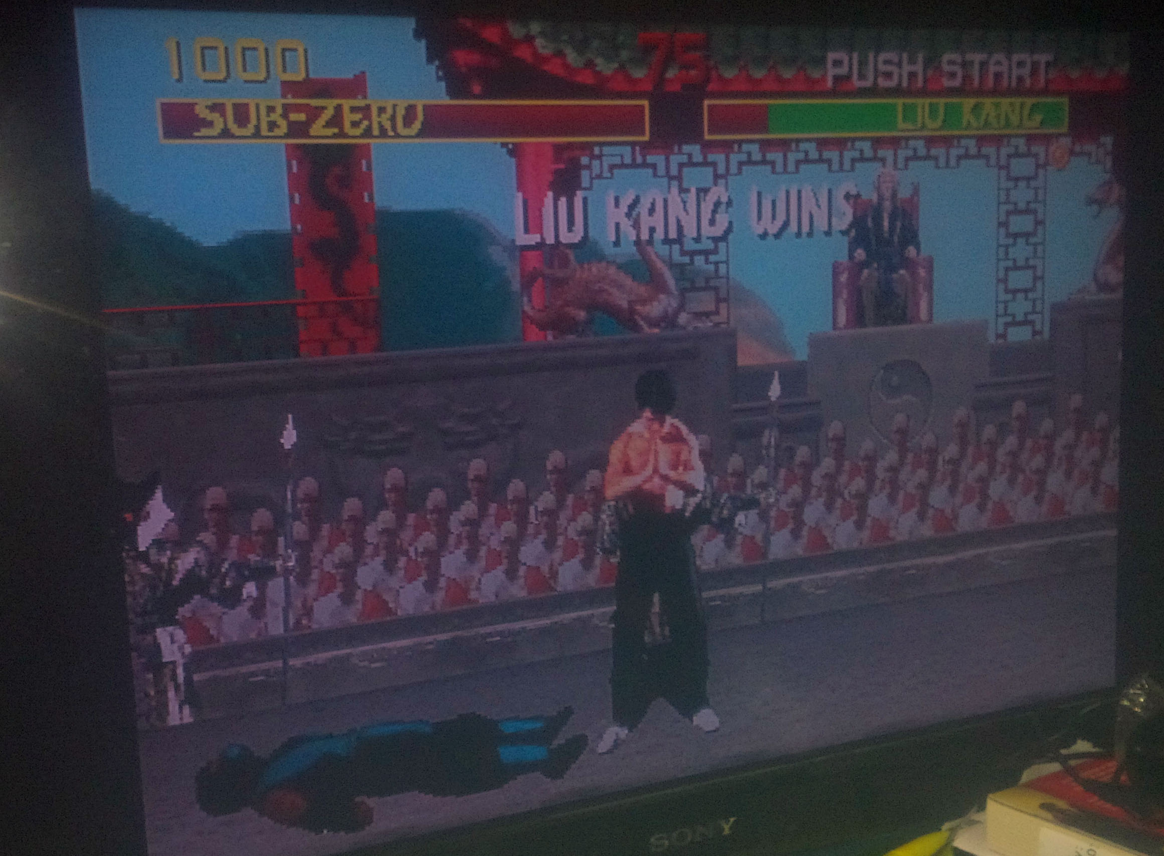

Pictures! Taken from my cell phone. Let me know if anyone needs to see anything specific. It is a Y-unit board. I tried turning up the voltage. I didn't check the continuity yet but the RAM chip doesn't seem to wiggle. Again, I haven't tested in the cabinet yet.
Working Graphics:
Sound Board Test:
LED Lights on Main Board: (When the board powers up for me LED1 stays lit up but LED2 flashes ... I'm not sure if that is supposed to happen).
Wiring Connects: (I tried to align the red stripe with pin #1 and #2 on both the sound board and main board, the sound pot came with the board)
Sound Board ROMS: (U2 and U3 are the two giving an error. I reseated U2. Nothing changed still no sound. Do the ROM/RAM chips need changing? Also I've heard that the crystal can give problems).

That doesn't look like the ribbon cable that came with it. Did you try connecting it so that the cable hangs off the edge of the pcb rather than into it? AKA line the red stripe to pin 26 on both?
From the pic you have one of the connectors on the ribbon cable reversed, flip one of those around and test again.
I will try that now...I flipped the wire so the red stripe was at the pin 26 on both. Static came back from the first time I tested before trying to align the red stripe to pin 1&2.
I tested again, same errors as previously U2/U3 and sound IRQ.
