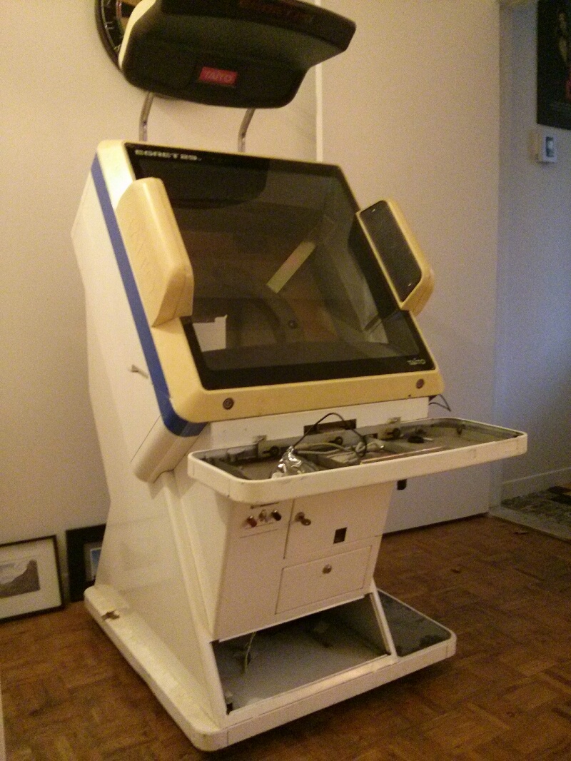

so I knew about that egret 29 in Montreal from way back in 2019 ... when a guy was trying to get rid of it for initially 5000$ but finally was sold for ..3000$. I had even called "dibs!" when he posted about the sale!
I posted about it in the old "for sale" thread and that's when the old seller msg me about the missing back door which he might have. To be confirmed in June when he comes back from abroad. finger crossed.
The "TV" and computer that were in it I didn't care about so when I put the game it the trailer, the "chassis" which I guess wasn't attached properly made a "crunch sound":

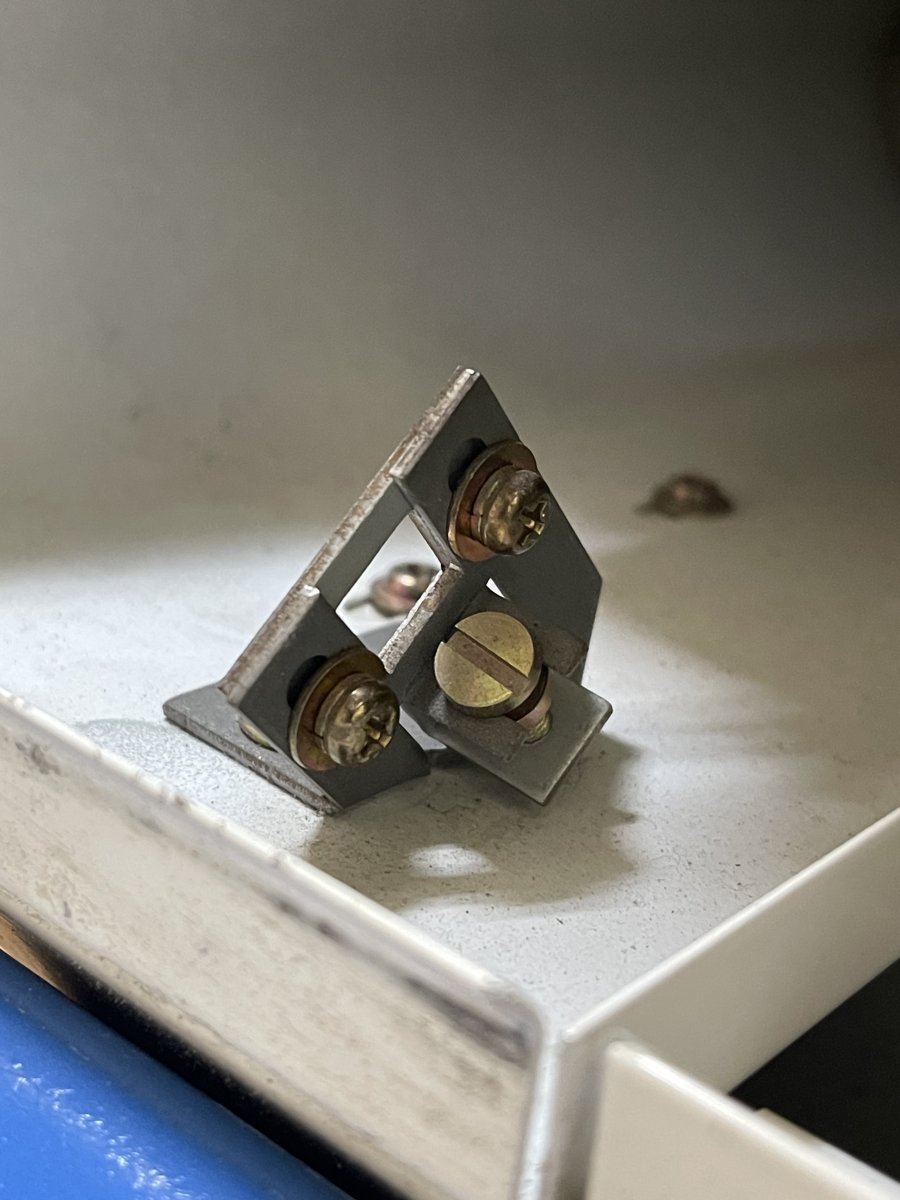

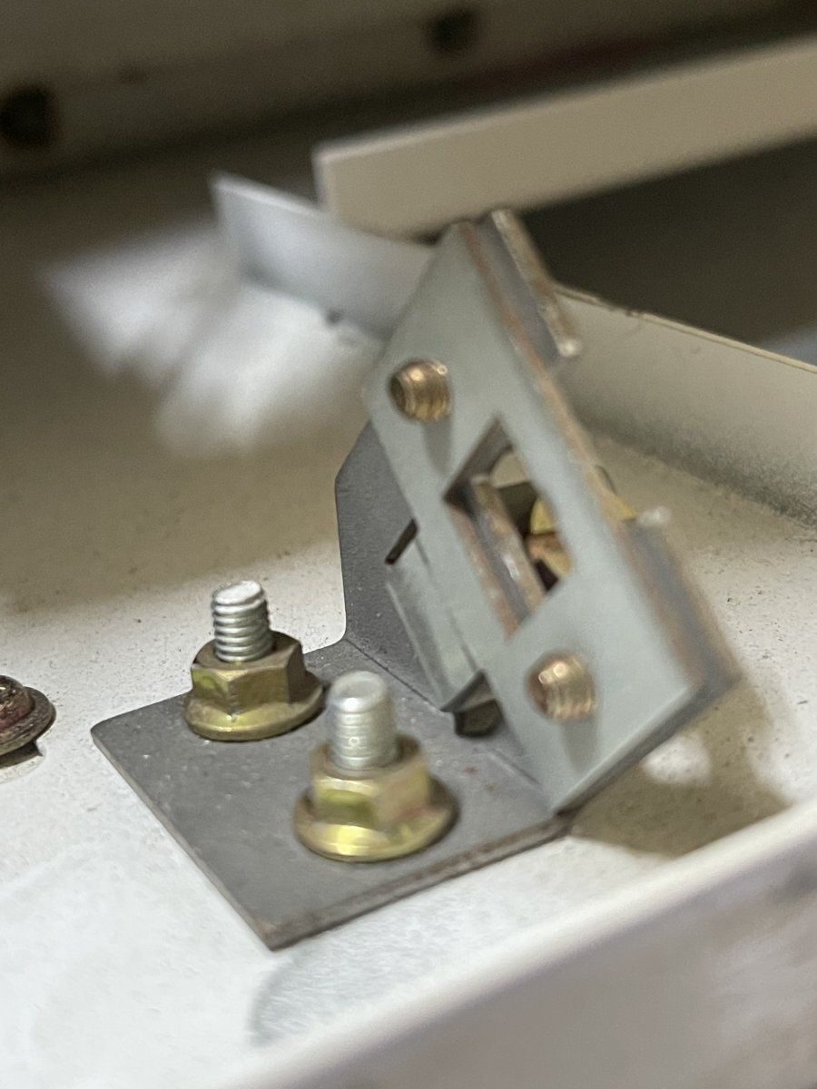

Question please: how is this lock supposed to work? Can i get pictures of the locks on the front bezel?!
the tang hooks into that hole in the middle of the 2 screws. Here's a Pic of the tang. It moves clockwise 90 degrees to engage with the loop on the base of the cab.
Look forward to seeing this restore thread all the way thru to completion!
edit : changed the pic cuz it was too blurry
Oh! Easy!! I can totally 3d print that! … if you do some measurements of that thang? 🤓pretty please with a cherry on top kind sir?

I was missing the monitor tangs on one of my cabs for a few years. I've never bothered to lock the monitor bezel because the weight of the thing holds it down secure on it's own, and unlocking it's just extra steps when you go to open it.

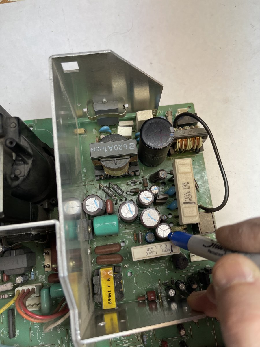

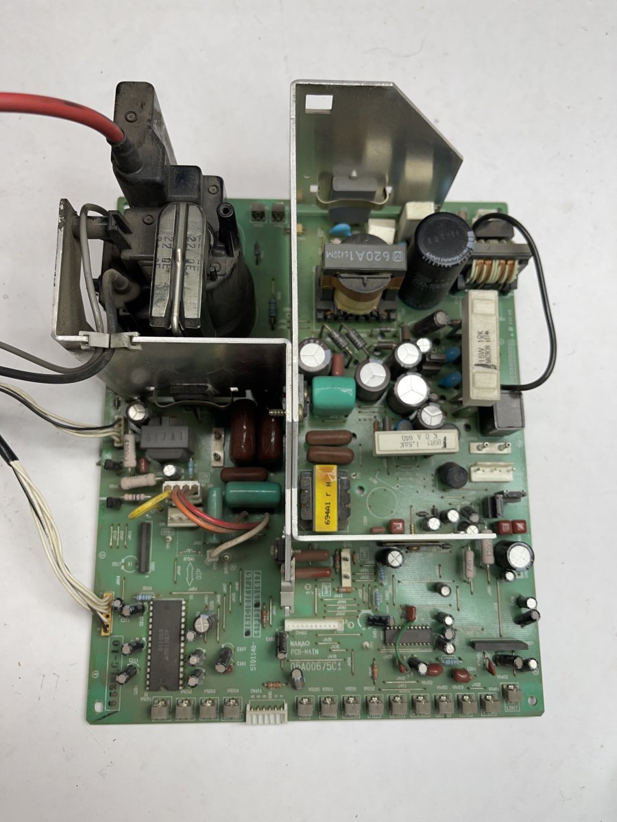

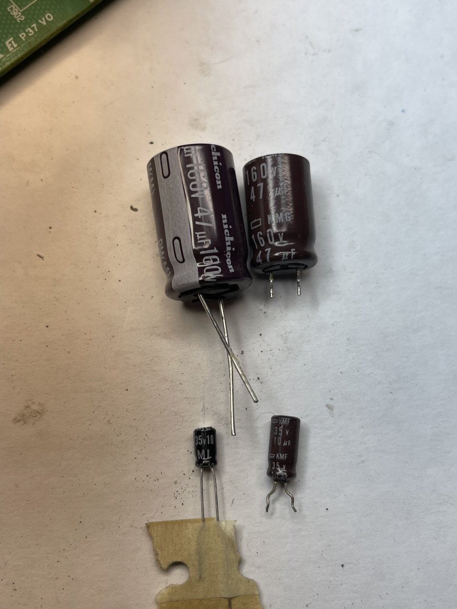

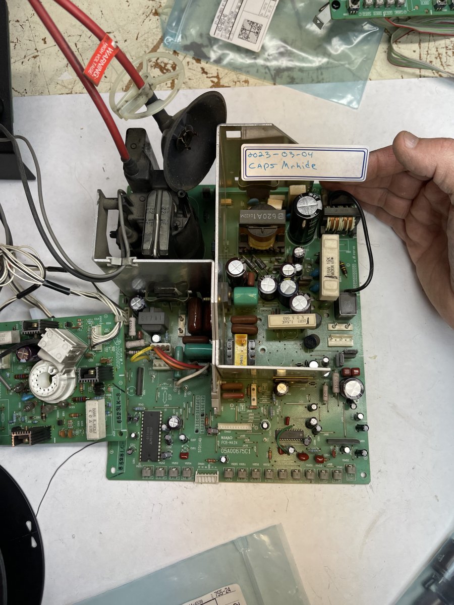

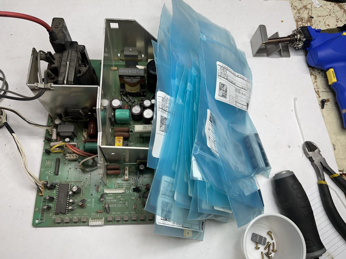

.My wife is stuck in New York until monday (instead of coming home today) because of “the fun of plane travels” so that left me with some unexpected time to work on the chassis today. I actually just wanted to plug everything and make it work. Then i thought, wait i have another chassis that is not working, perhaps it would be a good opportunity to try and fix it? So I dig up the box, lift the chassis… and find a full set of caps that i had forgotten! So instead of trying to fix that chassis, i recapped the working one :) Caps were even sorted by numbers! Heaven.
Before
With the ever so ecological cap bags
Don’t forget to mark the old ones before starting
Always an od one or two
Right is new. Left is old
And done
Putting that back in the cab and plugging it all back was an experience I do not want to repeat often. Not the easiest thing!
let’s hope it still works. Testing tomorrow.

lucky dog! u got an MS9 in there! according to arcade otaku, they came with ms8 inside. mine came with ms8 as well. for removing and installing the chassis ffrom the cab, i fount it easier to rotate the tube to tate so you can get at the anode cap easily. its 10x easier than going over the top from the front. everything else is kinda straightforward until you do the cable manangement. it is critical to keep all the wires together and in a position s oas not to get tangled on the neck when rotating.

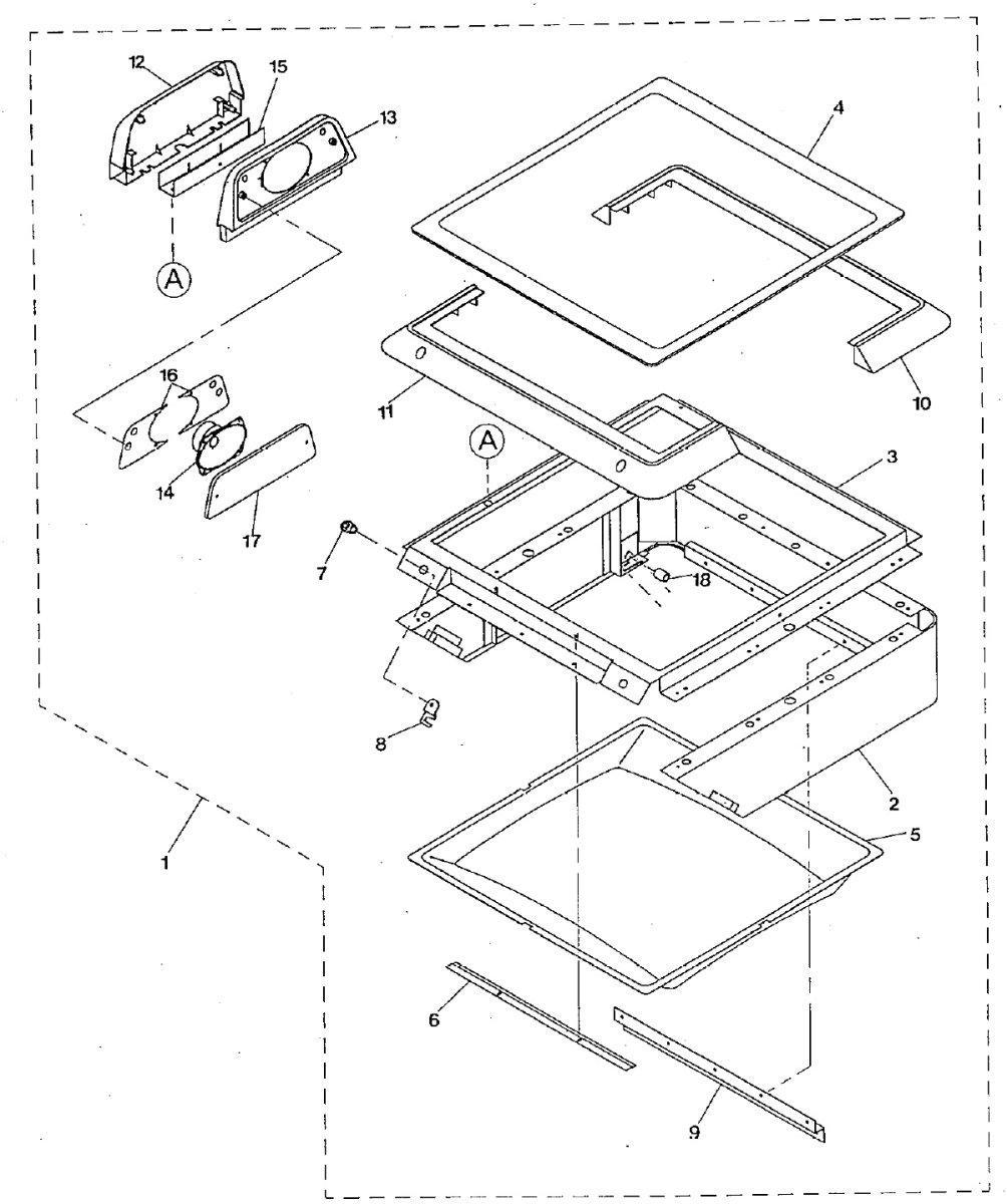

and talking about pictures: I see that my broken part is not all around but 2 pieces (10 & 11) , where the joint is hidden under the speakers. Nice design Taito!!
( I also see the #8 part ... should have thought about looking at the manual before asking!)

and talking about pictures: I see that my broken part is not all around but 2 pieces, where the joint is hidden under the speakers. Nice design Taito!!
still good to ask. theres some details the parts list doesnt explain clearly. it is not perfect.
