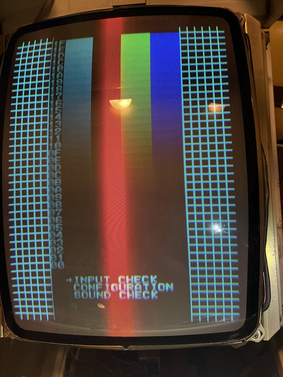

This is the best I could get it looking, if I turned up the brightness the red would be scattered more than just horizontally.

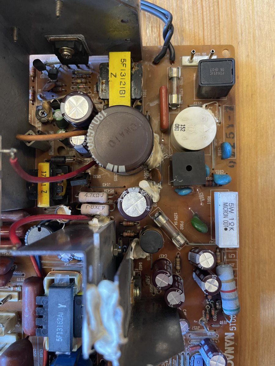

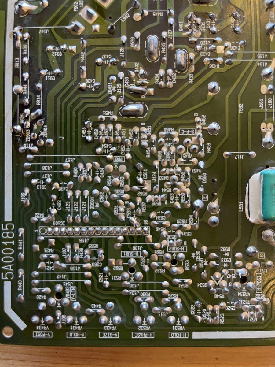

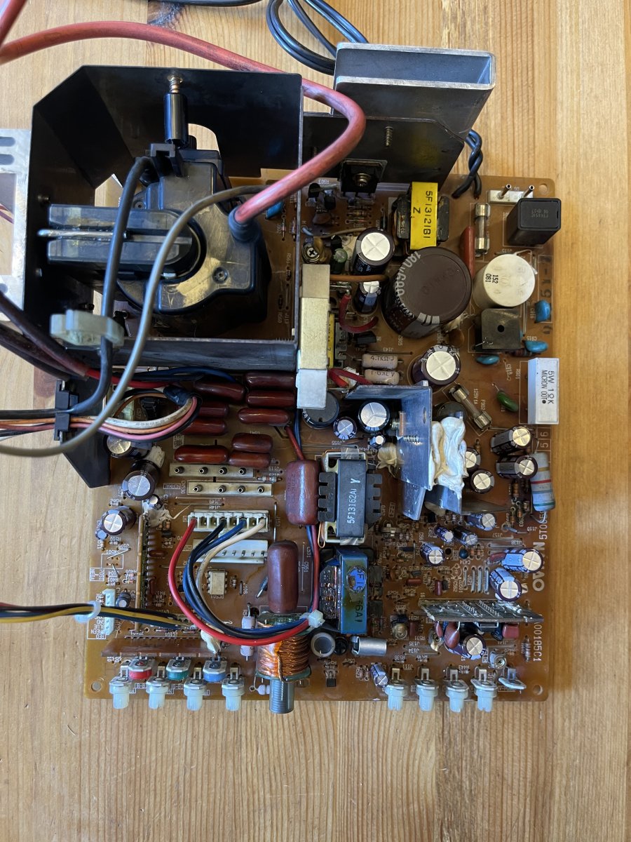

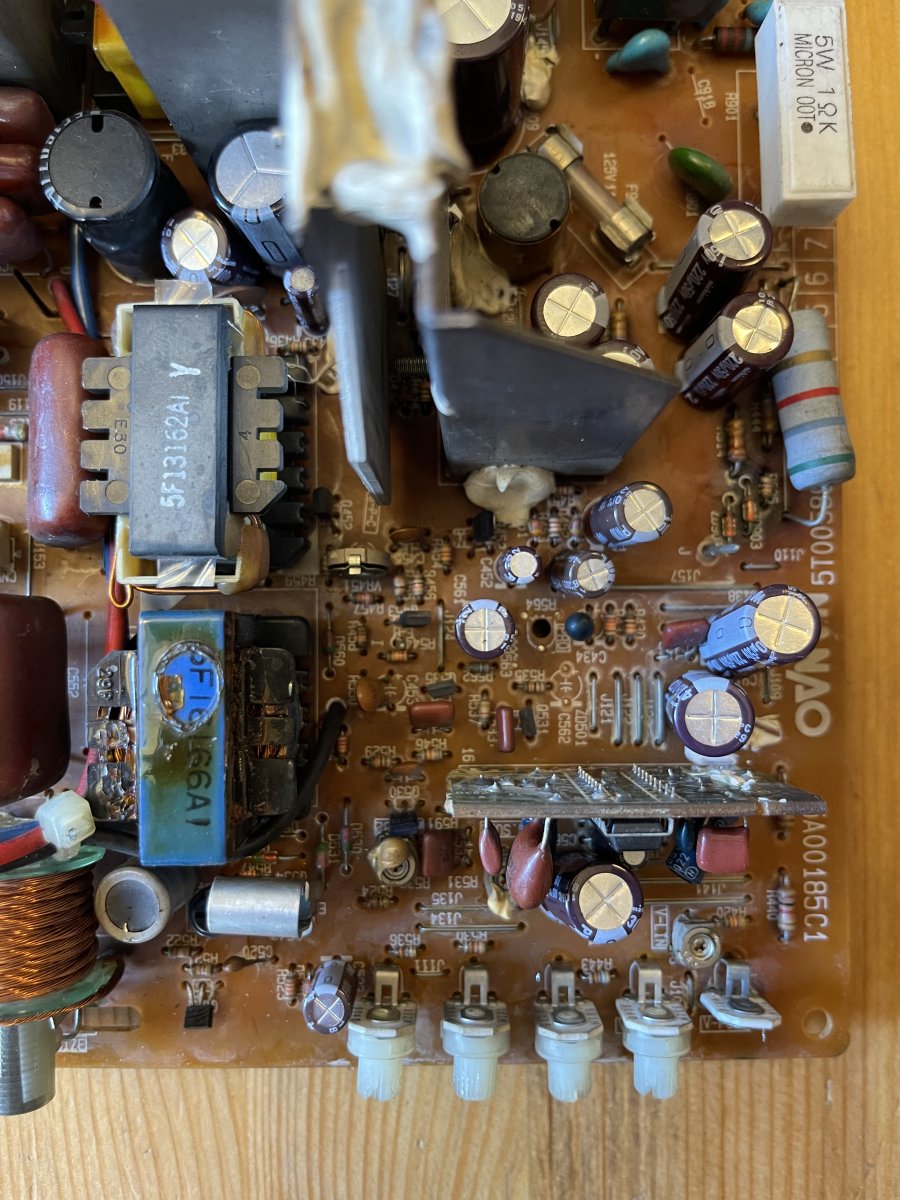

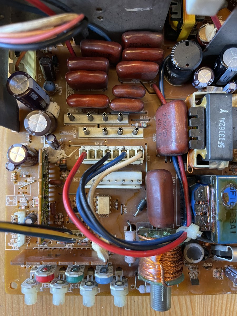

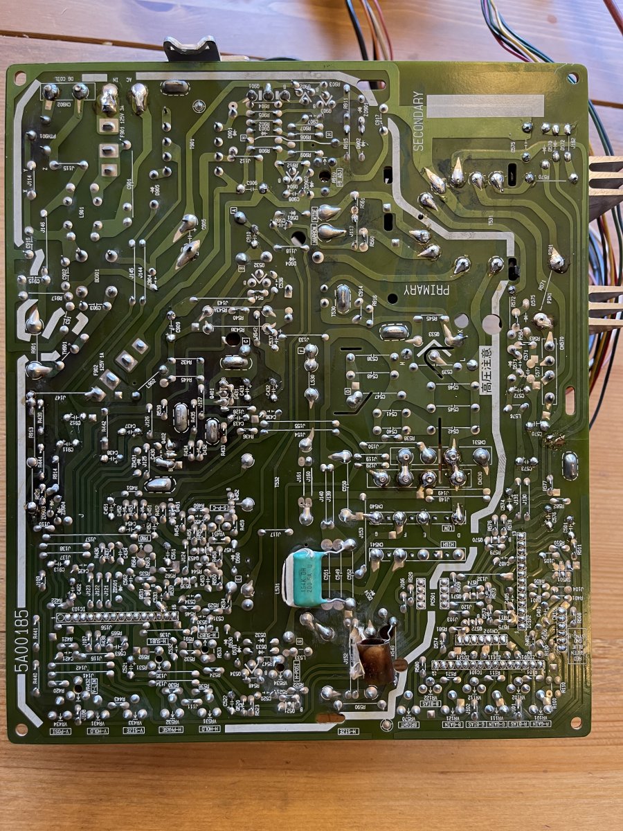

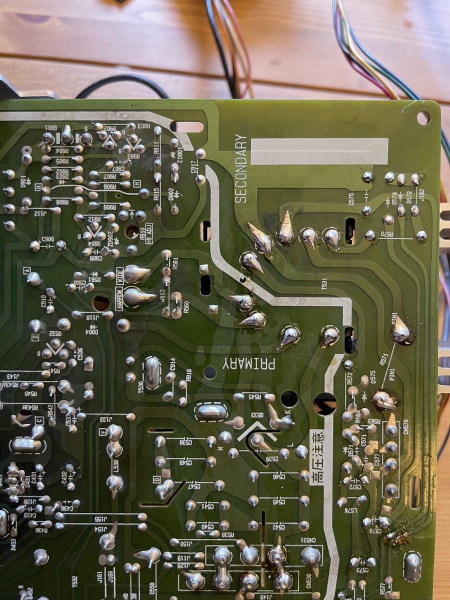

Can you take some pics? Both component side and solder side of the chassis.
26A has some differences compared to 26SG, and a lot of differences compared to 26SE and 26SU. I wouldn't trust a cap kit with this chassis.

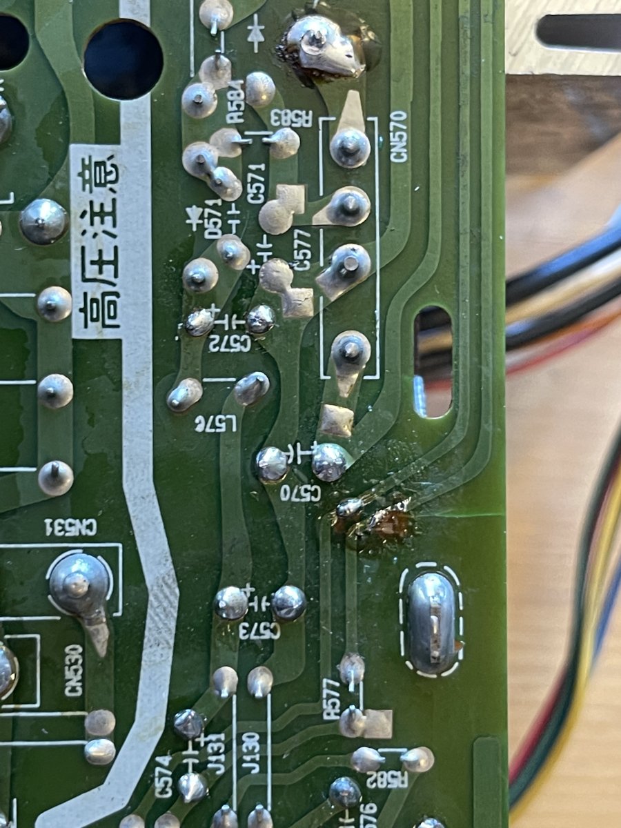

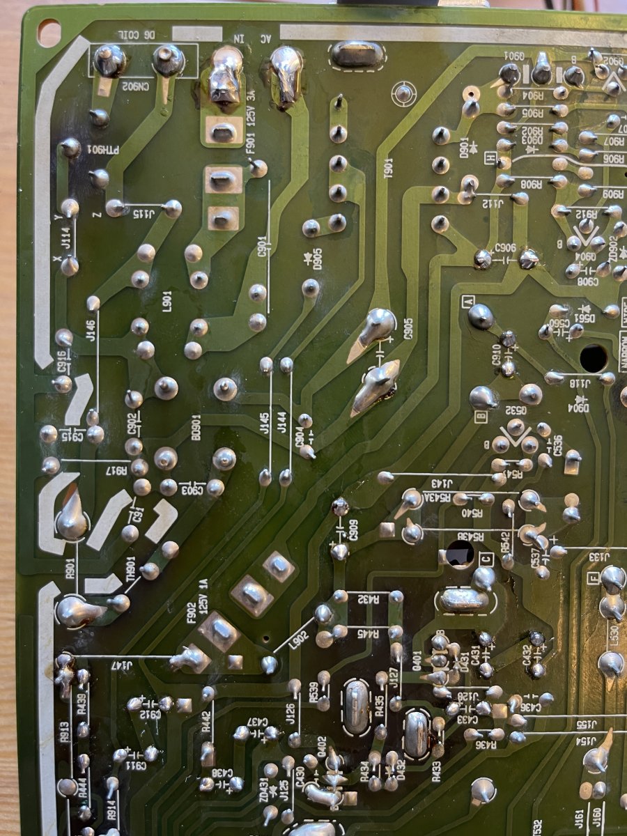

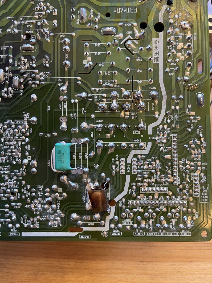

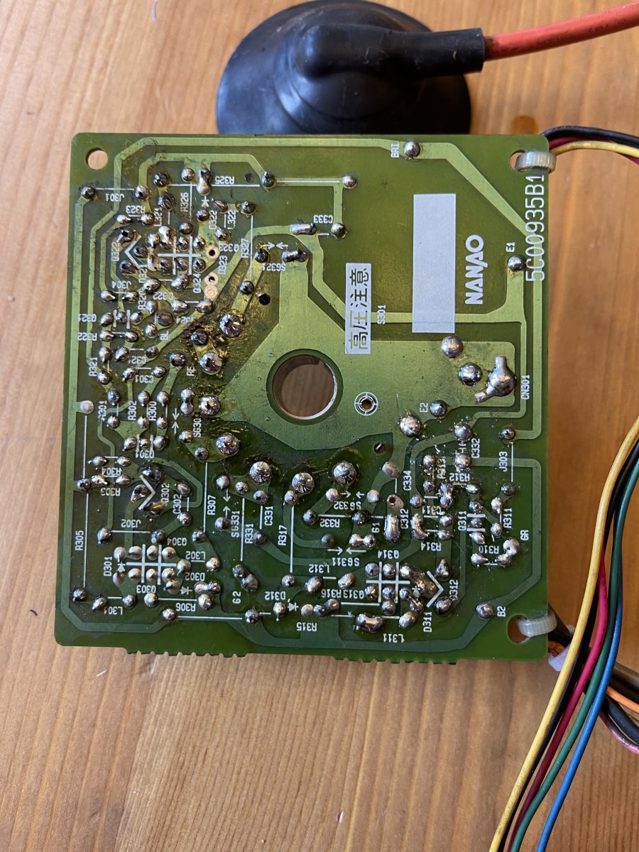

The last photo (ended up in the next comment) shows where the board cracked a little when I put it back into the plastic frame. I scraped the coating up and globbed some solder on, it’s got continuity across the traces (where they should be that is) but it’s definitely an area of concern.
Yes, that side of the board breaks often.

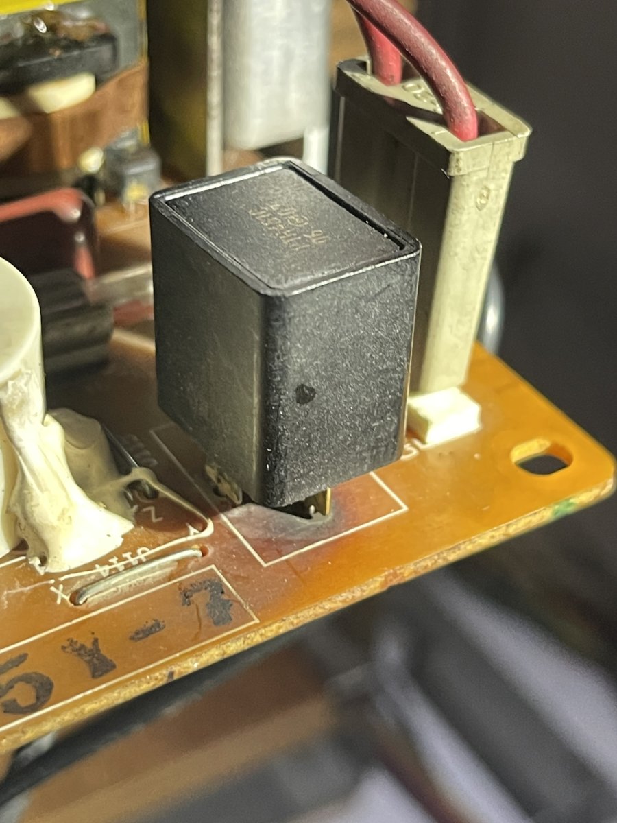

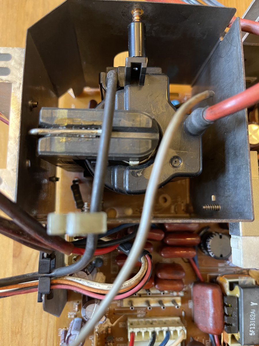

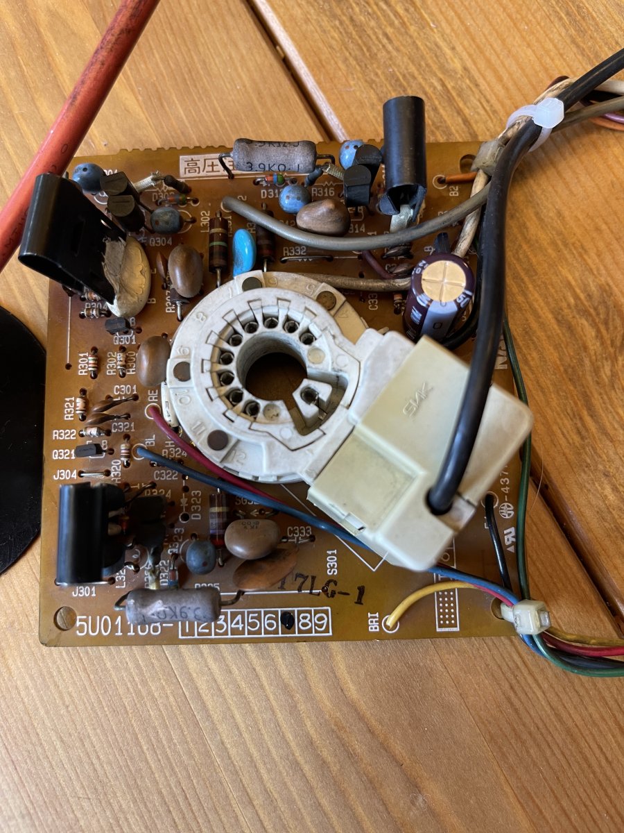

Your soldering looks OK and your board is clean. Unfortunately, nothing really jumps at me -- apart from the vertical position pot. It's missing the cover, but it's not damaged otherwise, is it? One side of that is ground.
Also, C560 and C908 haven't been replaced (above the filter cap). C560 is a 0.47uF 160V which is known to go bad. Sega replaced it with a ceramic capacitor on 26SU. However, I doubt it's your issue.

Swapped out the HOT and the C3306, still no dice. There was a light burning component smell when I turned it on, which is certainly disconcerting. I might be suspecting the thermistor, it was the only thing that was getting warm at all but my understanding is that is not unexpected given it’s function. But it looks a little burnt on the board underneath it.
Is the degaussing coil header polarized or can it go either way? I may have had it the wrong way if it is polarized.
The vertical position cap keeps falling off, not sure what to do other than maybe glue it but that feels like a bad idea. It was working when the monitor was last powering on.

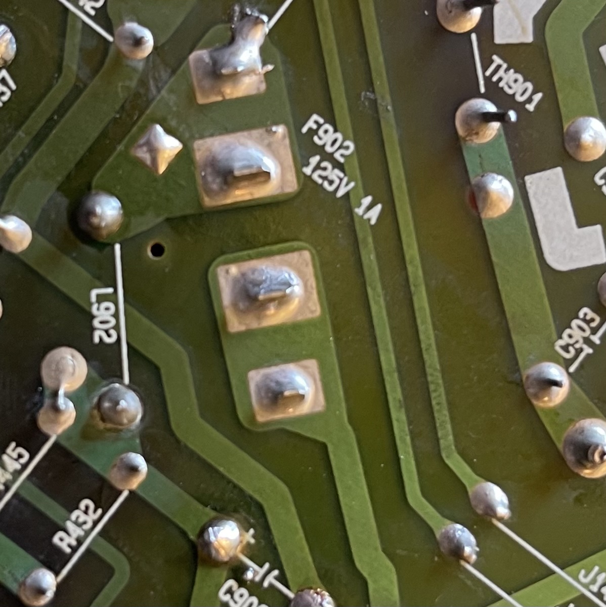

See if you have B+ voltage? You can measure it from the F902 fuse. Black meter to ground. Flip the board over before measuring to look for a nice ground spot. I use J144 which is a jumper to the right of the fuse, but looks like yours might be under some glue.
I’ll check that now.
In addition to the new HOT I did order a replacement filter cap so if there’s no B+ voltage I will replace that as well I guess.
B+ voltage started around 111v and slowly climbed to 125.5v BUT when I turned it back on to double check I was getting a reading of only a few volts.
Swapped out the filter cap and it’s still only reading a few volts at F902. Is there anything that would explain why I saw the higher reading when I first measured then it dropping on the second? I suppose a part dying might explain that…
