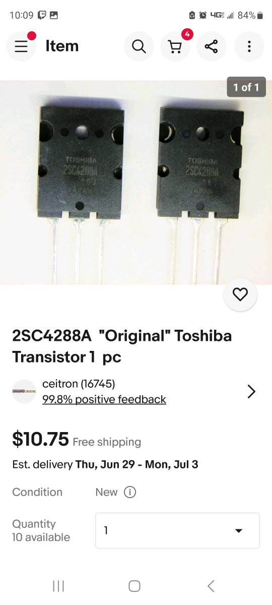

After reading alot about this chassis and performed reflow of neckboard and chassis and capkit, checked both fuses and both look good. With my no power up, no clicking,neck glow I came to conclusion that it my be my HOT Q533.
after looking it up I came up to this:
Now, the on on the chassis say 3J
This one on ebay has 5J does that matter? Please let me know. Thank you.
For sure you have one little transistor shorter, there are 3 all on primary psu section, test them all

Tested the HOT and that came out good. Oh well atleast I have 2 for back up now thatI ordered them.
I figured it could be something with psu side. I mean I get nothing, no sound no glow, nothing. The only thing I get is sound from the mistercade when game comes on.
Tested Q902,Q903,Q904 out of the pcb... it's looked good none of them are shorted. Also tested VR transistor, HOT, and the other one whatever it is and all good.
