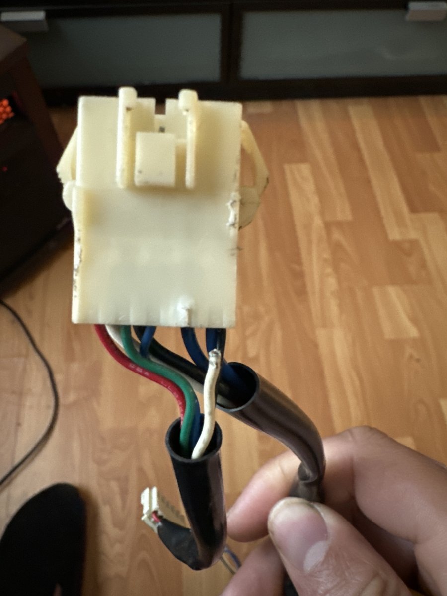

Samurai_j Student Joined Nov 12, 2023 Messages 44 Reaction score 38 Location Bay Area Jan 12, 2025 #1 Can anyone direct me to the correct male pin size for the ms9 amp up connector please? Would much appreciate it. Thank you Attachments image.jpg 114 KB · Views: 40 image.jpg 116.7 KB · Views: 41

themisterfalcon Grand Master Joined Dec 13, 2018 Messages 347 Reaction score 1,025 Location Michigan Jan 12, 2025 #2 The pins for the connector you are showing are: TE Connectivity / AMP 175149-2 The corresponding male connector is: TE Connectivity / AMP 176279-1
