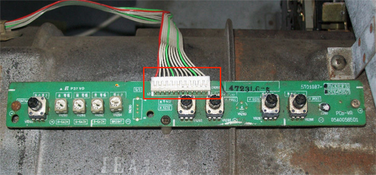

I've been trying to find the connector that works with the MS9-29 remote board.
Scoured the usual sources, AO wiki, and here, but can't find that part identified anywhere. I imagine it's a JST connector of some kind but does anyone know what it is? And even better, a digikey or mouser part number?

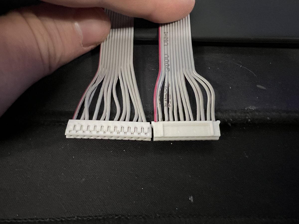

On one end it's JST PH and on the other end it's JST EH (both 12 pin). The one circled in red is JST EH, the one that connects to the chassis is PH
Remote board - https://www.digikey.com/en/products/detail/jst-sales-america-inc/EHR-12/527234
Chassis - https://www.newark.com/jst-japan-so...-12/wire-board-connector-socket-12/dp/26H1947
Looks like most places are sold out of EHR-12, which is what you need for the remote board. PM me and I can send you one and the contacts, or make an entire new remote board cable if you need one.

Just curious but if you're simply making a harness, why do you need the pinouts? You have the connectors so it's just A to B, or am I not considering something?
I did some research and it seems that the harness is sequential, I was worried some crossed over.
I’m pretty sure pin 1 on the remote board connector goes to pin 12 on the chassis connector, pin 2 goes to pin 11, etc.
