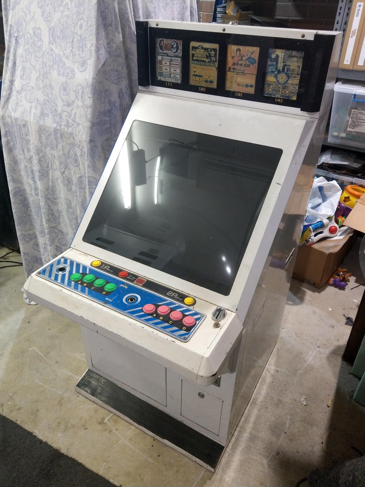

So, this is what I am starting with:

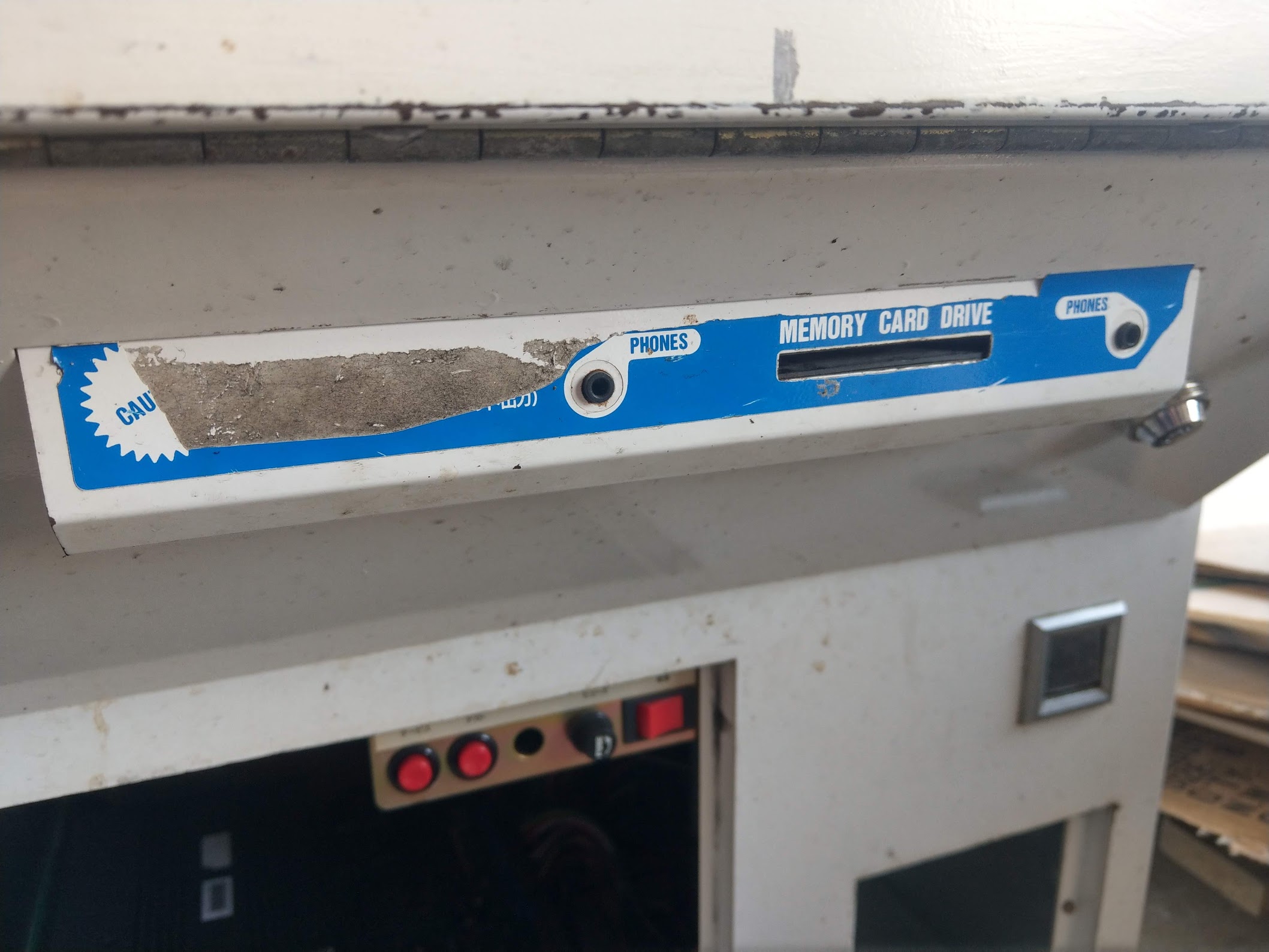

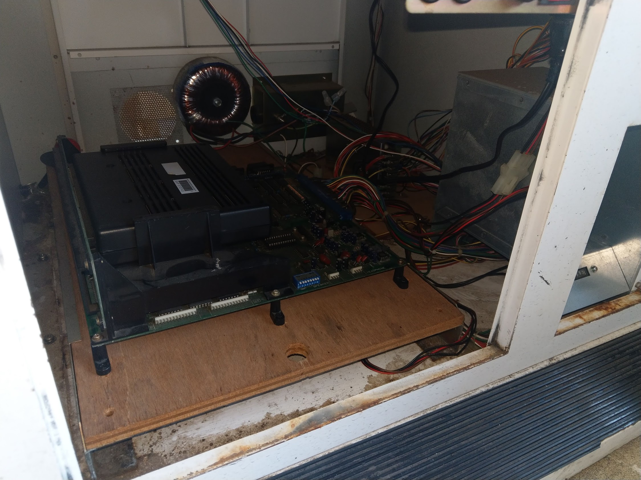

Upon receiving it I didn't have the keys so wasn't able to turn it on but was told it was all working. Now I thought I recalled the seller telling me it had a 4 slot board in it too but unfortunately that was not to be... :/ So I got around to drilling the locks the weekend just past and found that it just had a single slot PCB with Metal Slug 4 in it. (See pics)
Also, as I am in Australia it had already been converted to run on 240V so as expected there was a step down transformer in there (big circular thing mounted to the bottom back of the cabinet).
Anyway, since I had the front door off I was able to turn it on and thankfully it all fired up ok. Image seemed to have a minor focus issue, so hopefully that is just a minor adjustment on the chassis I need to make later...
Due to the state of the control panel I obviously couldn't play but could confirm the buttons worked.
Anyway see attached pics to give you an idea of the state the cab is in...

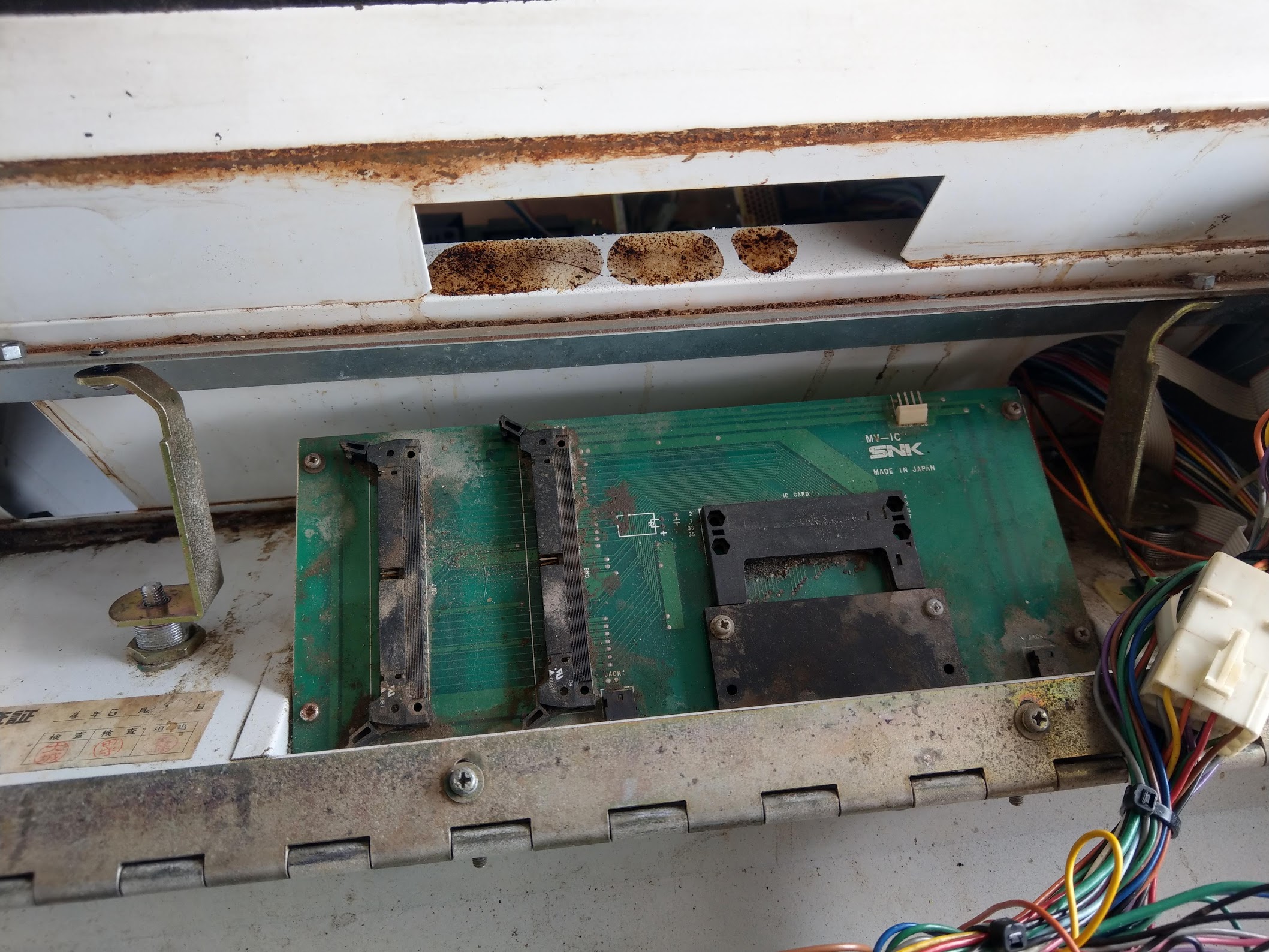

Decided to pull and give the old memory card/headphone jack board a bit of a clean... it needed it!!!!
Just soaked it in Simple Green then rinsed it off under the tap. Blew off the excess water and left it in the sun to bake for the afternoon. A lot better now :)
Before and after:
