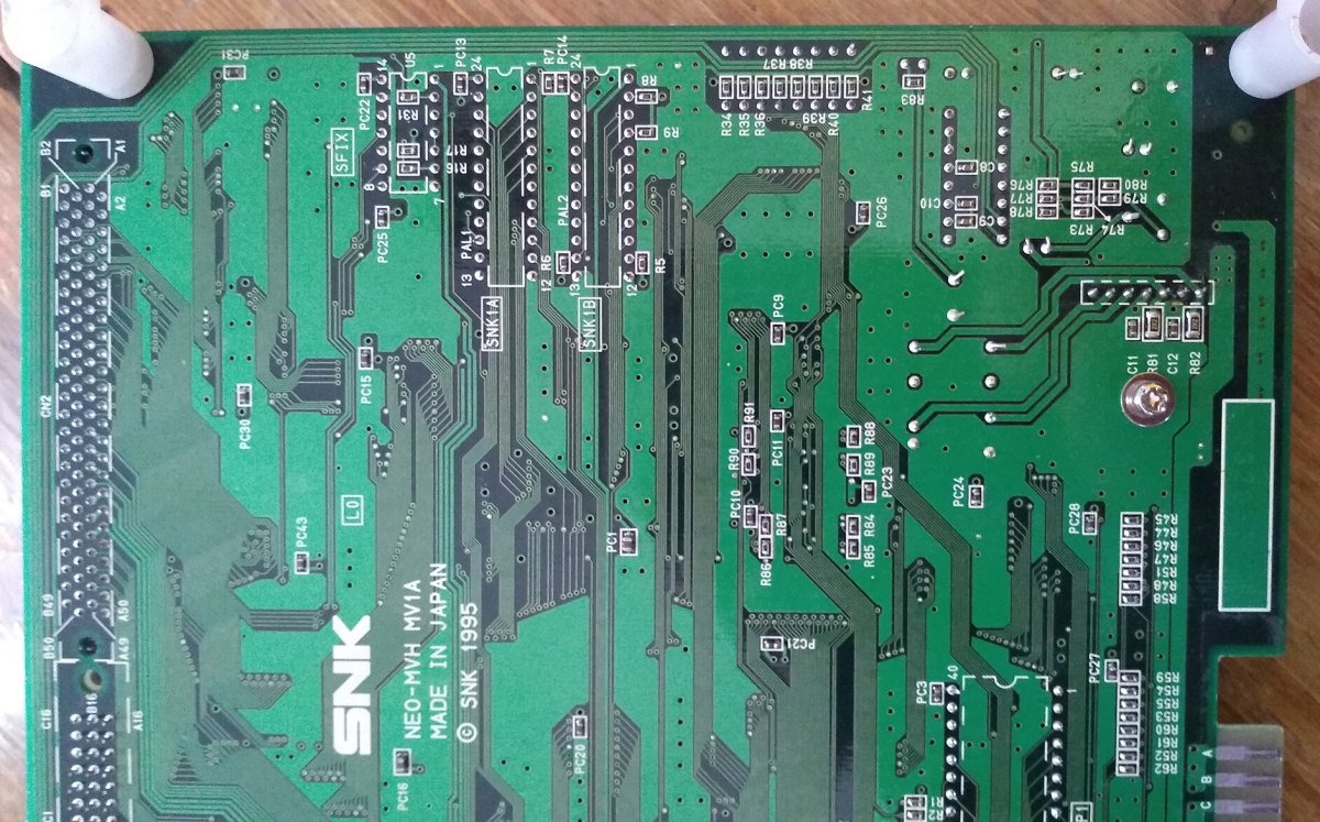

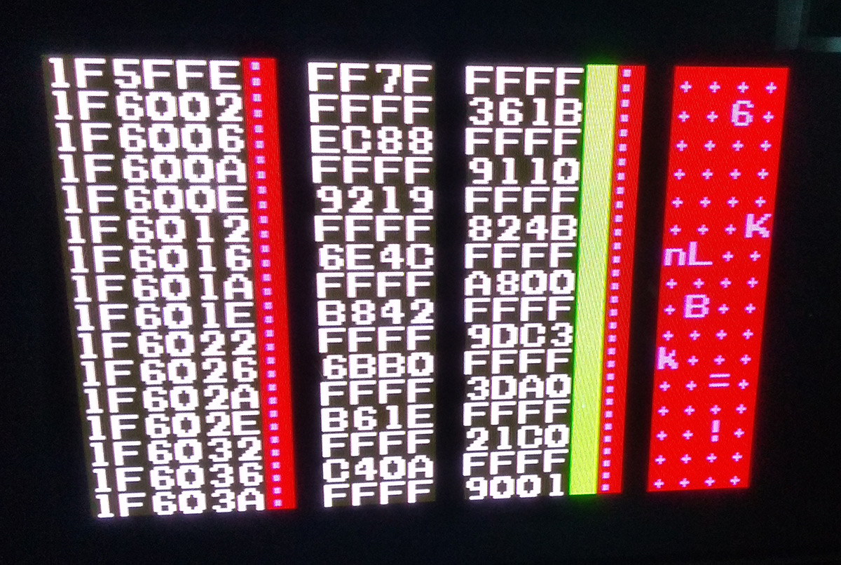

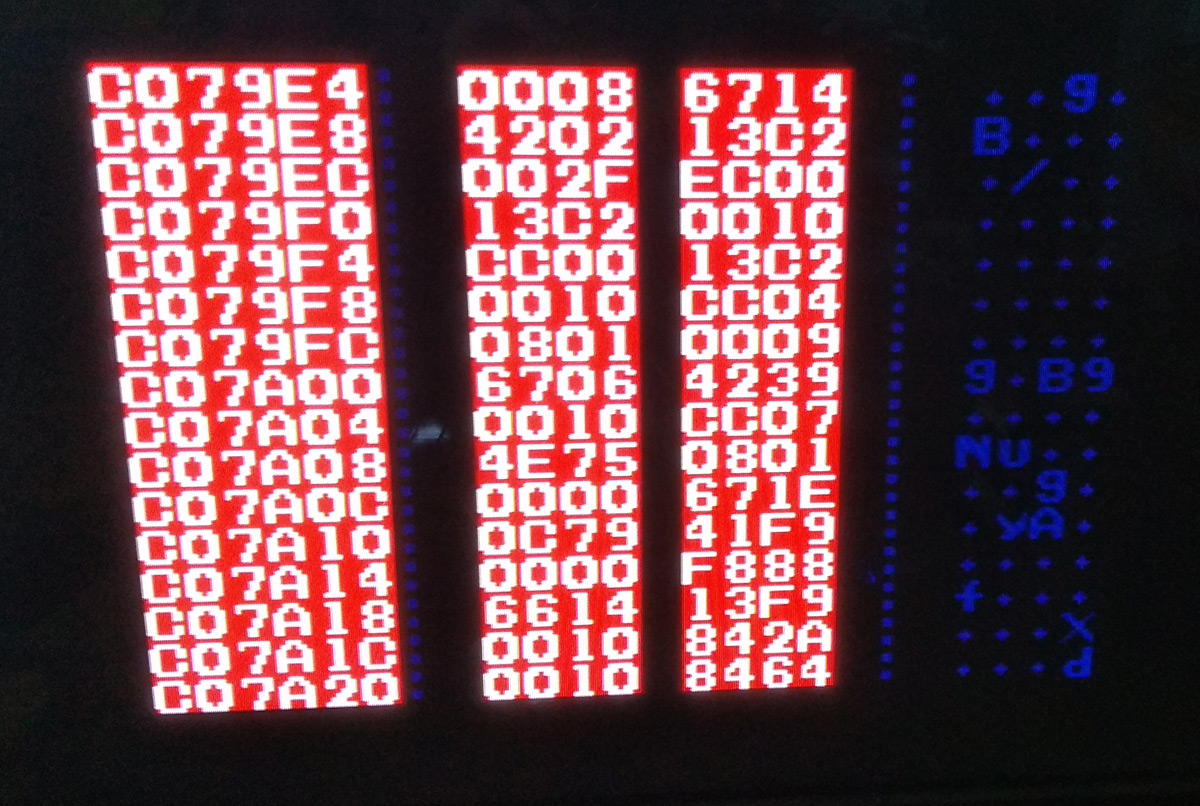

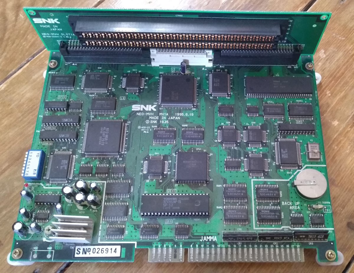

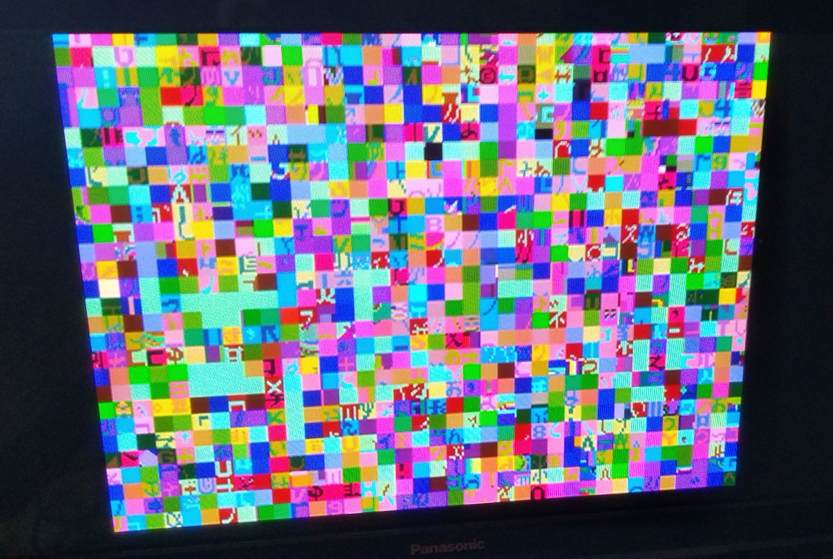

MV-1A Issues – Salvageable?
i get sent shit like this!!!!

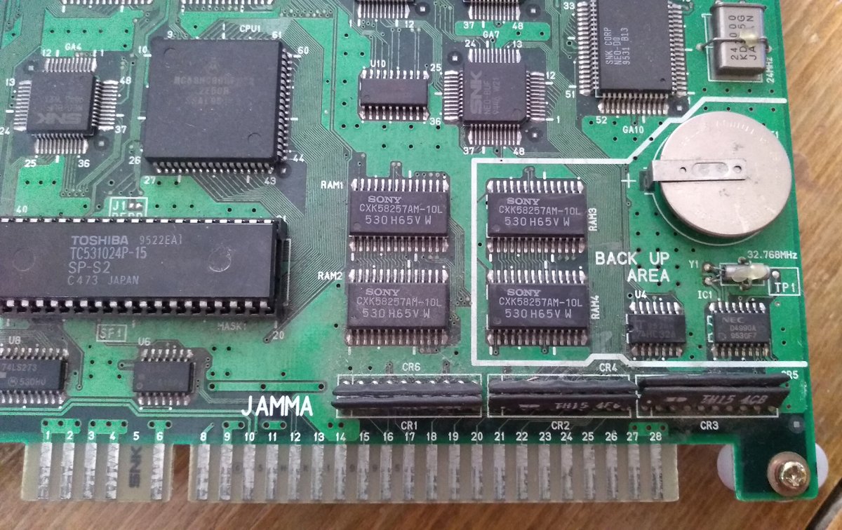

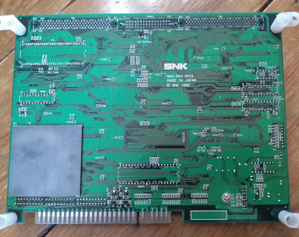

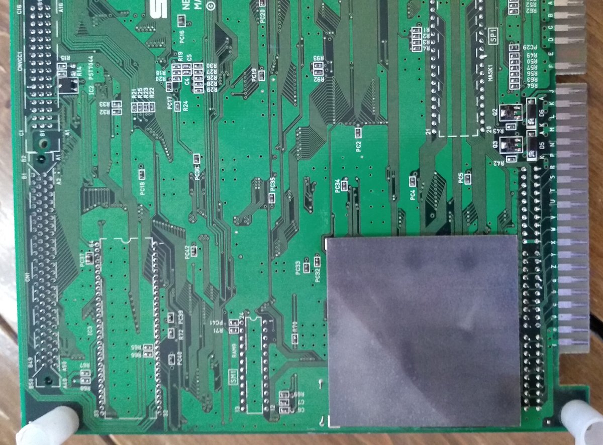

i hate those boards,
i always rub the skin off my fingers trying to get that foam pad off the bottom of the battery area!! :(
If you can stand the stench, heat them up with hot air. Much easier. But again, the smell is horrible. Foul. Extremely unpleasant.
Also, relatable.

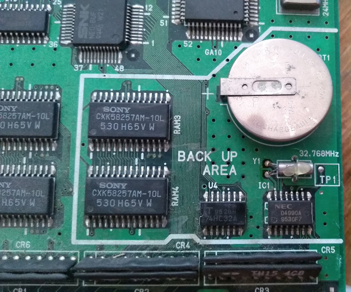

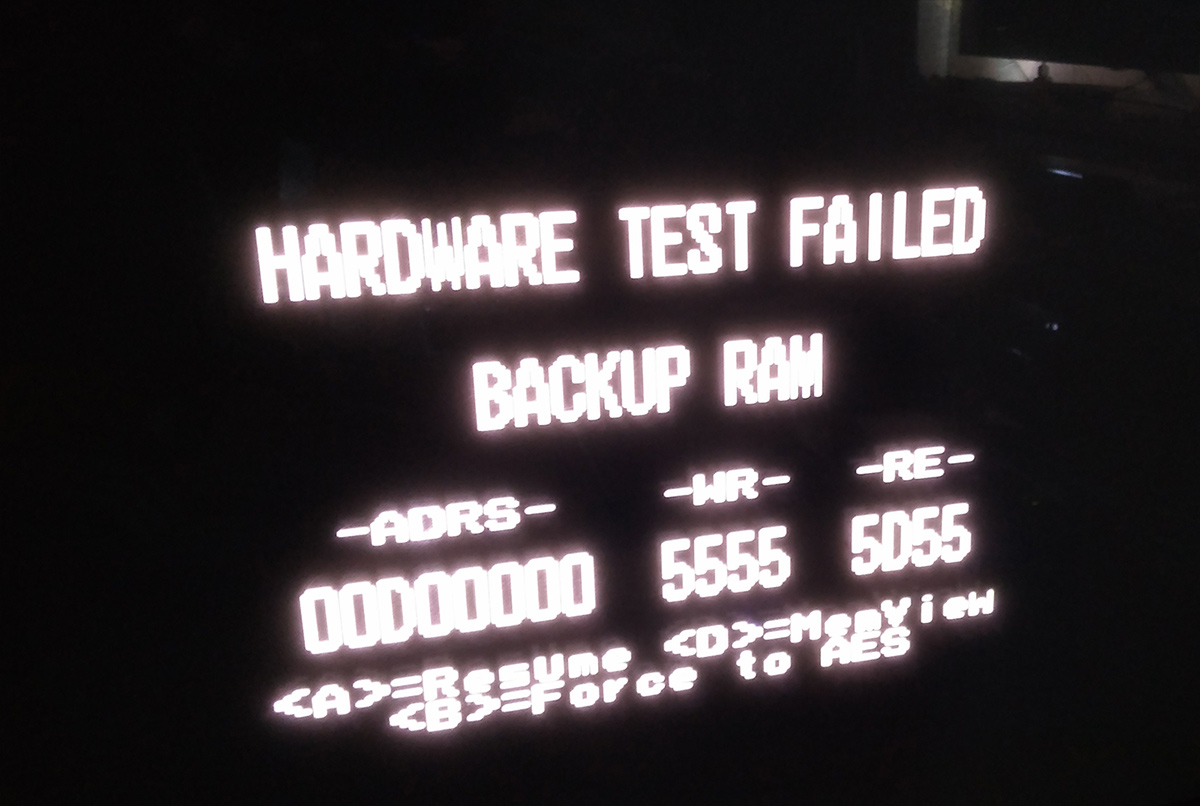

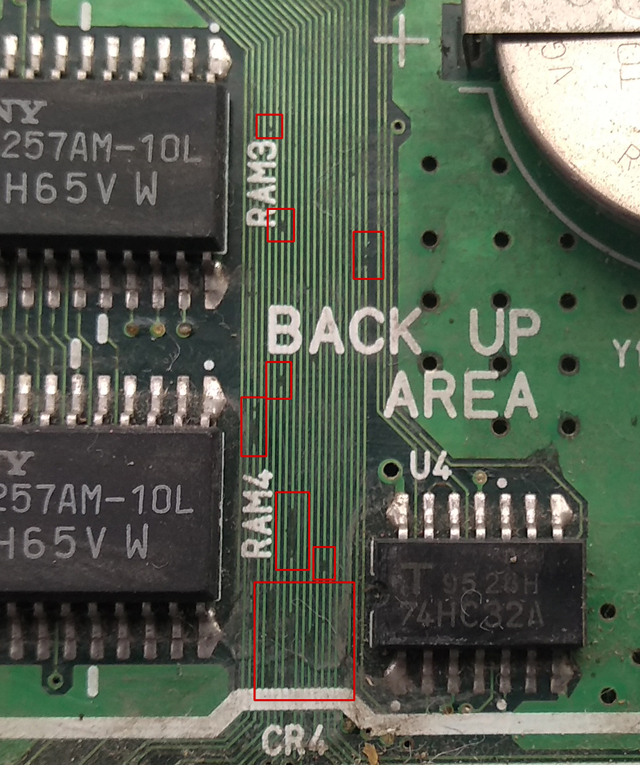

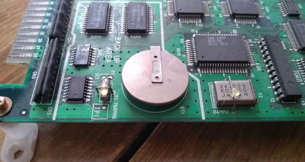

My 2 cents on the repair: the 74HC32 in the battery area is a Toshiba part -- the Fujitsu of SMDs -- and it's likely it's dead(ish). When it fails it causes backup RAM access errors as it is used to select the chips for access.
