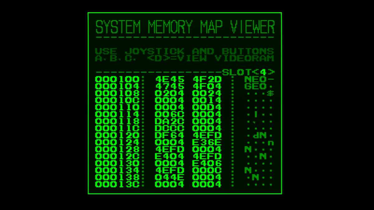

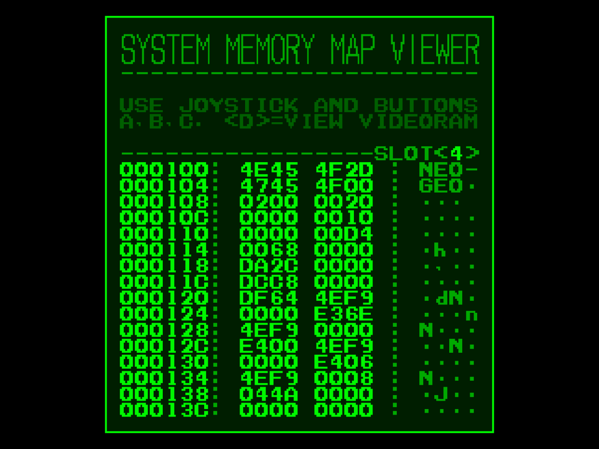

I have a MV4 that the top board only works on slot 1, the other slots all go to crosshatch. If I try to access the UniBIOS memory viewer on slots 2 and 3, I get a black screen, but on slot 4 I can see memory fine. What I noticed is that past "NEO-GEO" at address 100, the lower byte of each word has D2 stuck high: 00 becomes 04, F9 becomes FD, etc. I can use a working top board on this MV4 and all slots work no problem, so it's the top board for sure. It's possible this issue is also present on slots 2 and 3, but I can't see the memory viewer to confirm. The first picture attached is of MAME, the second is the board.
The M1 test passes fine in all 4 slots and I gave all the slots a good clean with same results. I did try replacing the LS245 at R4 because that's what D2 goes to, but it did not seem to make a difference.
Any ideas?

You are mostly there finding the issue. As you have identified in the pics D2 is stuck high on slots 2/3 and probably 4.
The 16 data lines from the program rom for each slot go to the 2x245s to the left of each slots (slot4 is R3&R4, slot3 is L3&L4, etc). They go in pins 2-9 and come out pins 11-18. The indivdual output pins are all tied together across each slots 2x245s (ie you should continuity between each of the pin 11s for the 245s at R3/L3/G3/C3). The outputs all end up on CN10.
The flow of the traces connecting the outputs is slot4's 245s -> slot3's 245s -> slot2's 245s -> slot1's 245s -> CN10
With D2 being stuck high starting at slot2, its pointing to a cut trace between slot1's and slot2's 245s. Which ever one is carrying D2.
