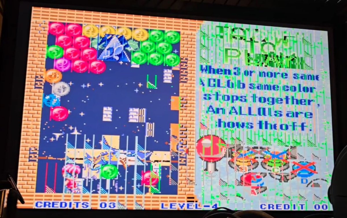

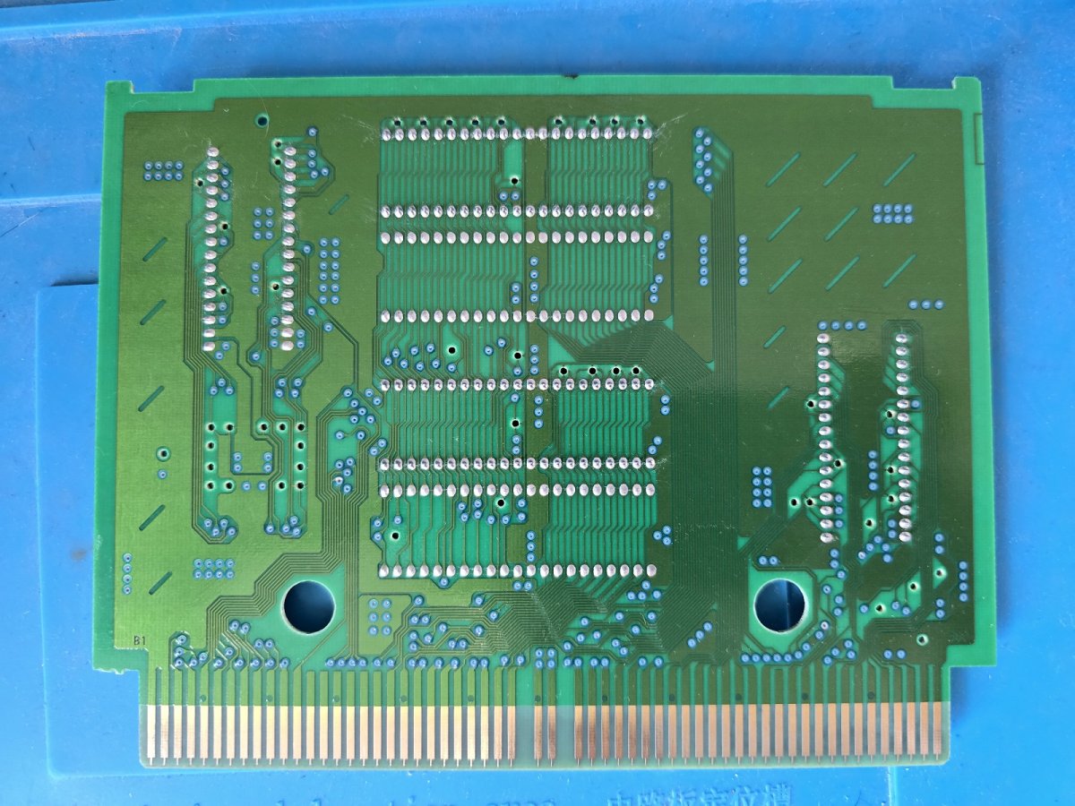

Hey All. Picked this cart up on ebay fairly cheap (20-ish bucks, sorry If i bidded against ya!). Was hoping it would be an easy trace fix but I've gone over each pin with a multimeter and they all go to some place (chip/rom/via that goes to a chip). The board looks clean. No rust, no corrosion, no broken solder joint or traces (3x magnifier) that i can see. so I have to assume it's a chip issue? Which chip would be the most likely culprit, or do i need to remove them both/all and check them? (Only pictured char board as I figured it wasn't a program issue). You can see the teeth are very clean and I tried this in 3 different slots and the same result every time.
Also I'm no pro on the chip numbers, what size mb wise would be needed to replace these? I have a few roms on hand for repro snes/genesis personal carts I was going to make and would be awesome if they were just a drop in replacement (vs an adapter board and smaller chip)

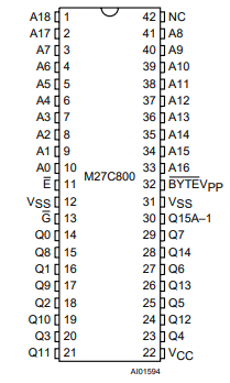

check the rom file size.....
27c800
Since I've never made a NEO convert/repro cart. is this a case of 'if it fits it ships' kind of thing? i.e. if the pins match and the size is big enough the chips on the cartridge aren't expecting any specific size? and I'll assume if I only have double that size I could just double up the data on the rom like I would do on a nes/snes cart?

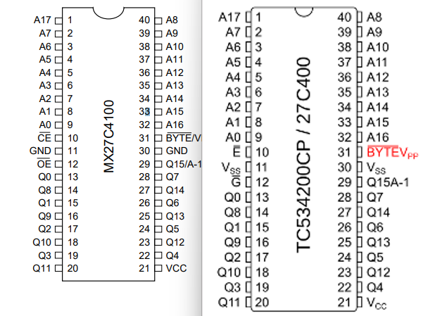

I want to convert my Puzzle de Pon to R. Would an M27C4001 be a suitable replacement for the 512Kb P1 rom?
27c4001 dip 32 NO!
27c4002 dip 40 YES
27c4100 dip 40 YES

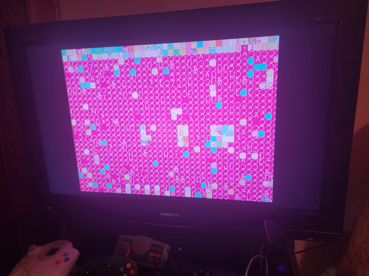

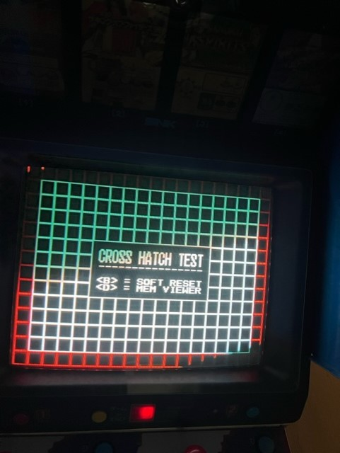

I programmed a 27c4002 with the PDP-R P1 and replaced the S1 chip as well and I got a jumbled, mostly pink screen. I programmed another 27c4002 and got the same result. I thought that maybe one of the PCBs was damaged so I desoldered the new chips and soldered the old P1 and S1 chips back in and it works fine. I did a verify and compare on both 27c4002 and they were ok.
I have a 27C400 as P1, although my board is a PROG 4096.
P1 problem = no game boot, only this screen
What you mean with "mostly pink screen" ?
Take a pic,
What you use for S1 ? its not a 27c1001 but 1000

27c4100 is compatible for P slot

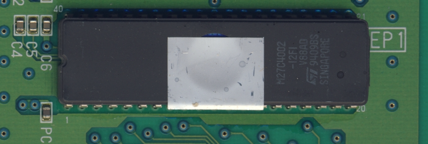

Dude, 27c4002 is suitable for EP rom not P-Slot
Take a pic,
1738508023064-png.181393
I used a 1000 for for S1. I'll have to order a 27c4100 as I don't have any on hand and the 42g-1 doesn't have an EP slot.
if you have a 27c800 you can try to double p1 inside or put on GND last address pin.
