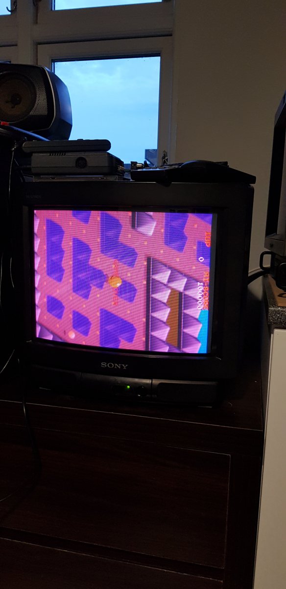

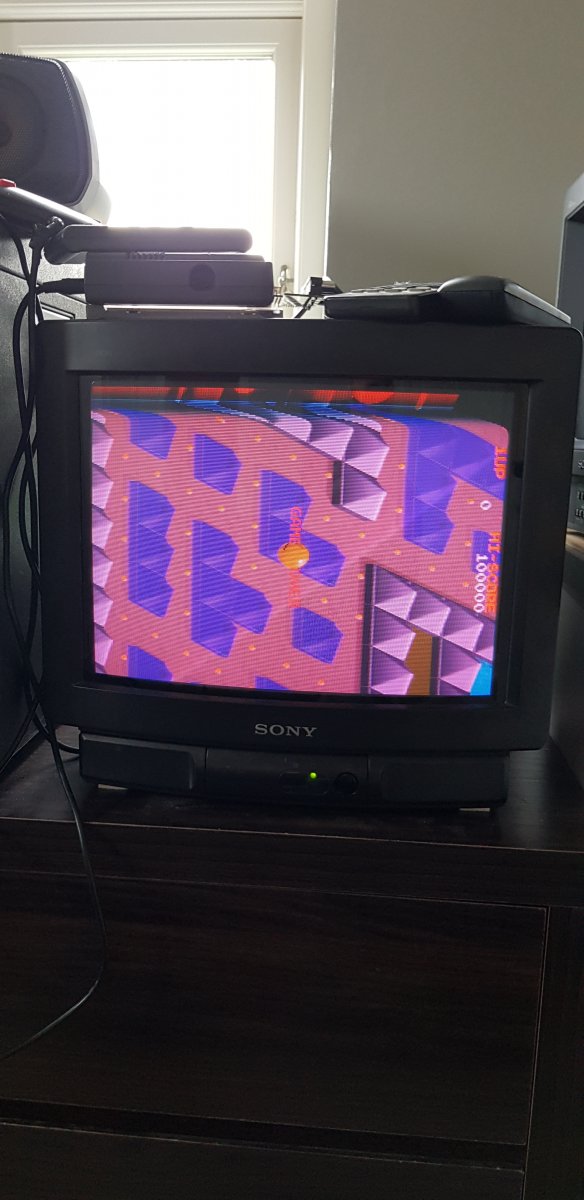

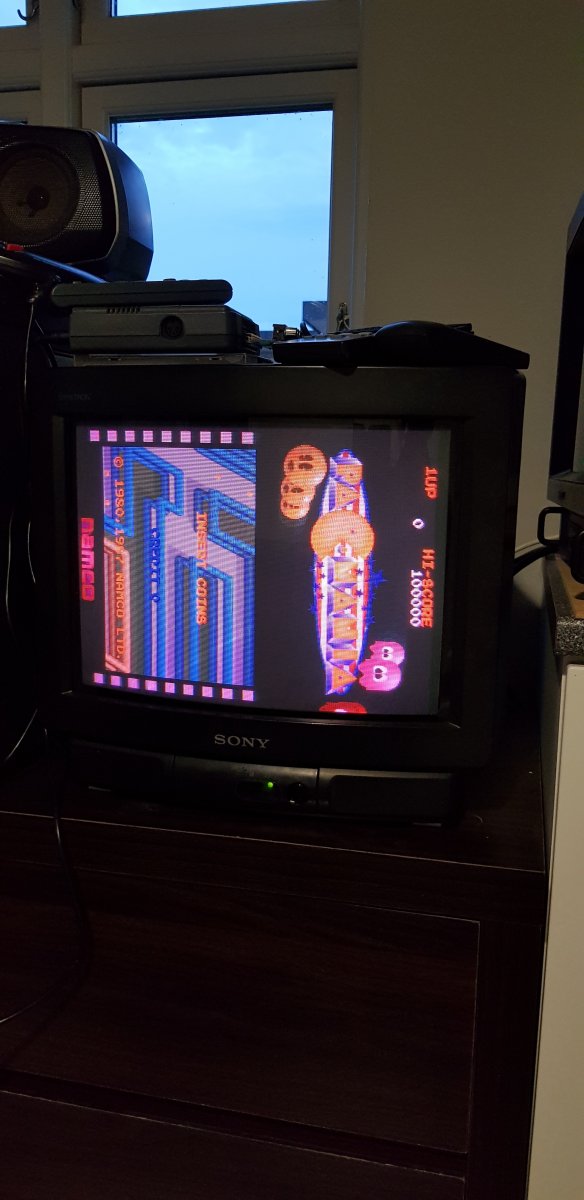

Not bad at all for a first attempt (and I only got the board yesterday afternoon) given my work is theorical, based on my knowledge of video timings on different pieces of hardware as I don't have access to a known good '27' chip.
To me problem at the top is Vsync staying low for too long. I'll make an other try when I'll have time (playing with Vx signals in the equation generating Vsync).
I can't guarantee timings are 100% correct, all I know is I can play my game now, that's good enough to me.
