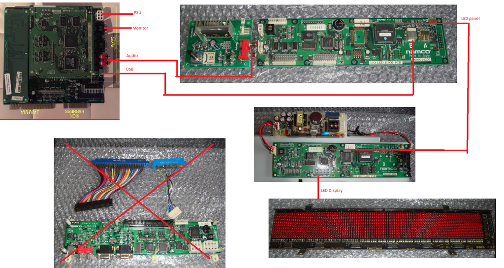

PascalP made a great diagram simplifying the setup:
So I made a small overview of the situation of how everything is connected:

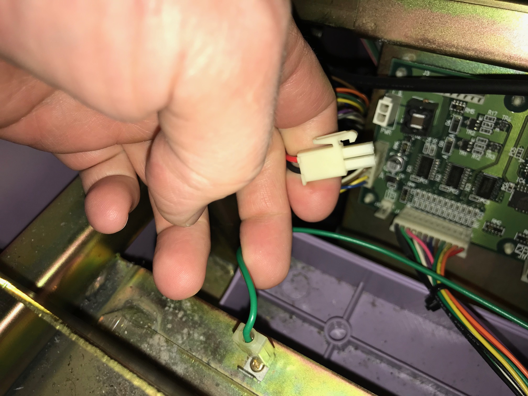

I'm still trying to identify the power connector and the control panel connectors on this PCB... mostly the power connector. If anyone knows the model number of the 2-Pin connector in the corner please let me know. Once I have this I can build a power harness and start experimenting.

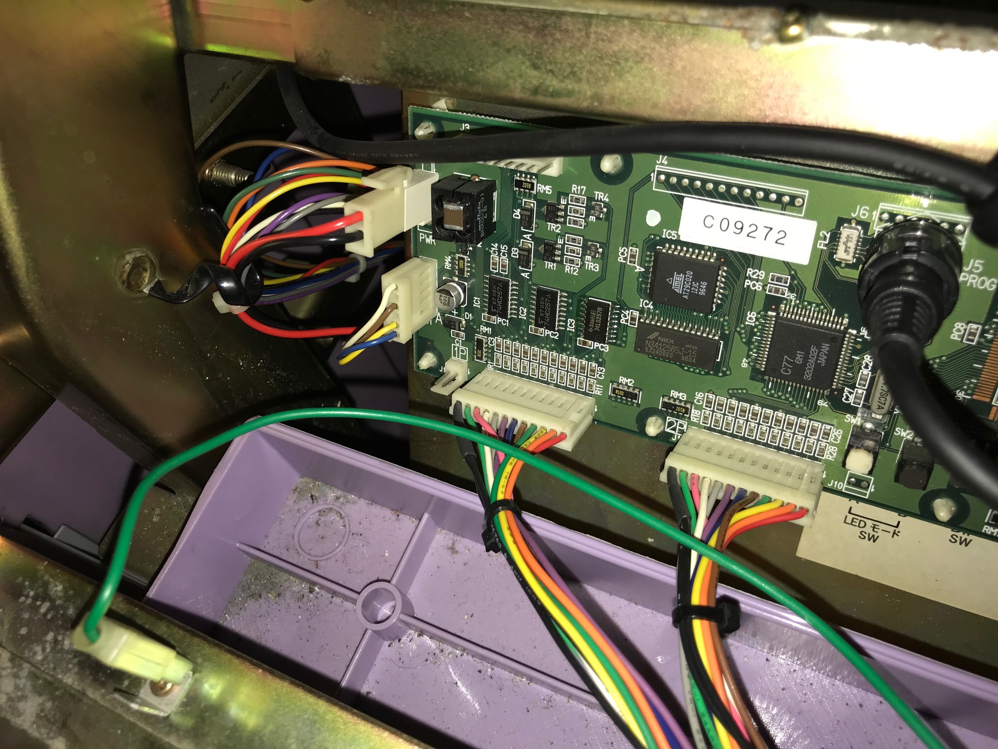

I will give it a proper read tonight when I’m home, but looks good so far!
Also I can snap some pics of the original harness connectors from my cab to help you identify them
Here ya go, 2 pin AMP I think

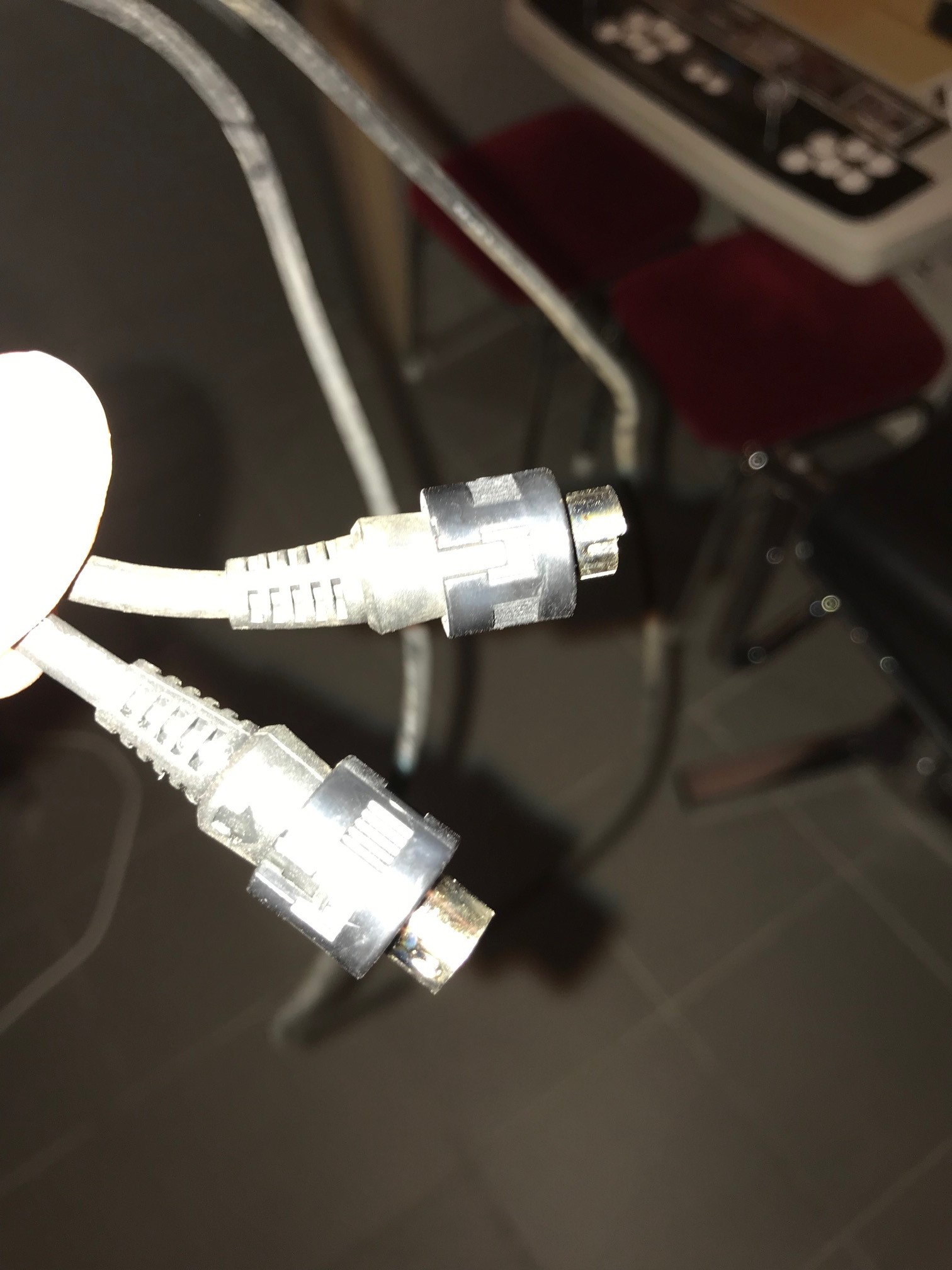

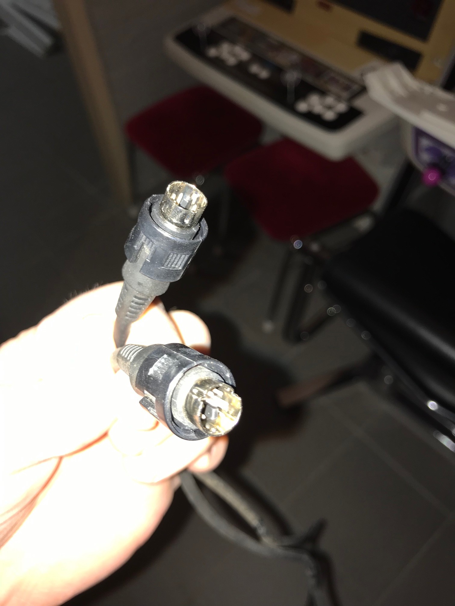

Also I have one spare (6 pin DIN?) cable that interconnects the JVS IO and LED IO somewhere in a box.
I’m gonna dig it up and do a continuity test to see how it is pinned out if you need?
That TE looks spot on IMO

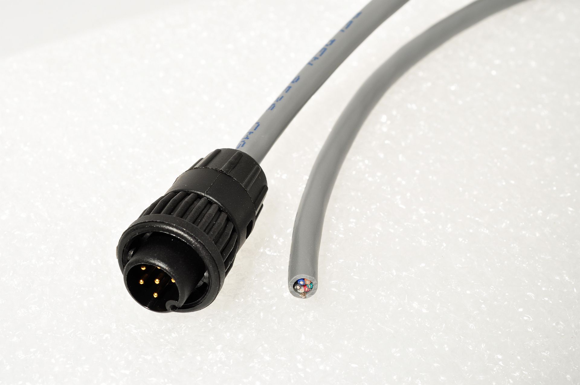

I will dig up the cable and share my findings, I now it is not a ‘standard’ DIN connector as it also has a locking mech
Not exactly the same, but kinda like this idea

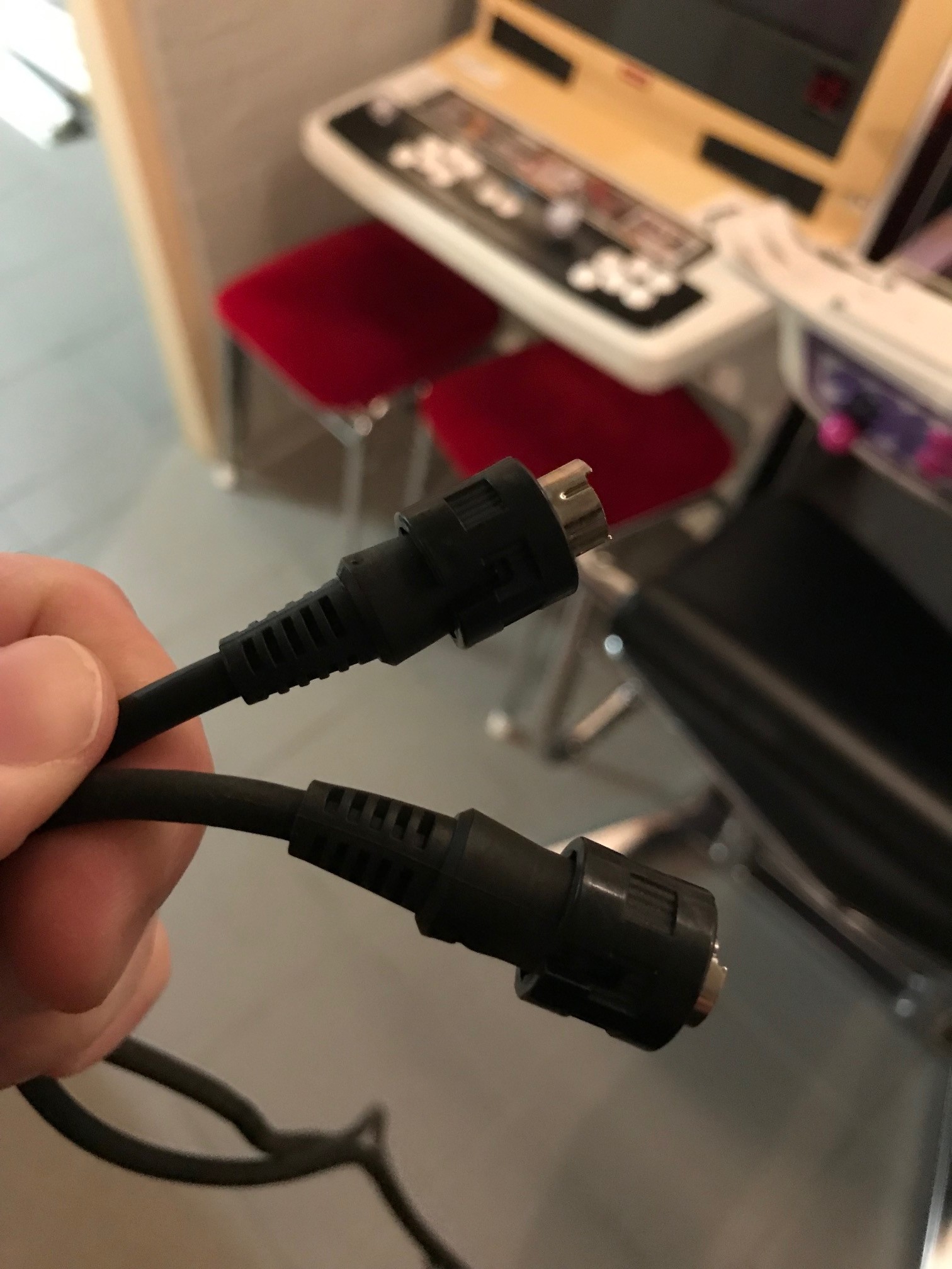

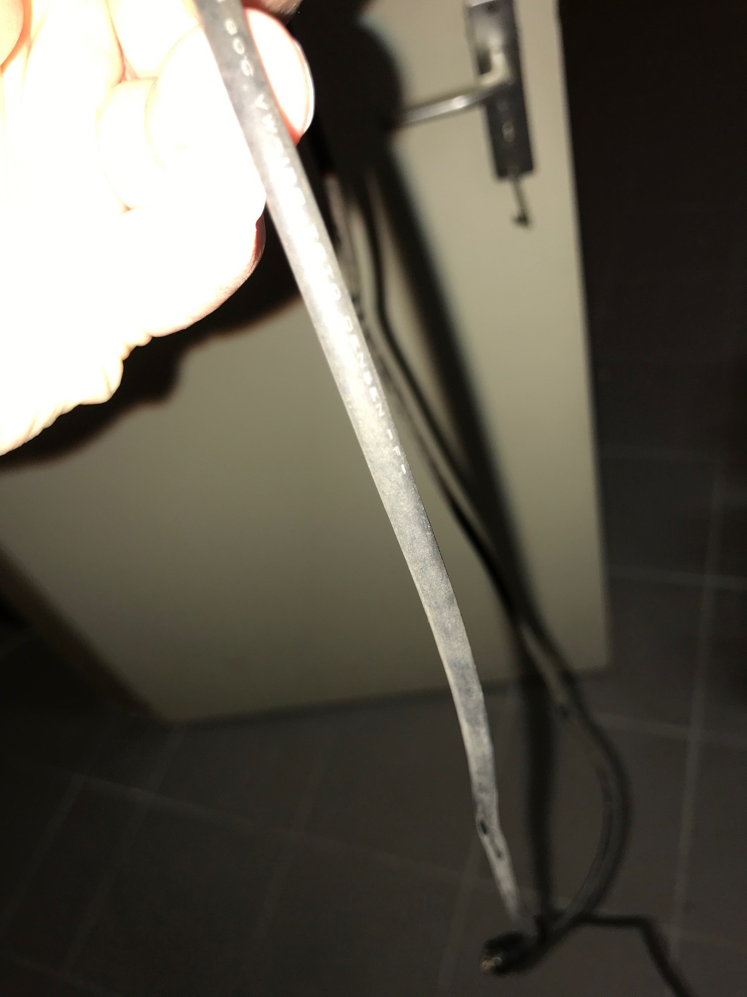

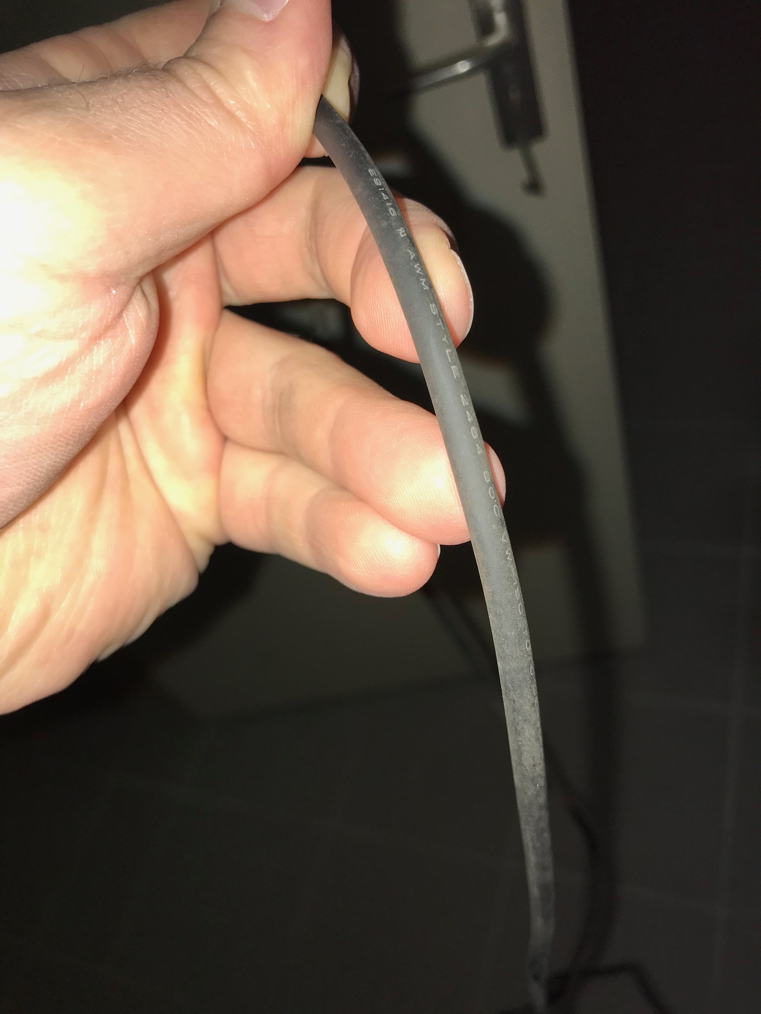

Here are the pics of the cable
No brand on the connectors, just on the cable itself

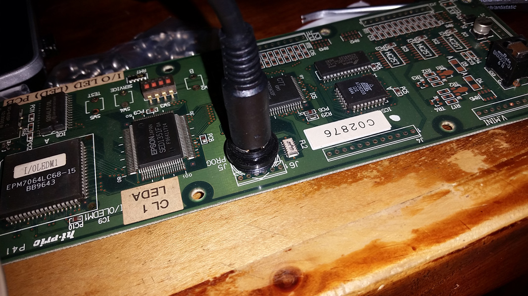

Has it been confirmed it's a 6 pin mini-DIN? From the pic @PascalP took, the arrangement looks different. Could be just the pic though.
I've confirmed it is indeed a 6-pin mini din. I bought a few generic ones and they fit perfectly.
I also noticed the PCB has a silkscreen for a generic 6-pin header so it might be easier to populate that with a dupont or JST NH connector instead of trying to deal with the mini-din
