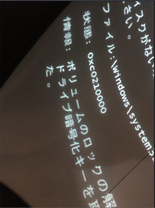

I started to get BitLocker messages which made my heart stop but in Japanese, this is an Namco System ES3 that play's Lost Land Adventure, not new but purchased from second user.

Yes ES3 system are locked on hardware configuration and any PCR value change will prevent from booting. This means you can't replace graphic card, HDD, motherboard...
It also means you can't backup your HDD to replace it with another one. As the HDD changes, it will prevent boot. What you can do is backup your HDD (or make an image) and overwrite on the original HDD - it will still work. But if your original HDD failed, you're doomed.
