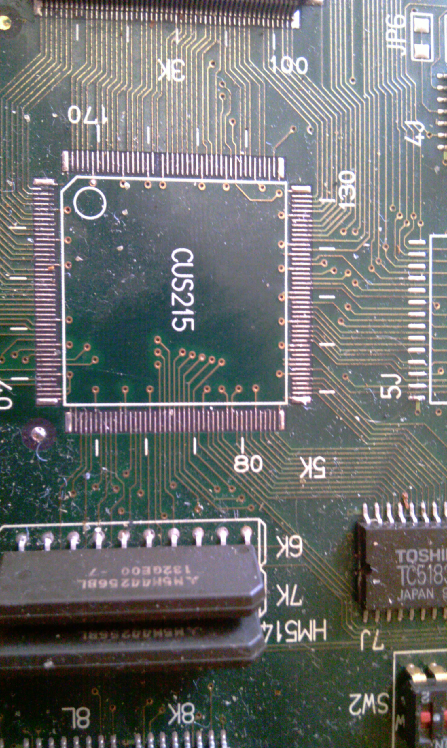

Meanwhile i'm just doing it, i'll share a picture of the connetions underneath the 2 customs. It might be needed to someone and prevent the hassle to desolder this bastards
Big picture here: https://ibb.co/NCWkdj1
Nice 30% there ;)
Now to test all the tracks, get all the old solder off and clean the pads.
If you have microscope it makes it faster by eye.
I got to the checking round and stopped, never refitted and tested ;)
This is the same motherboard model from above (na2)? There is several model numbers / versions.
Edit, my one stripped is an NA1, looks same under the 215 chip. I never removed the other.
PS. 214 = address mapper logic, 215 = GFX chip (with the DMA functions from the CPU and more)
