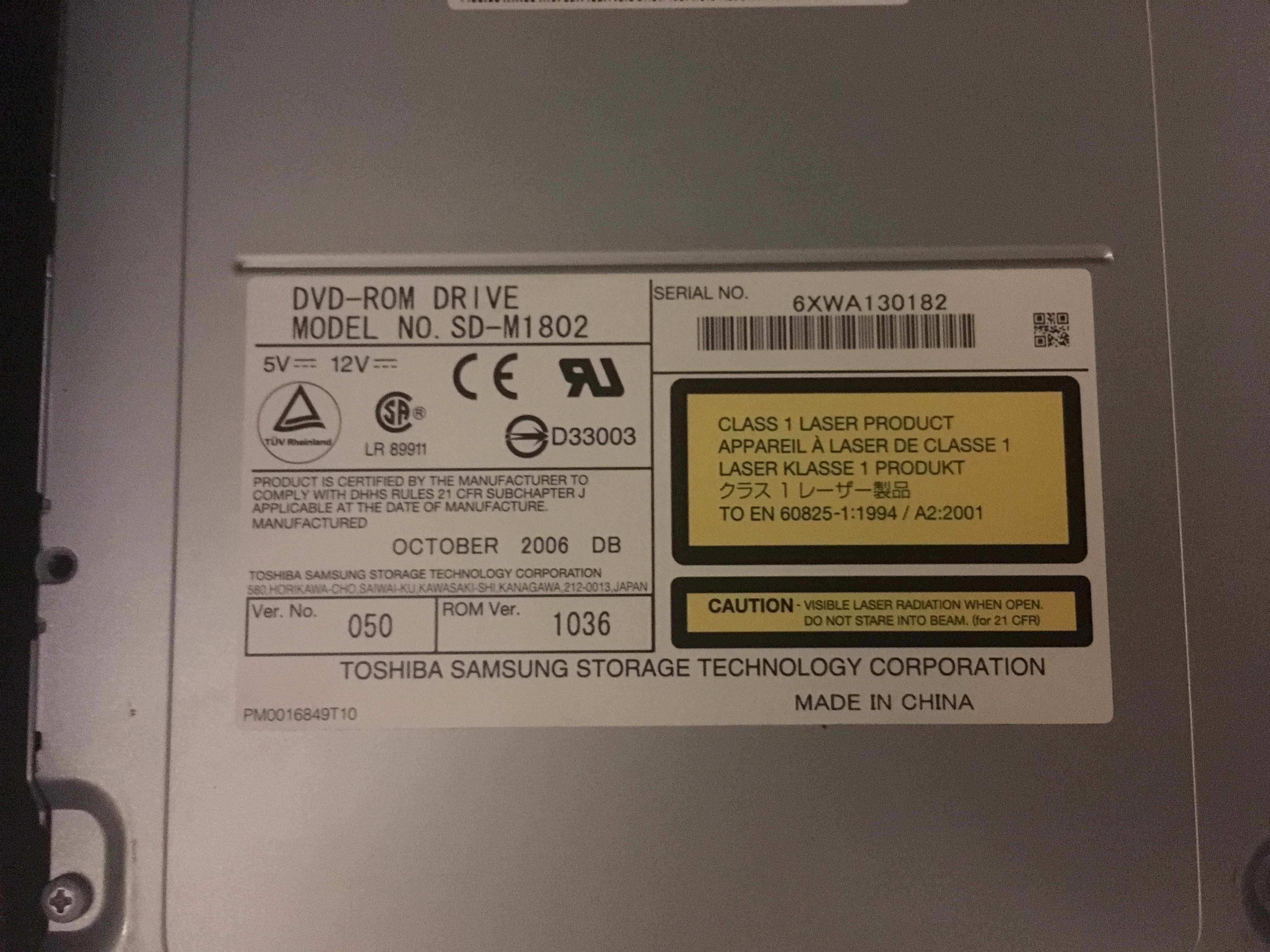

ok here is my dvd drive finding for the system 256 the dvd drive has to be master not carrier select. the disc in the drive will not read with carrier select.
the image below is the origional drive in both of my 256 units. but i suspect the issue your having is that your drive is not in master mode.
