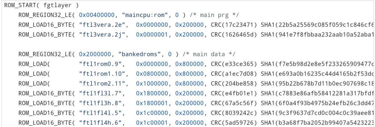

Hi. I'm trying to repair a Fighting Layer original board, and I suspect one of the main data mask roms is broken. So I want to know what is the model of the memory for reading it, and if broken, what replacement to search.

Hi, so much time has passed, so I can confirm the 64mbit mask roms Namco System 12 games use are 23C6410/23C6411, with BYTE signal tied to HIGH (Word Mode, 16bit). So, is perfectly feasible a replacement of these masks with the famous 26L6420 with 3.3V voltage regulator on VCC and WE pins.
