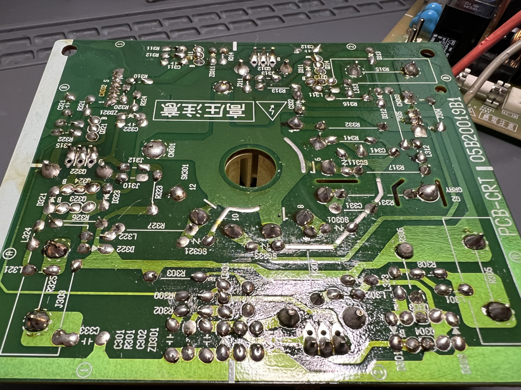

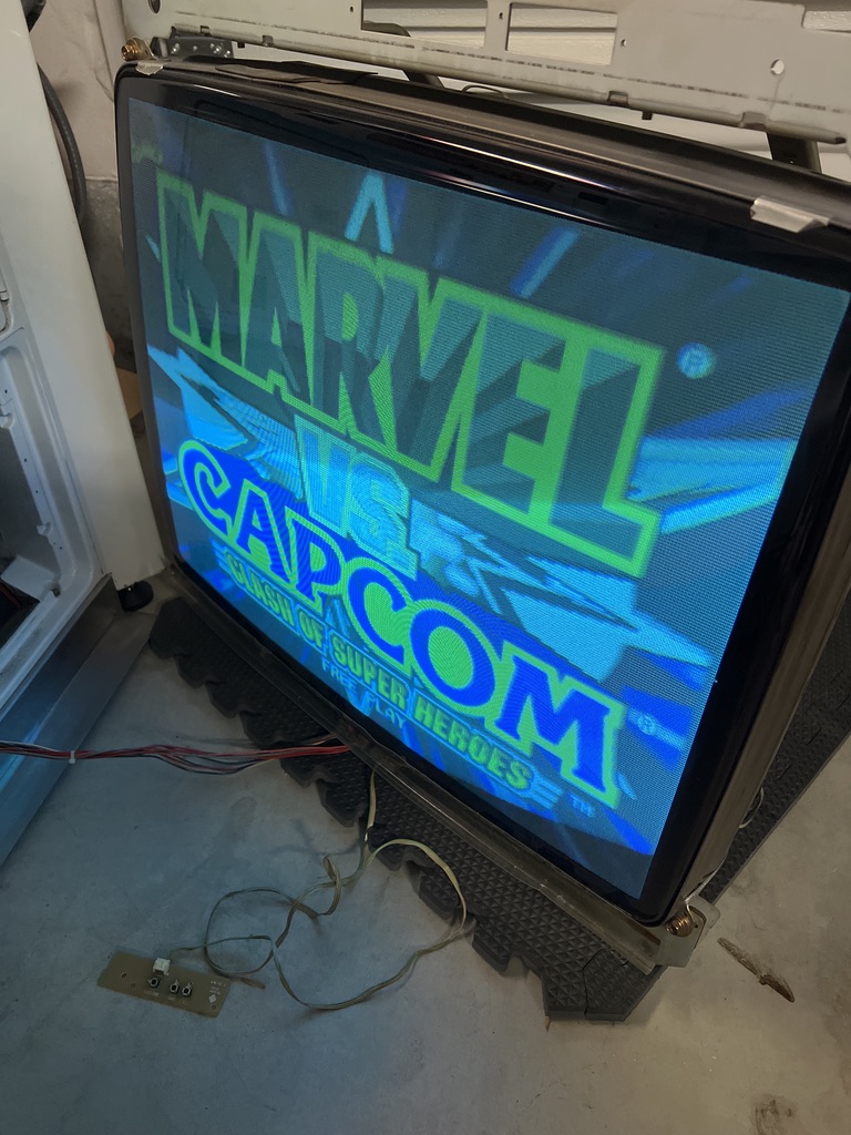

I need some help. When I got my Blast City it didn't turn on. I've posted about my Blast so far here: LINK
Everything else works, except, I have not been able to get red on my tube.
What I've tried so far:
  • Recapped chassis
  • Messed with pots and control board
  • Tried a JAMMA PCB and JVS through VGA, as well as Dreamcast through VGA
  • Swapped the IC chips on the neck board each for one-another
  • Reflowed the neck board
  • Re-checked the main chassis for any cold solder
I'm worried it's the tube, but when I degauss I do see red for a split second. I don't know if that counts for anything, but I'm hoping there is something I've missed on the chassis or neck board.
