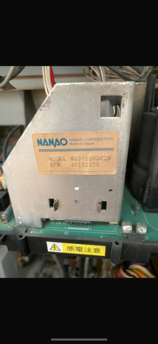

Hey I have egret 2 arcade machine with nanao ms-9 monitor (added photo of the exact version)
M
I did a full recap on a MS9-29 chassis (MS9-29ND22W) and now it won't power on:
No neck glow, no HV, no chirp on power-up
Mains cap gets around 150V, so AC input is fine
B+ hits ~109V briefly then slowly drops to 0V.
About a minute after unplugging, I get a single faint chirp
C4692 removed and tested good
2SK1531 also tests good
B+ cap resistance is around 77kohm.
Has anyone run into something similar on MS9? Would appreciate any tips.
Thanks in advance!
