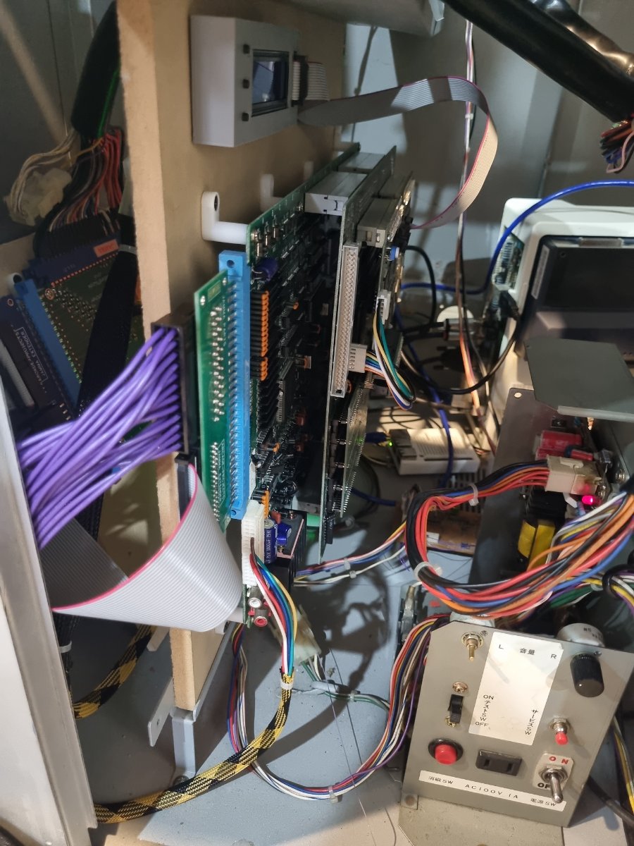

So to make this a real challenge I decided to take one of the numerous Naomi's I have (some of which don't work and some of which might work), combine them with a bunch of dimms and netdimms that definitely don't work and a TD-IO I built from scratch (which should work but I am not really 100% sure actually does) and put this all in the same cab as a working CPS2 multi on a jamma switch. Sounds easy right.

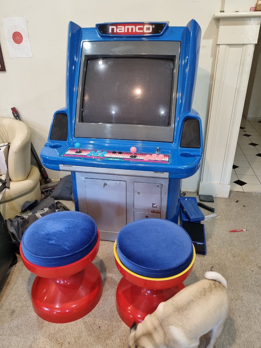

4. Finally, with a TD-IO and a riddled TV jamma switch you can have a CPS2 multi and Naomi Netdimm setup in the same cab.
