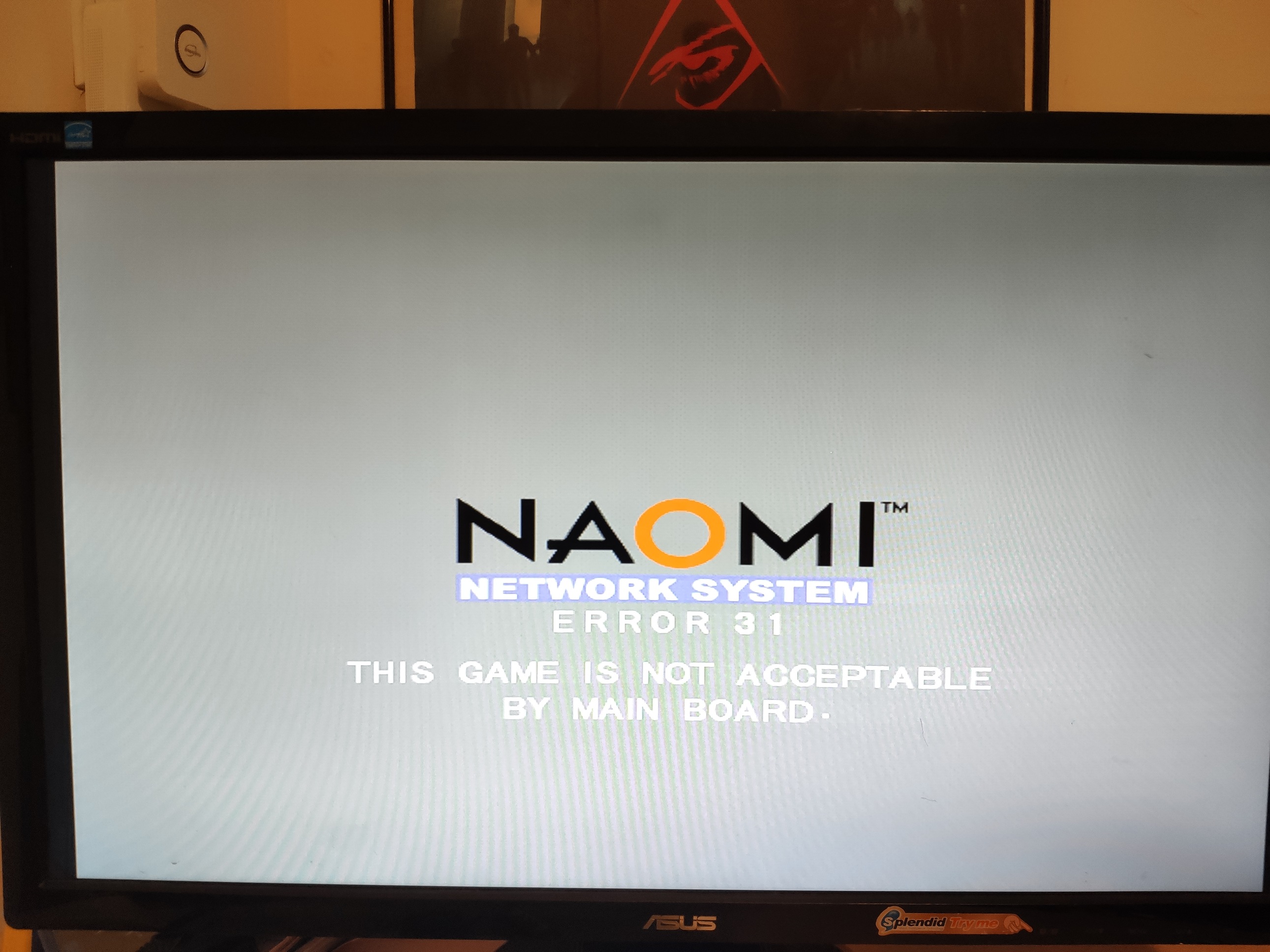

What happens is once I set everything in test mode and exit, it gives me an Error 31 code, which is normal since I don't have any games loaded.

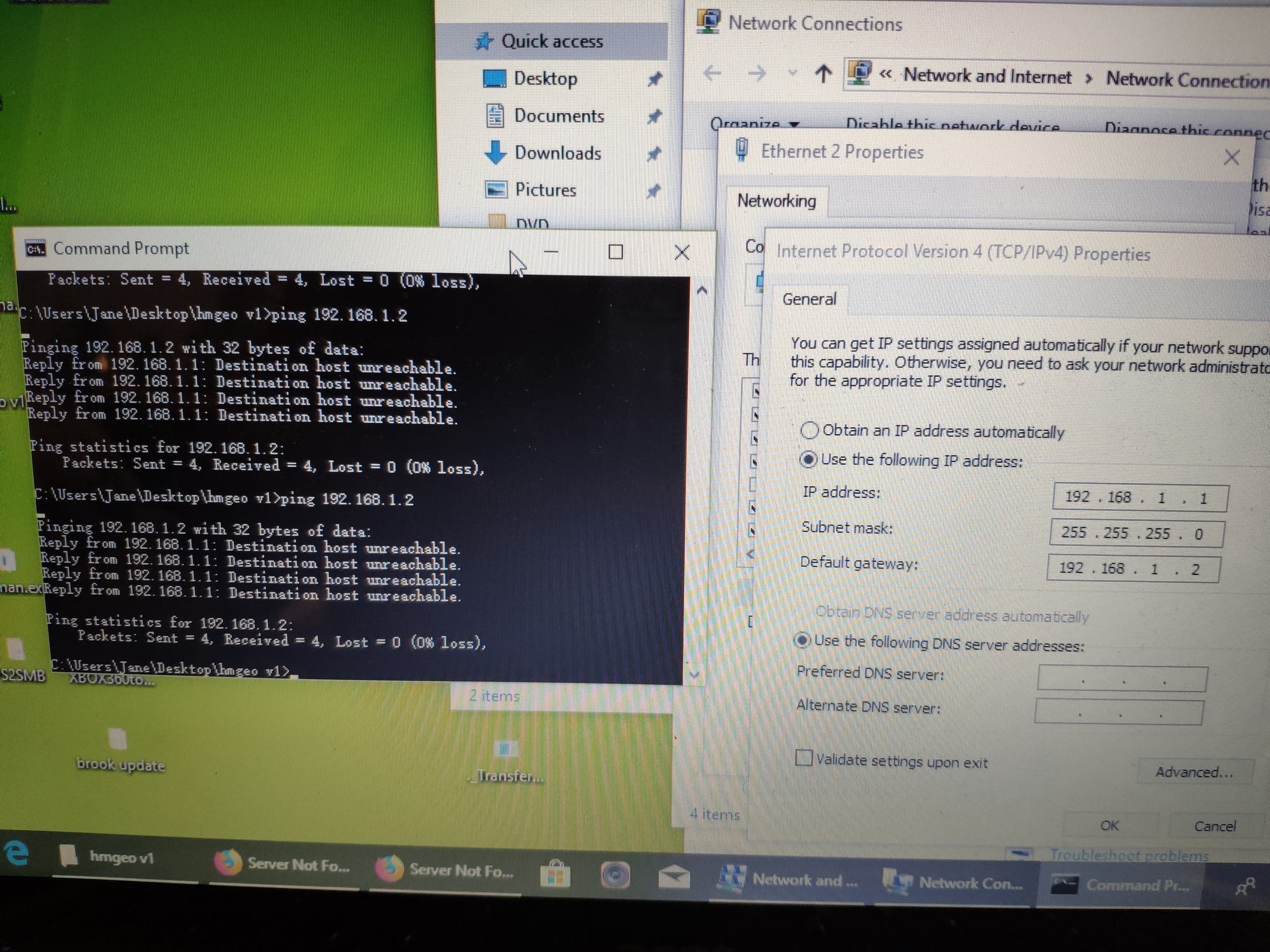

However, when I try to use transfergame.exe or try pinging the net dimm, it gives me a host unreachable message.
I'm using a crossover cable straight from my laptop via USB ethernet adapter to the net dimm.
The ethernet port has a static ip address. Not sure is this set correctly.

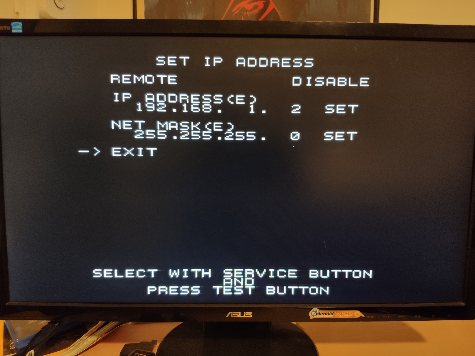

Ok so I'd change the IP addresses to something like 192.168.0.2 that 100.100.100.106 thing is strange to me.
The PC should be 1, the netdimm 2, the 255.255.255.0 is fine.

This looks strange...
The gateway should be that 255.0 number, and the server should be the IP address of the PC.
After you set the options I think it goes back to searching for network message, the error 31 could mean its not saving the options you set?
IDK sorry its been a while, I set this up once, don't recall having any trouble with it or what exactly "normal" operation is at this point.
Did you try to remove and reseat the Netdimm? What version of the Naomi BIOS are you running?
Look here, error 31 isn't even listed as a code.

I just tried the IP address you recommended and got the same error.
For the error 31, the netdimm does save my ip address and subnet mask when I reboot into the test menu though.
Heres the error 31 code I got after exiting out of the test menu.
BIOS chip is the multi-region rev. H. I've tried re-seating the netdimm yet nothing still.

Try setting the ip of your pc to 192.168.1.1 and the gateway to 192.168.1.2
Then set the ip of your net dimm to 192.168.1.2
I tried that and nothing.

T do you think it has anything to do with that error 31? That seems strange to me, can't recall ever seeing that on mine.
Back on my old CF/GD Dimm I would get error 21 constantly, it needed to really be pushed down HARD into the Naomi to avoid it (pin contact issue I believe).
This is going to sound a bit dumb but you don't have wifi turned on right? If you DO have wifi turned on, please disable it and try pinging again. (As a note, 100.100.100.x/24 is a totally valid IP, but it's a public one, so try not to use it unless you own it. For reference, 10.x.x.x, 172.16-31.x.x and 192.168.x.x are the private IP spaces.)
that's 100% normal. it's what you'd receive anytime you enter test mode and then exit without a game loaded on the DIMM.

I noticed one of the windows on your PC says "Ethernet 2" do you have multiple ethernet ports on that PC?
error 31 is a nothing error. Just means the netdimm couldn't find a game in ram...i.e. battery is dead.
If you can ping it, you can send a game to it with error 31.
Last time I got the "Game is not acceptable by mainboard", it was because the bios I had in the naomi wasn't correct, but you have the rev H bios, so that shouldn't be the problem, but just in case, what region jumper settings are you using? I don't see any of the netdimm internal jumpers in any of the photos, but since you see "Checking Network" I guess those are correct too. You said you were directly connected, but still can't ping it... I see that your ethernet is labeled as "2" you don't happen to have a second NIC or anything running right? There's a fairly limited number of things it could be at this point. Something like a VMware NIC or a VPN or a Tunneled interface of some kind? If you set your machine to a different subnet (e.g 192.168.0.1 instead of .1.1) and run tracert to the Naomi's IP address what does it do? Just some asterisks or does it give you an IP as the first response?
Edit: As a further test, tack on -S (your machine's IP address) to your ping command to see if you can force it to use whatever interface it is you're trying to use.

The strange thing is that there are no packets loss when pinged from my regular computer. However, on the old XP laptop, the results are 100% packet loss.
Yes, I tried that and it just times out. The naomi monitor doesnt display any percentages loading, just checking network still.
I'm not too familiar with tracert but I did ran that, transfergame.exe and another ping.
