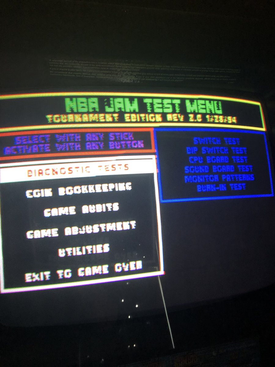

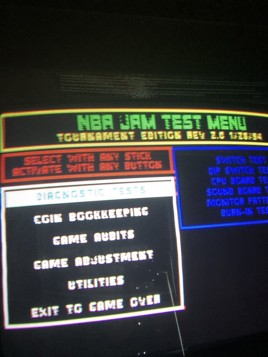

Ok so my orginal eproms work no issues but when i use my burnt ones from the hack they show up red and some graphic issues?? Do the roms need to be reseated? Only the sound board is not plugged in i wanted to test to see if the roms worked

No reason not to clean both the rom legs and the sockets and see where that gets you. Something like QD Electronics cleaner you can pick up at home depot/autozone, and a toothbrush.

Your ROMs will show up red now in the boot up diagnostic, this is normal. There shouldn’t be graphic issues however. I would pull all, make sure you didn’t bend/fold over a leg during install and reseat.

Ya some of them kinda got bent cuz its a bitch sometimes hard to put in idk if i could fix them tho to reseat it.

You can try to carefully bend them back using a pair of tweezers. Try to limit how much they flex near the base of the EPROM.
I've had great luck using deoxit on my sockets.
