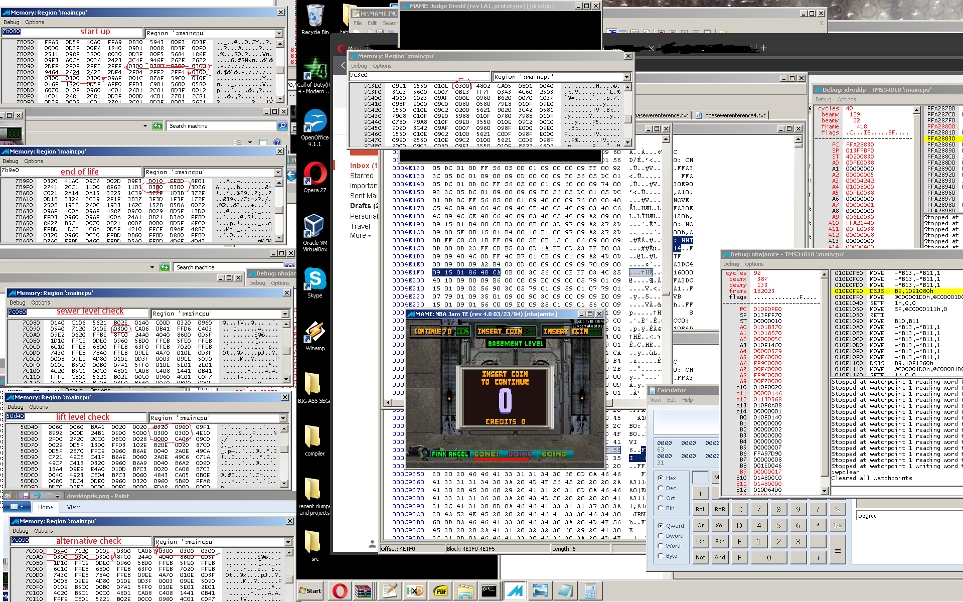

I have dug around lost files and found some of the files from creating the hack.
Here is a screenshot from that time, it gives other hackers a good idea what to look for....
Very primitive, but some examples.... don't think it's what i ended up with...
the last version is actually on my pcb and needs dumping due to hard drive fail!
I will release the rom files at some stage, but would like it finished...
If the bug can't be worked out will just put a reset at the end of the game or something to get around the bug and call it done.

Interesting -- so with this bug - does the game just lock up until powered down?
Does it happen at the end of each game.. or per quarter?
Well, you can play the game with as many credits as you like and beat the game and it's perfect.
After beating the game the next play will be very boring as it will randomly select a level and just give you that again and again.
It's cool when it gives you the shooting stage tho.
This makes it a swine to track down requiring a complete play (and trace!) just to get to the error.
