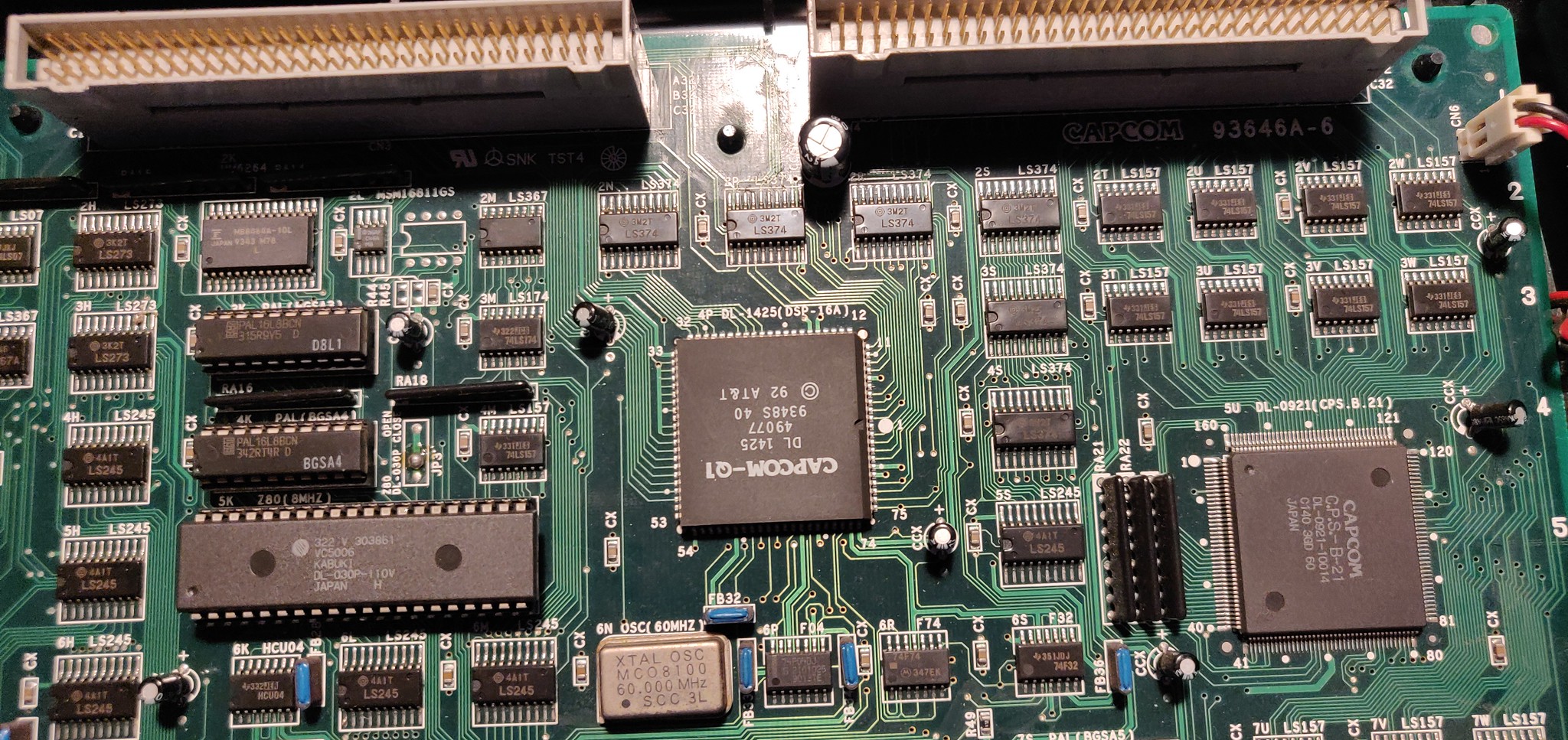

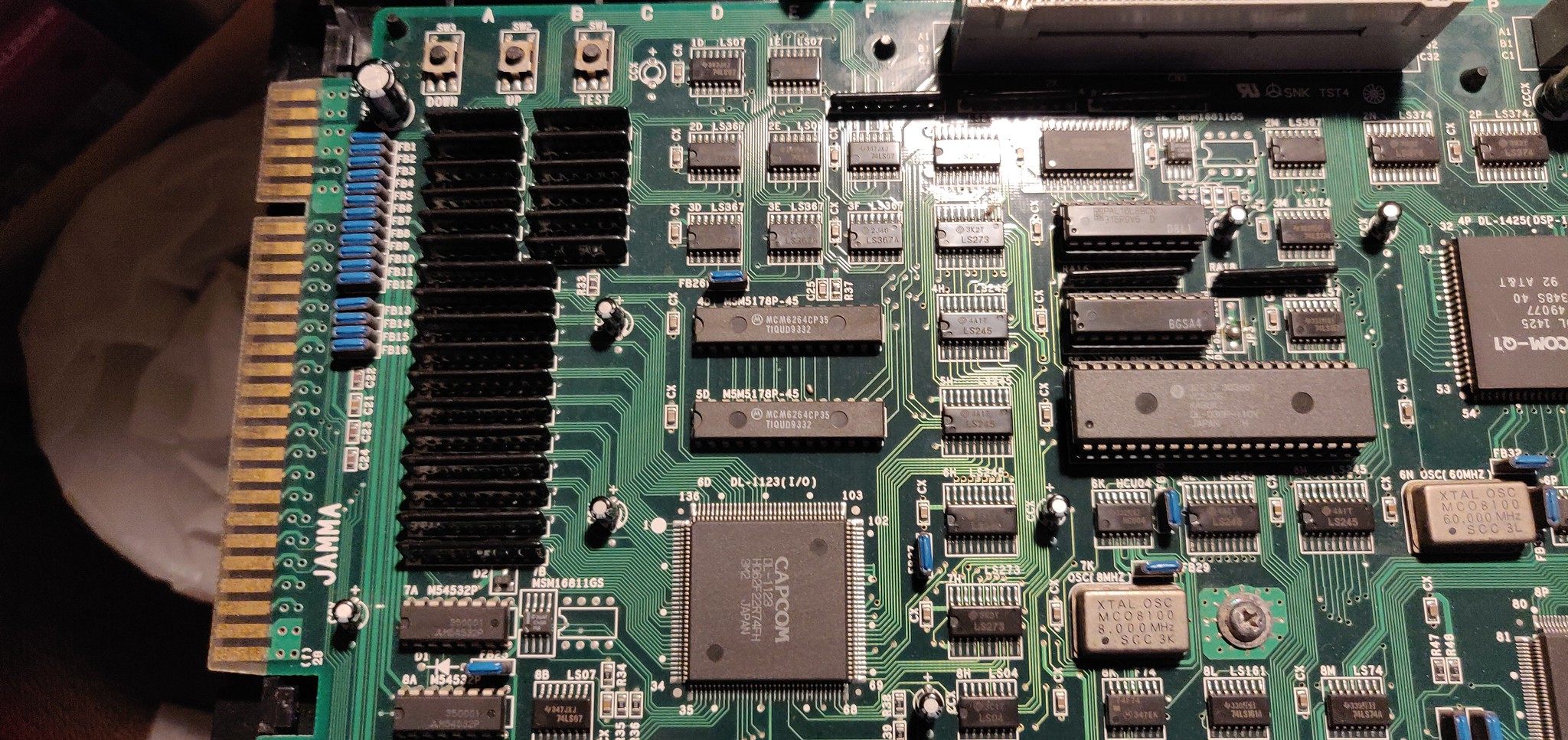

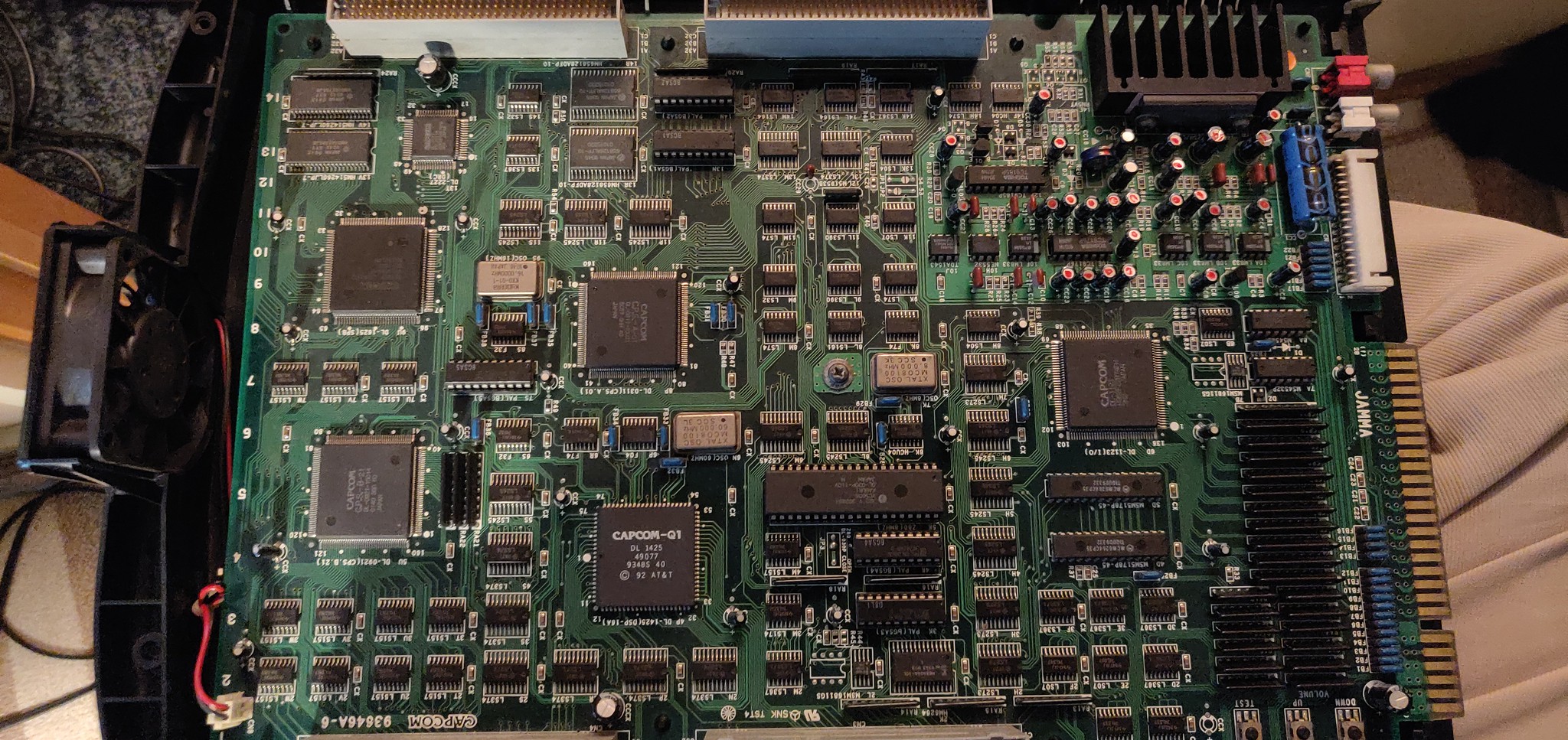

Bought as junk from YAJ with a working B board.
A board only powers on randomly with a game with full ROM set populated. Doesn't produce sound at all, regardless of setting mono or Q sound/stereo. No sound from JAMMA edge or RCA jacks. I've tried powering on with volume down held with no change.
If I connect a B board with the Razoola Suicide CPS2 test ROM, it powers on and displays text every time... but sound ROMs show an error, and no audio plays. But there are rare occasions it starts with no error, but still no sound.
I already did a shotgun approach and replaced all the capacitors in the sound section of the board with no change.

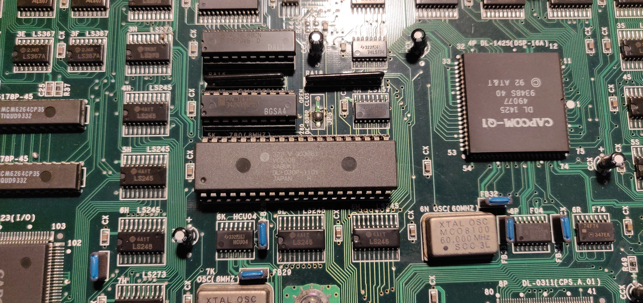

Attached are pics of the junk A board. When I compared it to my separate working A board, I noticed that this junk one has the CPU in a socket... and the CPU is labeled differently?
Is that different CPU the issue? Or is there something else I could try?
I don't have a logic probe or scope, so I imagine that makes things more difficult to diagnose.

Replacing the capacitors won't help if the board isn't able to read the sound ROMs.
The reason the Z80 is socketed is because this is a common cause of sound failures in CPS1 so someone has performed the same fix here to see if it worked.
It's still entirely possible the CPU is at fault but I'm not sure if a standard Z80A will work or whether you need the Kabuki

Well, I got the new z80 in, and no change. Still no sound. Street Fighter Zero does its initial checks and hangs on the Q Sound check.
Any other ideas on what I could check or try? Any chips I should maybe try reflowing the solder on?
Sorry, I should've stated.
I replaced with a standard z80 that looks to be a match with what is in my working A board. I undid the "DL-030P" jumper as well.
If you need close-up pics of anything, I can try and take some.
Hmm. If it's freezing on the initial checks that points to a RAM or ROM issue. Since you have tried the B on a known good A that leaves RAM as the next thing to look at, especially since you replaced the CPU.
It could also be the Q Sound processor since it would also explain the issues you're having
I imagine the big ""CAPCOM-Q1" chip is Q Sound processor, but would you be able to point out the ram?
I'm not actually 100% sure myself but I would assume it's the 6264 SRAM in the sound section next to CN3

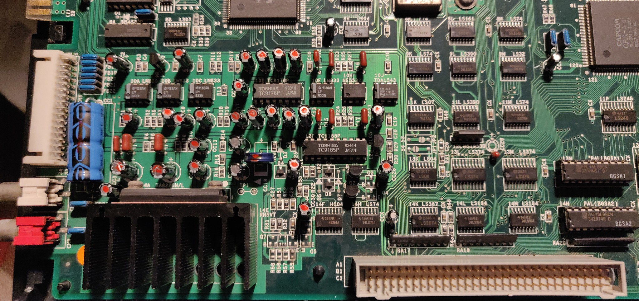

In photo 2.jpg - Fujitsu MB8464
One of the 2 PALs could also be bad
Also and I only noticed this recently, what on earth did AT&T have to do with Q Sound?
