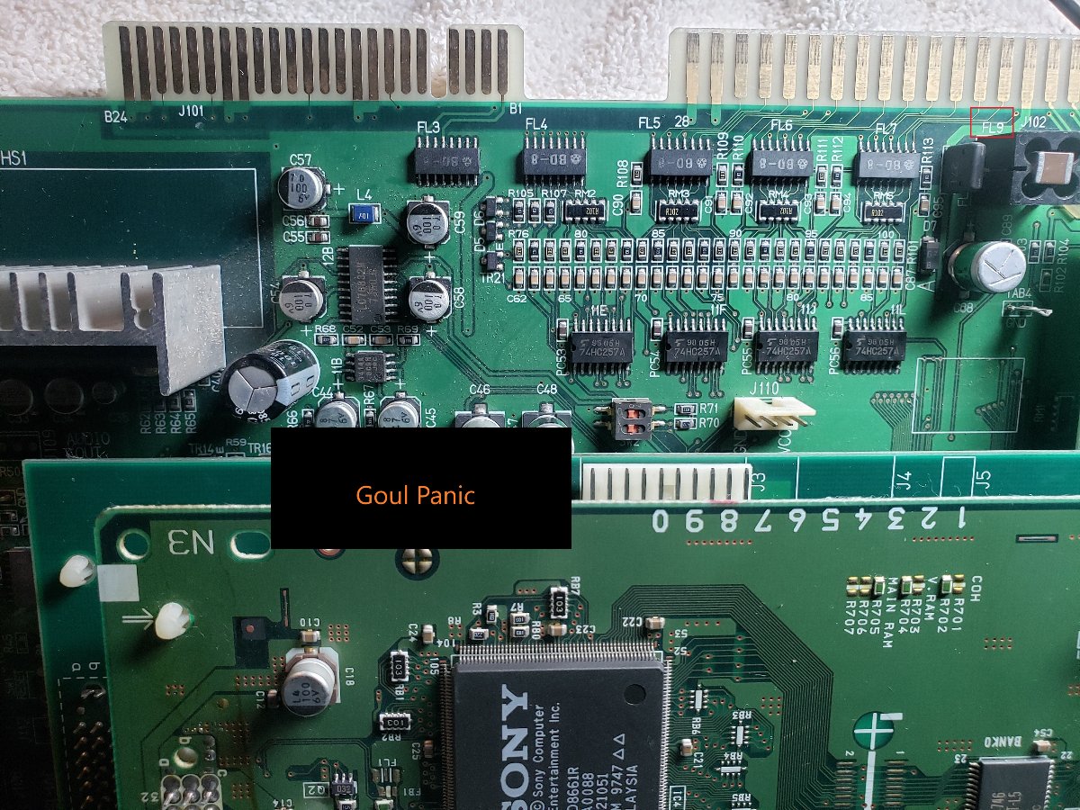

I'm in the process of swapping out my Point Blank 2 System 12 PCB for a Ghoul PanicPCB set, and I’ve run into an issue with the light guns not functioning.
When I plug the Point Blank 2 JAMMA connector directly into the Ghoul Panic PCB, everything works except the guns — video displays fine, audio is good, coins register, start buttons and test switch all function correctly. But the guns are completely unresponsive, both in-game and in test mode.

Ghoul Panic should just drop in place of a Point Blank 2, so I'm not sure what the issue is.
The V218 is a filter board, it is completely passive. It just consolidates all the wiring into a set of connectors. My Japanese Point Blank cabinet does not have a jamma connector, everything plugs into these connectors.
Can you show how you have Point Blank 2 set up in your cabinet?
V218 should have the same pinout as V147 below. It's just missing J106, which is only used with Point Blank 1.

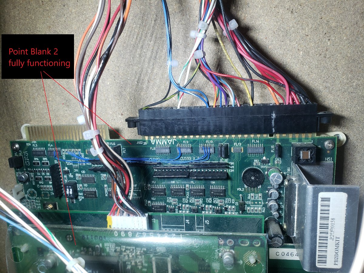

My Point Blank 2 setup connects directly to the JAMMA harness without using a consolidation or filter board. This setup was custom-built for me by a professional arcade service years ago (they’re no longer in business).
I’ve attached pictures of the fully functioning Point Blank 2 PCB, showing the JAMMA connection and how the guns are wired. The entire setup works perfectly with Point Blank 2 — video, sound, controls, and both guns are fully functional.
However, when I connect the exact same harness and connectors to the Ghoul Panic PCB, everything works except the guns. They don’t respond in-game or in test mode.
Could this be due to a missing or faulty gun input/filter board on the Ghoul Panic setup? Or could it be a bad gun sense circuit on the Ghoul Panic PCB itself?

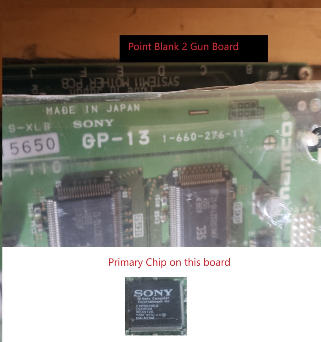

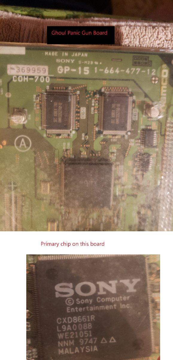

I should clarify — both the Point Blank 2 and Ghoul Panic PCB sets (excluding the V218 board) have identical connectors in identical locations, so I simply moved all cables from the Point Blank 2 board to the corresponding ports on the Ghoul Panic board.
Everything works except the guns — video, audio, coin, start buttons, and test switch are all functioning.
After that, I checked the gun I/O boards on both sets and noticed they are not identical — different model numbers and different chip markings (photos attached). So even though I have a working gun board on the Point Blank 2 set, I'm hesitant to swap it into the Ghoul Panic setup.
My concern is:
  • If something on the Ghoul Panic board is faulty and caused its gun board to fail, I could risk damaging my good Point Blank 2 gun board by testing it there.
  • If that happens, I'd go from needing one working gun board to two, and I’m already having trouble sourcing even one.
Question:​
👉 Is it safe to test the known working Point Blank 2 gun board on the Ghoul Panic PCB, or could that potentially damage it if there’s an issue on the mainboard side?

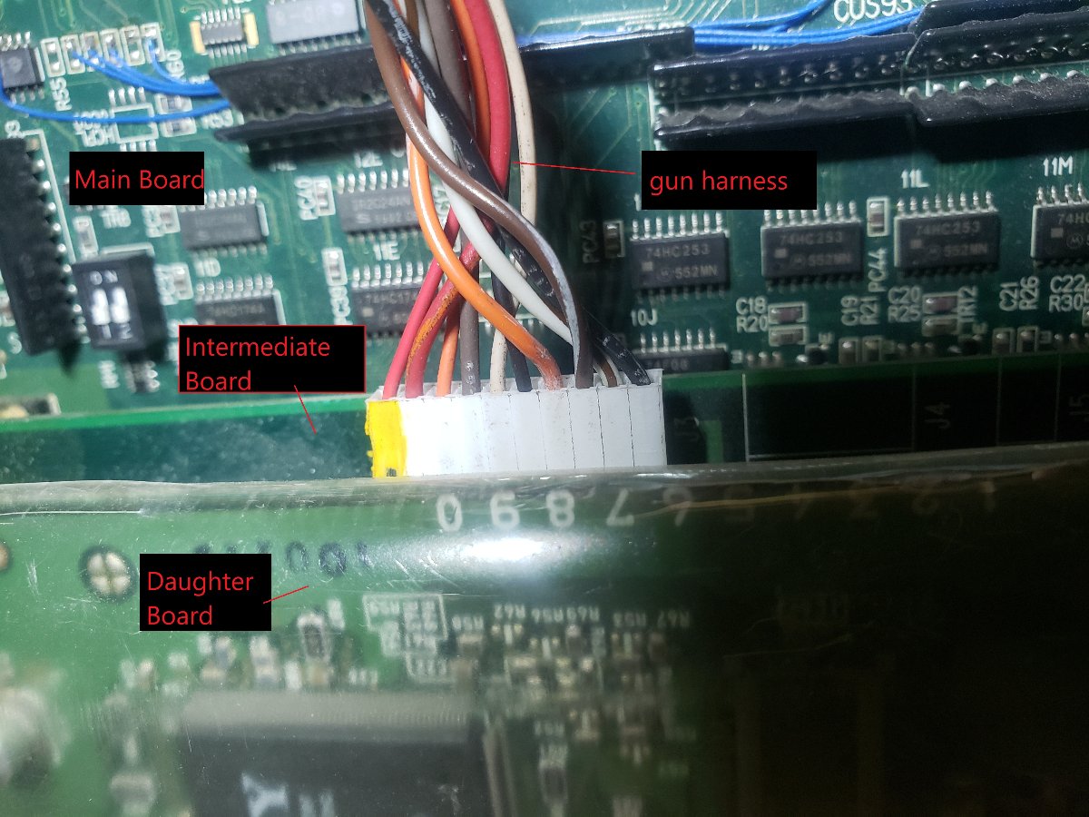

Observation on System 12 Stacks – Missing Gun I/O Layer in Tekken/Soul Calibur Sets
While browsing eBay, I noticed that several Tekken and Soul Calibur System 12 board sets use the same daughterboard model number as the one found in my Ghoul Panic setup. However, there’s a key difference in the stack layout.
Both Point Blank 2 and Ghoul Panic use a 3-board stack:
  • The main board connects to an intermediate board,
  • And that intermediate board connects to the top daughterboard (the one pictured earlier).
What’s interesting is that most of the Tekken and Soul Calibur sets I found are missing the middle board entirely — they go straight from the main board to the daughterboard.
That middle board appears to be critical — it’s the one that has the header for the gun harness connection.
(See attached pics for reference.)
Maybe the intermediate board is the one that is malfunctioning.

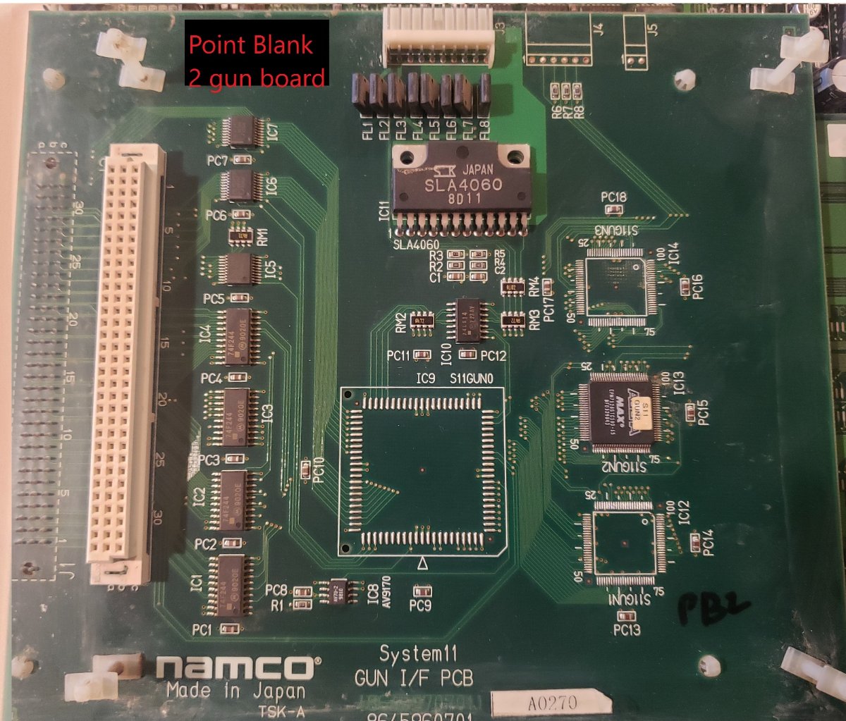

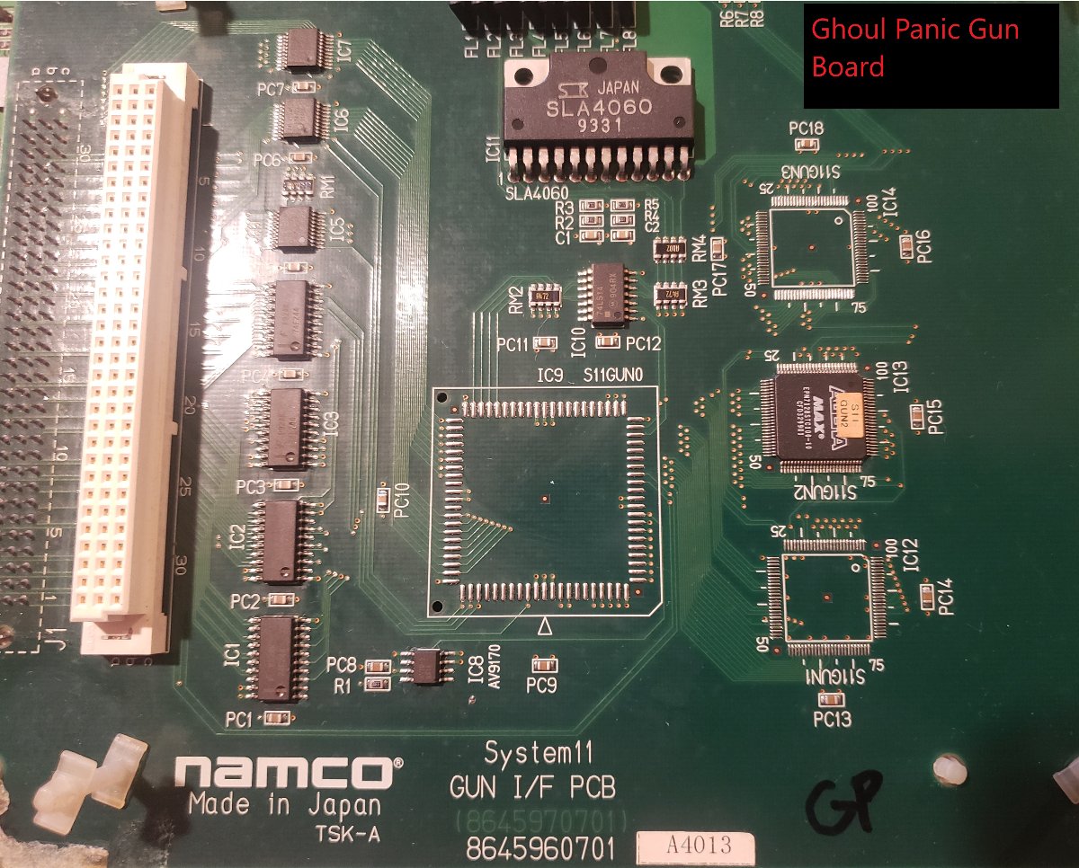

The board you have pictured is the CPU board. There's nothing wrong with that as the game is running.
The gun daughter board sits below the CPU board. I assume they are the same, but I don't own a Ghoul Panic to confirm.
If they look the same, I would try swapping them.

Oh, I know what's likely wrong.
I think it's because the triggers are normally on the auxiliary edge connector, not the jamma connector. That's why you have jumper wires on the Point Blank 2 board. They're the blue wires. Would explain why the guns don't do anything.
Start by copying these two to the Ghoul Panic board:
The other three wires are for P1 & P2 start and maybe the coin signal?

I have attached the pictures of the Point Blank 2 Gun board and the Ghoul Panic 2 gun board. They look identical but the chips markings and model number are different.
Those should be interchangeable. They're the same board.
Try to get the game booting again and then do the jumper wires. I'm almost certain it will fix your issue.

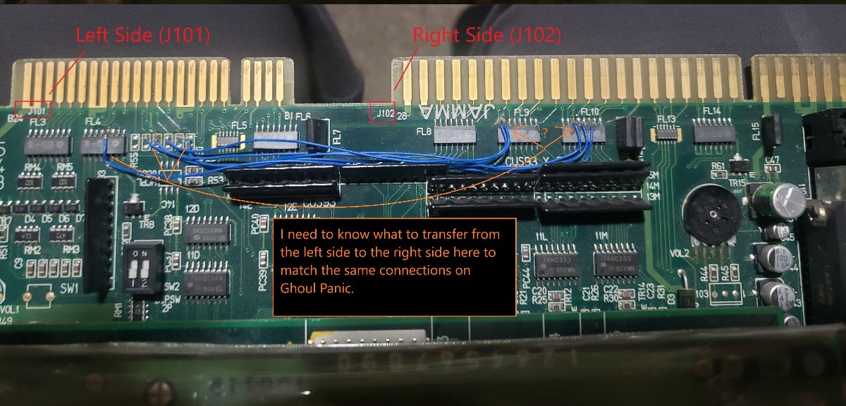

Over the next few days, I’m going to try tackling these tiny solder points in my free time. I’ve attached images with the two wires in question highlighted — note that the red wire is soldered to two points on the board on one end.
I don’t believe the blue wires are entirely to coin, music, or button inputs, since all of those work perfectly when I swap the JAMMA cables over to the Ghoul Panic board. The only thing that doesn’t work is the guns.
When I enter the test mode on the Ghoul Panic board and go to the gun test screen, it doesn’t register any gun input — there’s no on-screen marker to indicate where I am aiming or trigger response. So it seems like both the gun position (sensor) and the trigger signal aren’t being detected.
Given that, do you think I should try replicating all the blue wire solder points on the GP board? I'm not sure I’ll be able to pull it off — I’ve never soldered anything this small before.
Well, you can verify what they are by comparing to the jamma pinout:
https://wiki.arcadeotaku.com/w/JAMMA#Jamma_connector_pinout
Are there wires on the underside of the PB2 baord too?
Do the triggers work in the input test on Ghoul Panic?

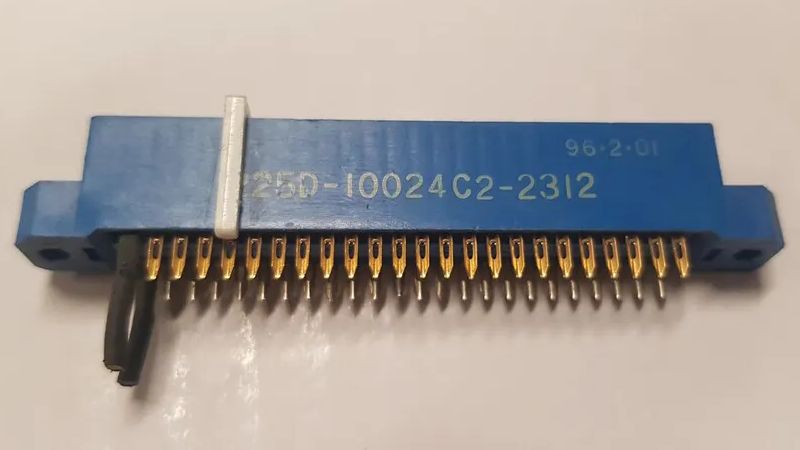

If you don't feel comfortable soldering to the board, you could get a System11/12 kick harness connector. Then wire that up to the guns.
After weeks of searching, I cant seem to find a kick harness anywhere. I am going to have to perform the solders :(
Also, the link you posted of the Jamma pinout is for the right side of the board(J102), but I need a pinout for the left side of the jamma (J101) to see what was transferred to the right side(j102) via the blue wires.
Answers to your questions:
1: There arent any wires on the underside. The blue wires from the pics are the only ones.
2: The triggers/solenoids do not work on ghoul panic when going into test mode, or anywhere.
Questions:
1: Do you know where I can find a pinout to the left jamma slot (J101)
2: How would you go about identifying what pin each of these blue wires is connected to? I ask because the Ghoul panic board has different architecture so I cant just 1:1 copy the solders. (see photo)
https://www.zax.com.au/product/9843-48-pin-namco-harness-connector
30 bucks, not cheap, but it's there if you want it.
The left side connector is not jamma. It's Namco's own proprietary connector. I'm not sure there is a pinout available for it, but I am sure the pinout is the same between the two boards. Ghoul Panic was meant to drop in place of Point Blank. Point Blank 1, 2 and 3 are all different hardware too, but the edge connectors are all compatible with each other. Same thing.
Anyway, you need a multimeter. Then check which pads are connected together between J101 and J102 and then bridge them on the Ghoul Panic board as well.

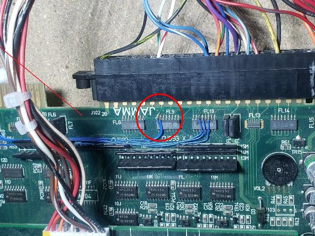

Please accept my apologies for the delayed reply—an exceptionally demanding project at work forced me to set aside my hobbies for a few months.
I’m happy to report that the problem is fully resolved: the game now runs flawlessly in my Point Blank 2 cabinet. Now, all that’s required to switch titles is swapping the JAMMA harness and the 10-pin gun board (J3) connectors.
Root cause and fix
As shown in the attached photos, I bridged the ground on the 10-pin J3 connector to pin 1 (common ground) on the JAMMA edge. While checking voltages with a multimeter, I noticed that both black leads on J3 dropped when the triggers were pulled but never reached 0 V. Linking them to the cabinet’s common ground allowed the trigger logic to register a true low, indicating that the original wiring left the ground “floating.”
Key takeaways
  • A single ground jumper was sufficient to restore full functionality; both guns now perform as expected. My wife and I have logged several sessions without any issues.
This was a frustrating but educational problem to work through because I learned a lot. For example, I learned that my PB2 cabinet uses Suzo Happ .45-calibre type 2 light guns in the 6-pin configuration: blue, black, white, red, yellow (24 V), and orange (24 V return).
