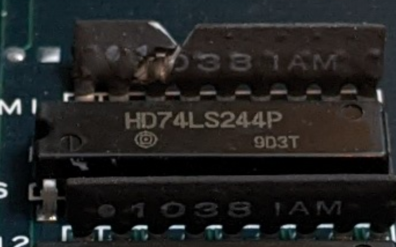

Anyone knows what this component is and where to buy. I attached the picture. I recently got a Technos PCB with one of these components damaged. I haven't fired the pcb up yet and thinking maybe I should replace the component first.

Looks like a 9 pin resistor array. Measure the resistance between pin 1 (the one marked with a dot) and the other pins to get the value. It should be the same for all pins and I'm guessing it's 10kOhm.
I measured the damaged one between 1st leg and one of other legs, it measured 500 ohm so I assume it's 1k resistor? All other legs read 0 ohm.
I measured other PCB with similar component, it measured 1k ohm and then back to 0 ohm. Does this indicate a bad resistor?
Can I find this kind of resistor easily online?
My bad, I set the multimeter incorrectly. It tested again the one that is still in good condition and it read 10k and the value was stable.
