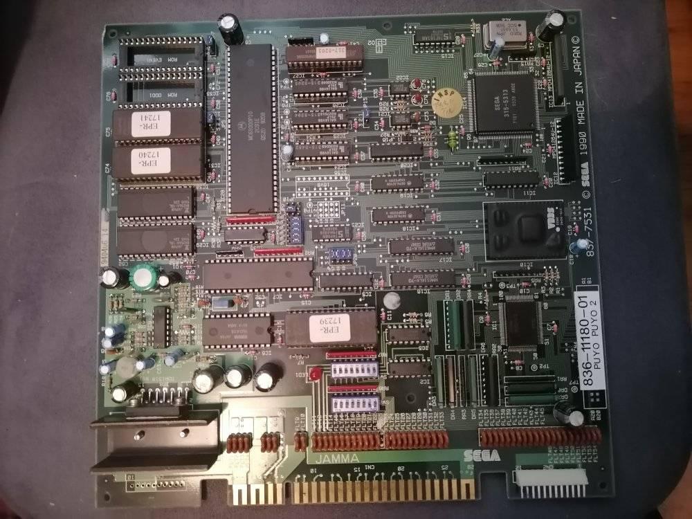

I have recieved a Puyo 2 convert with a wierd problem.

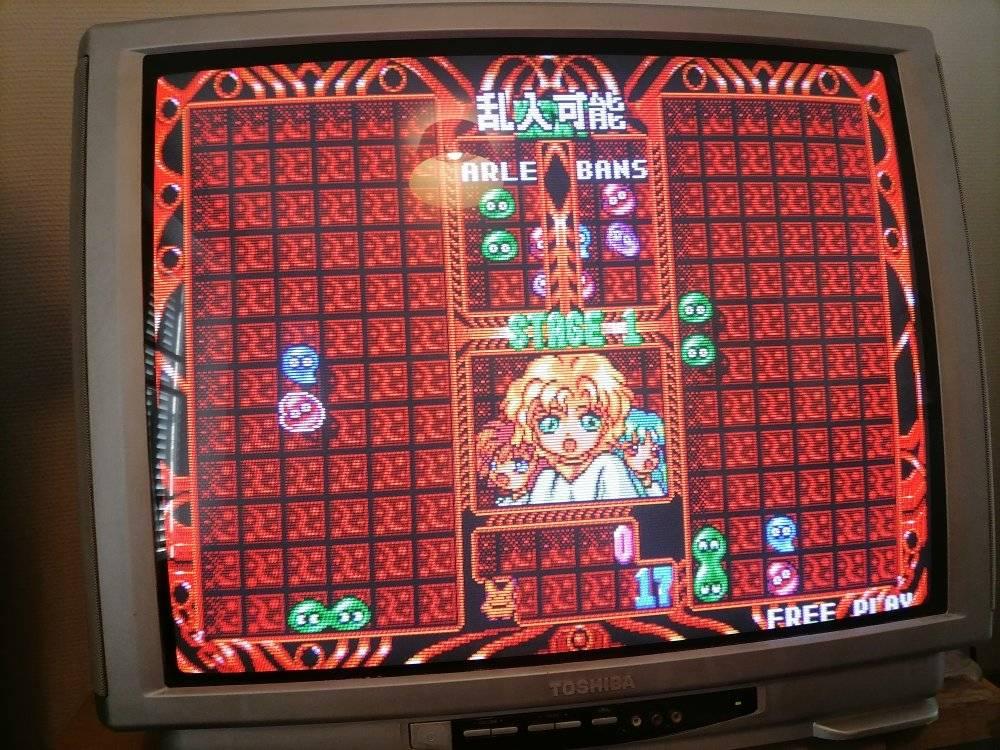

The game works absolutely fine (see pictures), but no one can send garbage puyos to the other, no matter how big the combos are (1P mode or 2P) ! the garbage queue does not even form. The game is basically in some sort of Pacifist mode

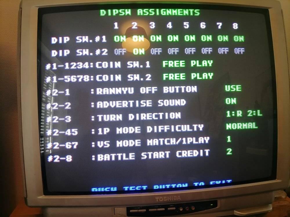

Is there something I'm missing ? I've tried the dipswitch settings but I'm not getting anything.

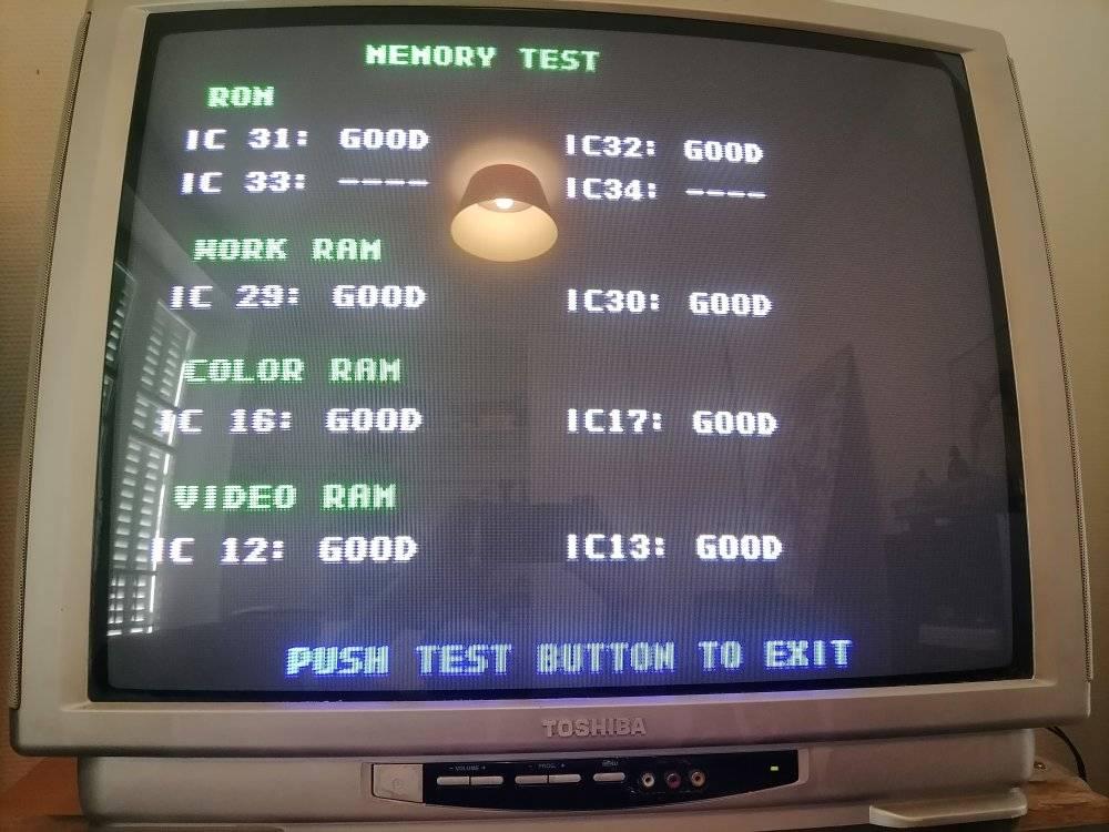

This is the typical protection feature of the game.
You conversion uses non patched ROMs.
Well, that's original to say the least ! 8|
Unfortunately, the link for the patched roms is dead :(
Burning the patched roms fixed the problem, thank you everyone ! :)
