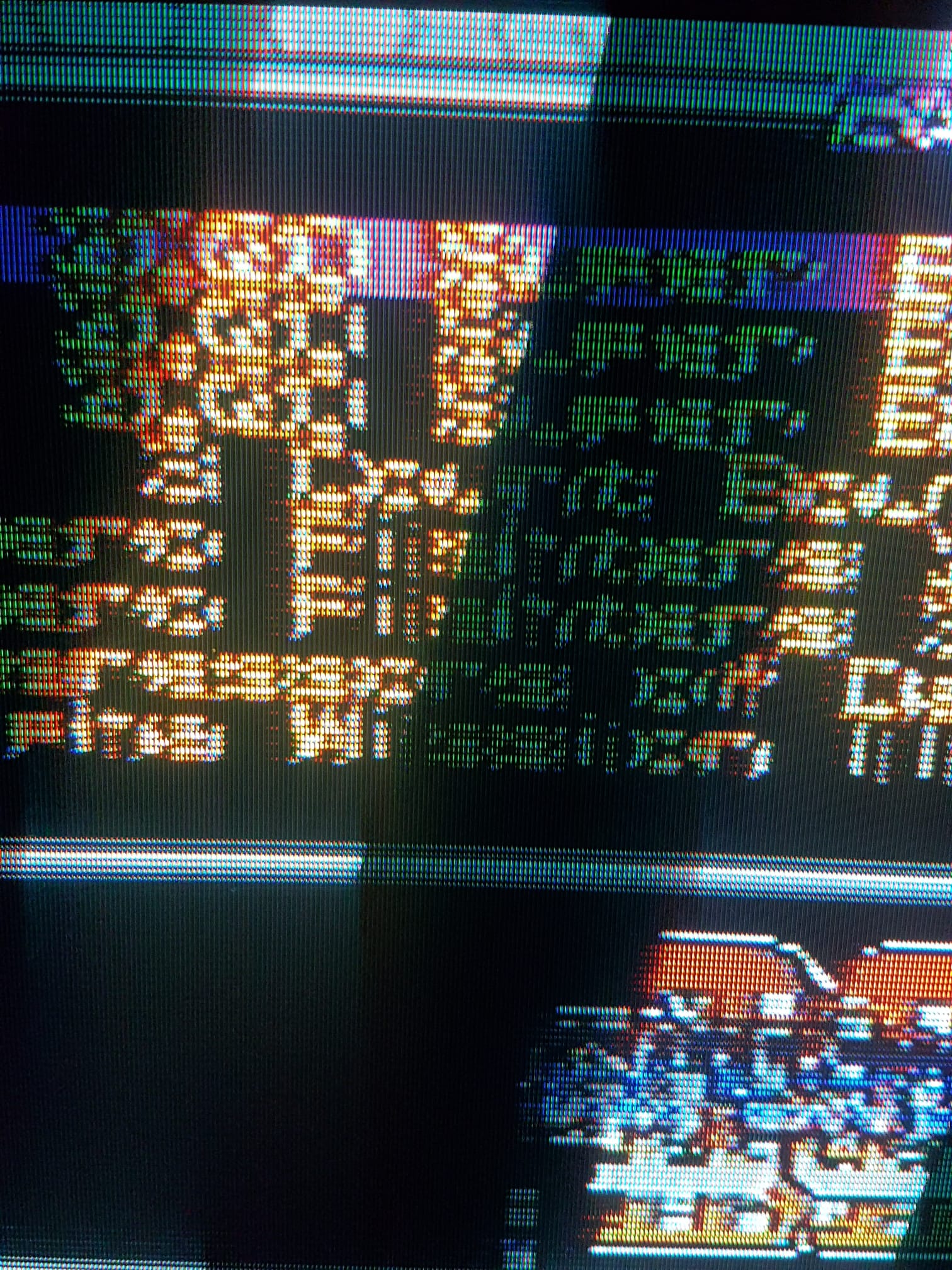

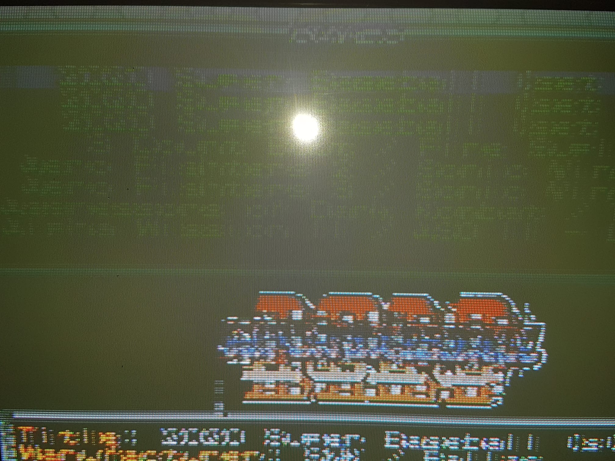

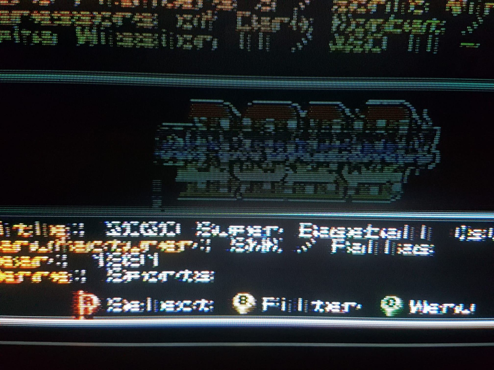

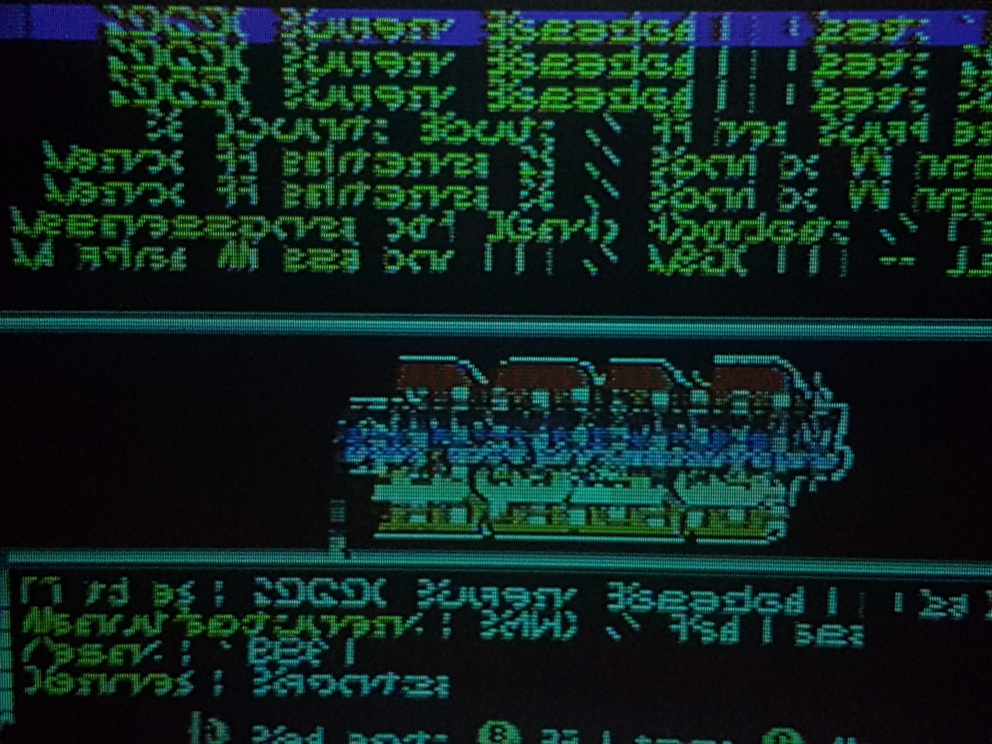

Hi everyone! I recently got a neo geo aes Darksoft cartidge, i followed the instruction to update firmware and menu and i used it.
Each time i keep playing for a while and i use the buttons combination to go back to the dashboard, i get artifacts on the screen and the game names are not readable.
I do not expect this to be normal, even do, one friend of mine, told me he has similar problems with his darksoft cartidge.
I did many trials and i am still testing the cartidge, by the way even during gameplay i do not have issues, while going back to the dash i get problems, if i reset the console everything goes back to normal. Any suggestion is highly appreciated.

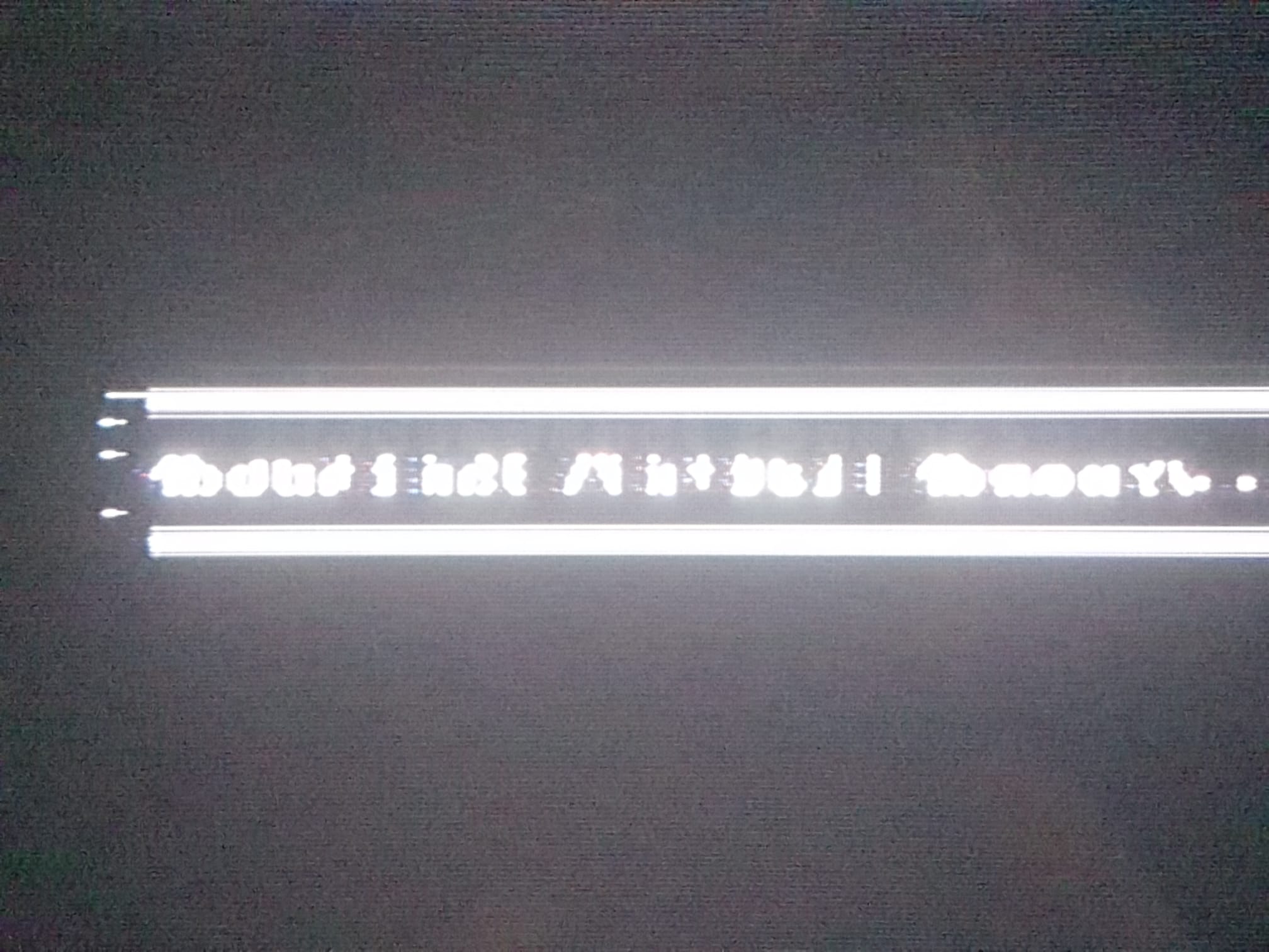

Hi, in first place, thnk you for answering me. Yes i did everything you mentioned me, the card is new, so it doesn't really need to be cleaned, even do i did it as the connector in the console. About the power supply i use a 9V 3A and i tried as well a 9V 2A, the result is the same, normally to play original games i use a super famicom ps, that gives 9V and not even 1A, wich is fine to me i can even use a magickey converter to play MVS games and 161 multicart. I've been testing the cartidge on my other neo geo, still i get the same result.
Everything fine when i switch on the console, i can load on the 3 slots my games and launch them, skip from one to another and all is fine, but after playing for a while and using the up+start button to go back on the dashboard i get artifacts, unreadable wirtings and that's it, the firmware and the menu are the latest stable version... i really do not know what to do.
I am in touch with a guy on FB and he is getting issues as well, it looks like the cartidge is far from being stable!

Have you tried another SD card by chance? Are you writing the files on Mac or PC?
Hello Fabio,
as I said you via PM, you can send the cart to Aldo and he'll have a look. We have seen many problems related to old PSUs or modded AES,etc. The problem that you mention looks to me like PSU related.
If someone else has one idea about what to try, please go ahead.
Thanks.
