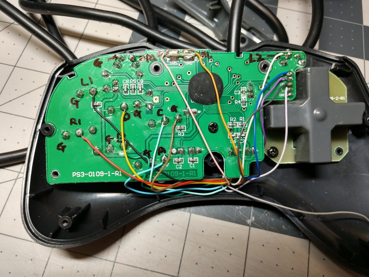

So I went ahead and did modify a PDP versus controller for PS3. I yanked out the original USB cable and just soldered in a cut Neo Geo joystick extension cable. My MV1B is still in the mail though, so I can't really test. Maybe I'll rig up some LEDs on a perf board for testing. Or maybe hack up another controller with a D15 to connect this into.
