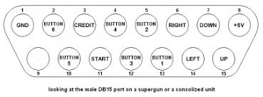

hi mageta thanks for the reply,I'm sorry,I was too unprecise,here's the deal:

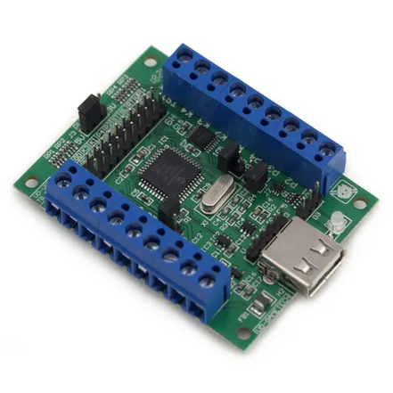

i've been searching for a way to use modern controller or even psx/ps2 controllers on a namco system 12 board (tekken tag tournament)I've seen the undamned pcb board that converts those controller to analog signal and they are very ideal(but i cannot purchase them because in italy the shipping cost would be too much to handle) So I've found the same undamned board but they use this db15 standard that also the neo geo uses(but they are too expensive to purchase ,also the shipping cost it's insane) therefore I was doing a bit of a research and I've found that there a lot of these psx/ps2 or even ps4/xbox etc converter to neogeo db15 made by nekotec,chinese retailers from aliexpress and even brook themselves,I've researched a little bit and found out that the pinout of the neogeo (db15) looks very similar to straight jamma inputs (every pin is a single input command)except for the 5v,I was wondering if I could use one of those neo geo adapter on a normal jamma board like the namco system 12 I've got,also (on a another forum) someone suggested to use the nekotec one on a normal jamma and it would work fine

How are you planning to get the board running? Do you want to consolize the Board or use a Supergun? If you consolize it (you propably shouldn't) you can use any pinout you like so the converter should work. If you have or get a Supergun it will most likely have a DB15 port with the pinout you posted which also should work with most Adapters (The brook PS4 -> NeoGeo does)

@darkpolletto your approach is ok here. I can confirm because I do similar on some of my machines. In my case I have the control panel wired to a set of female DB15 plugs and either use the JAMMA wiring from the cabinet terminated to a set of male DB15 ends for P1 & P2 or swap to a pad hacked console controller also terminated to male DB15 for when I want to connect a console to the cabinet.
The approach should be similar for superguns, assuming you plan to go that route instead of a full on arcade cabinet. Sounds like you are hacking together a JAMMA harness setup if I'm reading that right and if that's the case, then all you need to do is wire your digital control signals to the appropriate pinout for your intended control device or adapter. Add in the +5v signal for anything that might require it (undamned USB for example) or don't if you do not plan to utilize it. My console padhacks don't need it so I did not wire it in for my own setup. I also have some Neo Geo pads that function perfectly in this setup as I wired up the DB15 ends on the JAMMA side to the extended Neo Geo standard. It's a quick swap whenever I want to use that instead of the control panel.

  • PSX / PS2 controls have more inputs than the 15 available that you can wire up natively with a DB15 setup. You'll need to either not use a few or wire the extra ones to some place outside of the JAMMA edge + kick harness if you intend to use all of those inputs somehow. Similar applies for newer consoles ie: PS3, PS4, Xbox variants, etc
  • I can't speak to the nekotec converter you have pictured in one of your replies but before going that route you should confirm how many inputs are active and what the pinout actually is on that DB15 plug. There are some Neo Geo converters which do not carry more than 4 active action buttons, since 4 is the total available for Neo Geo. You might be better off in general to just wire up your own solution in this case.

Considering this is a new thing for you re: playing arcade games outside of a cabinet, I would suggest making things easy and explore the pre-made supergun options. It just makes more sense for a lot of reasons. If you get one that's been made properly, chances are good that the control interface will already be wired correctly for extended Neo Geo standard. HAS is definitely done this way and that's just one of many great features for that solution. Further, a common setup is attaching the Undamned DB15 to USB adapter directly to the HAS supergun and having controls adapted for modern USB style devices.
If you're dead set on going the analog route and using PSX / PS2 or anything older than most USB control devices, then you will likely have some work to do. There are a few good PSX to USB adapters available if you want to try going with a multiple adapter situation (pair it up with Undamned USB adapter) but you will need to do some testing and research to see if it will work the way you're looking to use it. I don't know if anyone else here has done this or how successful they have been.
