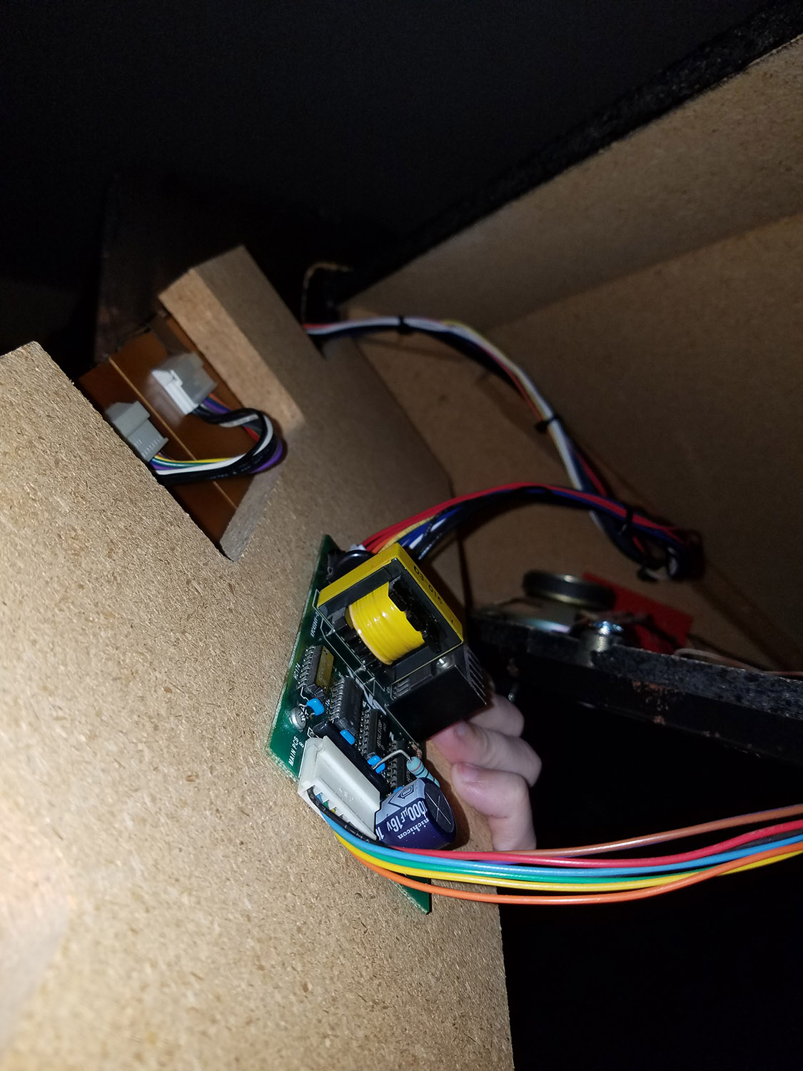

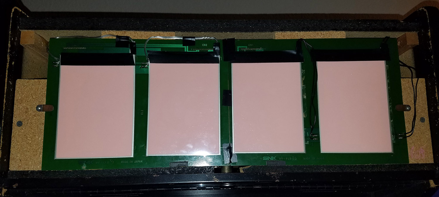

There's not much to it. There's a harness that goes from the motherboard to the MV-ELA (bottom of my first pic and far right of the second), then a another harness that goes from that to the back of one of the MV-ELD boards (top of the first pic, runs off the left of the second). Then another MV-ELD board connects by way of another small harness (top left of the first pic, bottom center of second). I assume the 6 slot is the same just with a third MV-ELD board, but someone with one would have to confirm (maybe the MV-ELC is actually a three panel board?).
The MV-ELA board is typically mounted on the back of the board behind the marquee, and the panels are mounted on the front. There are openings at the top for all the wires and connectors to fit.

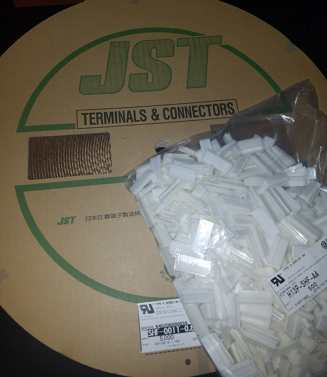

I've got literally hundreds of the 15 pin connectors and pins if you need them to build the small harness (looks like you have the main one). If you need any other specifics, let me know. This is all laid out in the manual as well, but pics definitely help.
Back of marquee board showing the MV-ELA, harnesses, and connections to the MV-ELD boards:
Front of MV-ELD with EL panels off:
Marquee back in place and showing game 2 panel on:
Tons of JST 15 pin connectors and pins....
