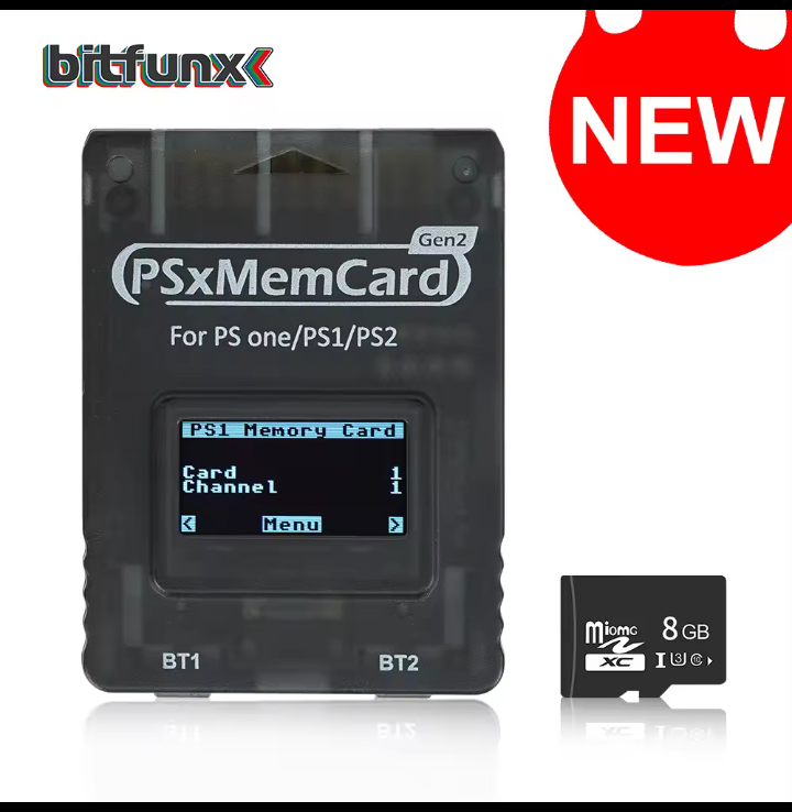

There are also some commercial alternatives, like bitfunx own version
Note: I'm not getting any benefit on promoting/showing the bitfunx card here, I only show it because due to its design, it SHOULD fit perfectly on the namco system 256, while other models may not due to having thicker casing on the display area

Are there any downsides to the Bitfunx version of the product as opposed to other makes?
We don't know yet, since the product is not being shipped yet it seems.
However, bbsan2k (one of the devs that worked with me on this firmware) got a prototype before bitfunx published it on AliExpress and it seems to be good, so far there are no reasons to believe it will have any downside, beyond some aesthetic details, like having the product name printed on the casing.

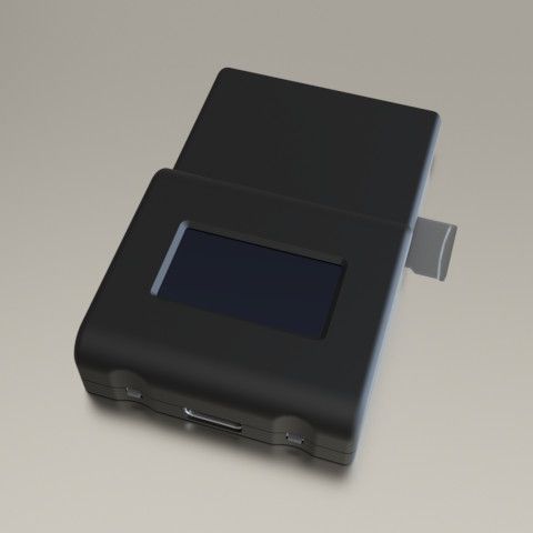

I haven't had much time over the last year to mess with the System 246/256 again, but I'm curious: does your SD2PSX card fit all the way into the card slot? On both my systems it doesn't, so it's barely making contact (it hits the "bump" in the case for the display...). I got a dozen of them made at PCBWay a few months ago, started experimenting with them and.... work/life came crashing by.
That sounds amazing! I was already using a SD2PSX with the COH keys, but it is really annoying not seeing the game ID, so I kept going back to using a SYS2X6 and/or backup COH cards written with my utility. Using the boot VMC for a menu is genius, great idea!
Let me guess, you have system 256...
That's a known problem because those systems recycle the PSX memory card slot, but the slots are a little bit deeper on the casing than on the PSX. The bitfunx version of SD2PSX should fit perfectly on the 256. On the 246 this is not an issue bc it uses the PS2 FAT card ports
