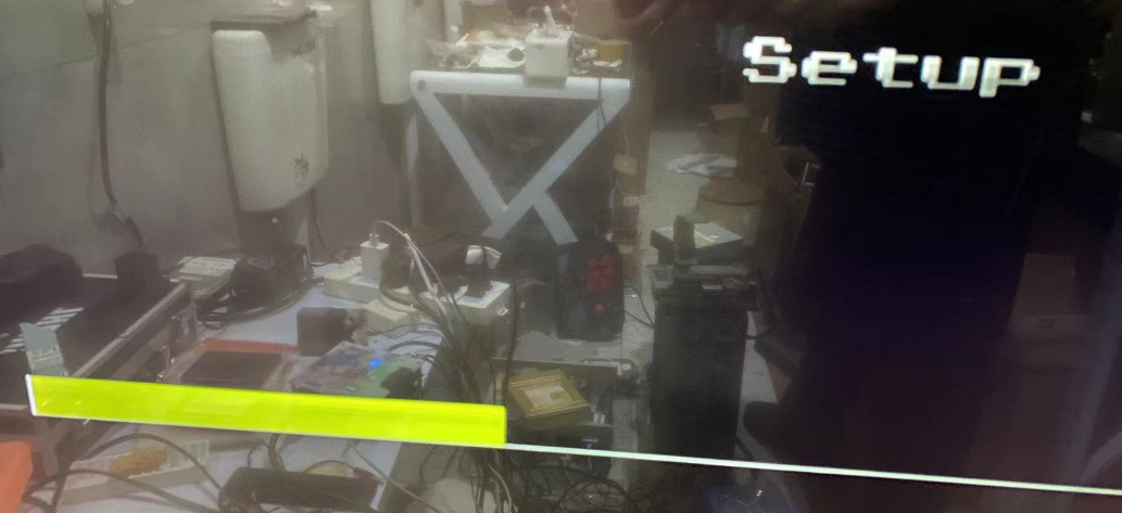

After startup, it keeps looping in the steup interface on namco system 246B and does not read the next step.

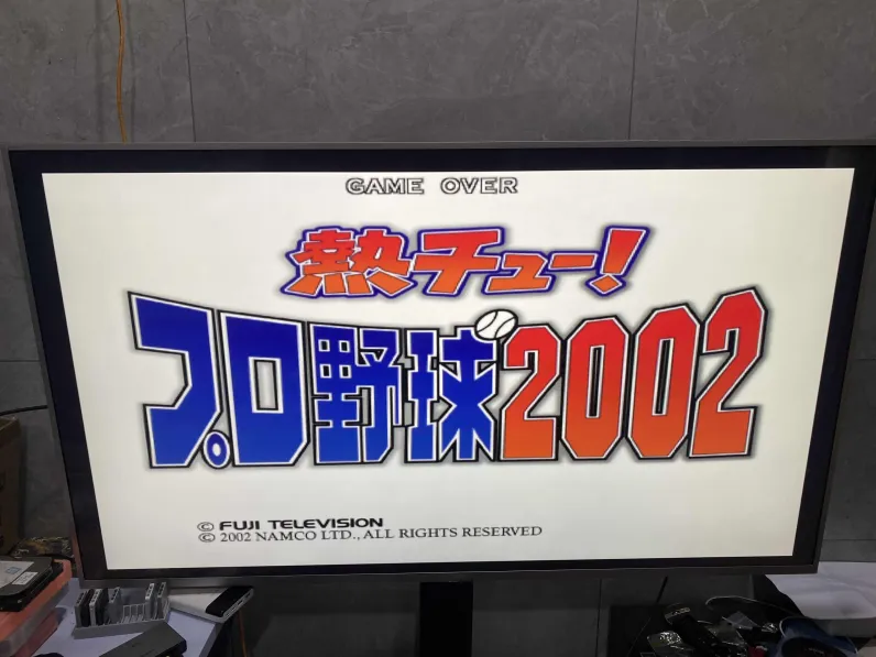

When the system is in this interface and is reading the game disc, press the open door and take out the game disc,
then it will prompt in red font: No Disc Inserted. At this time, close the door and let the system read the game disc normally so that,you can play the game normally.
