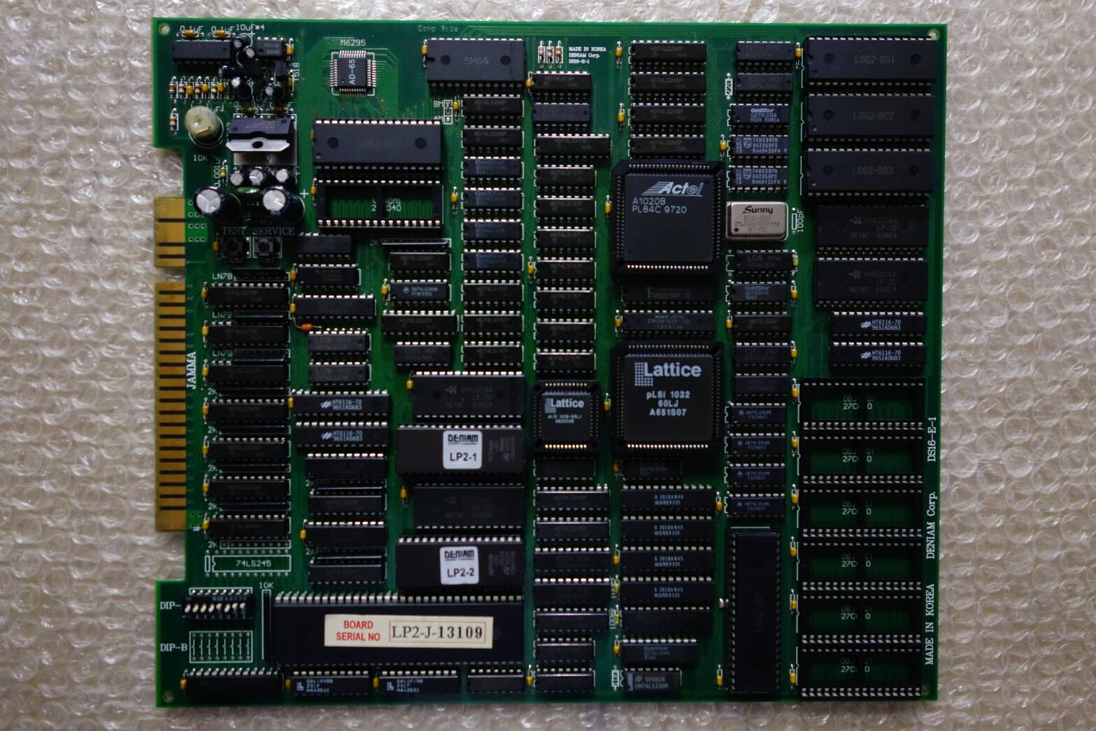

Here's a picture of the Logic Pro 2 PCB for anyone that's interested:
There are several hurdles, different memory map, different memory size, different sound section (µPD7759 VS YM3812), etc.
To sum up quite a lot of work...
The different driver in MAME makes sense.
