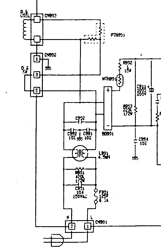

So I've spent some time trying to figure it out and I am pretty sure the pinout is AC / AC / GND / DGauss / DGauss.
But what's the relay for? What's the extra connector on the chassis for? What's this monitor from?

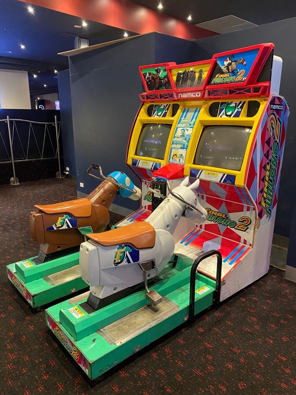

I talked to the person who sold it to me, and apparently it's from a Namco Final Furlong 2.

Final Furlong looks like this:
It doesn't have NamCam.
Also, NamCam never has it's own screen. The pictures it takes are displayed in-game, on the main screen.
That may be, but as you can see from the cabinet, there is no camera. Maybe a feature that was planned, but left out? Or maybe the board serves a different purpose in Final Furlong.

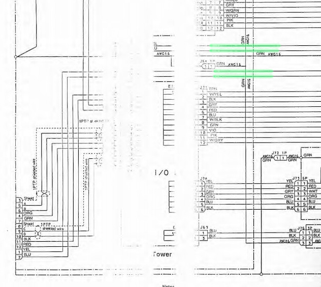

I think I found some detail in one of the many Time Crisis 2 manuals I've found (this one from files.arcadeinfo.de. There are a few variations of this game, the European version is definitely different to the US release. This PDF is definitely one of the top-5 worst PDFs I've ever had the misfortune to need, but it seems to show the 5-pin connector on the monitor, and my guess at the pinout was more or less correct. One of the degauss pins is GND which is not normal, so that's good to know.
The other one, pin 4 (Degauss, White/Yellow) goes to the degauss switch. But the other side of that degauss switch runs off into the cab somewhere I can't follow.
I'm wondering now if the two degauss buttons are simply triggering the degauss circuit in both CRTs at the same time, which might explain the need for a relay. Still doesn't tell me what the other side of the degauss switch is connected to though.
In this image, the four lines from the two degauss switches are heading from the switches on the right, into the great photocopy void. After that... It's not clear to me.

I heard back from the person who sold it to me. They sent a couple of photos of the wiring diagrams, and it turns out... It's just a normal switch, after all.
I have no idea why it's more complicated than normal on the monitor end.

The degauss button on the MS9 directly passes 120v AC with a reasonably high current through the button itself to the coil for a short time. The relay is likely there as a safety improvement so the button is a simple low voltage switch to toggle the relay.
That's hugely surprising to me. There's often an audible click from the chassis when degauss is done, I assumed there was always a relay on board somewhere. That the AC power runs through the switch itself is... Well it seems unwise. 😬
