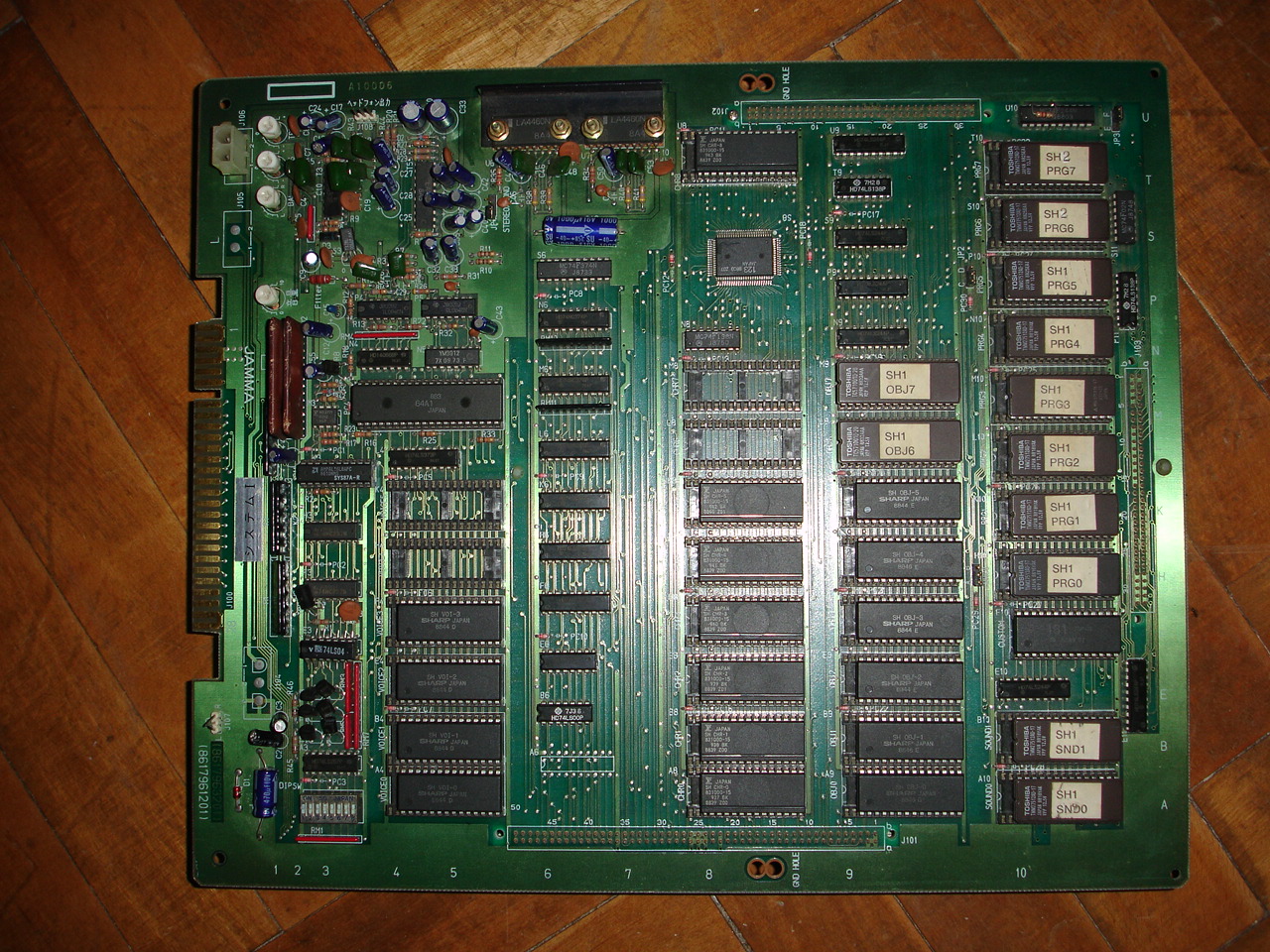

No, but you don't need them to verify its authenticity... It's the Namco System 1 board, and if its legit it will be populated with mask ROMs.
This is a picture of a converted Splatterhouse, notice how the entire board is populated with EEPROMs (a "real" one won't look like this)?
EEPROM (UV erasable/writable)

Sometimes you see a mixture of EEPROMs and mask ROMs, these are often times still legit boards that either had repairs or sometimes even factory made conversions in rare examples.

See what it looked like originally (as a Galaga 88)...
A mix of EEPROMs and mask ROMs, but NOT 100% EEPROMs.
Original
Converted

There is also a Japanese setrom with all the eprom, but with labels and key chip.
Got a pic from it - seems to be exactly similar as in LHantz picture :-)
Also 181 key chip there.
Anyway, I'm quite sure I don't like the game... Most likely some conversion will follow after testing.
If you don't like the game, you'd be better off selling it and then buying a Pacmania or Galaga 88 for conversion purposes. An original Splatterhouse is one of the more expensive System 1 boards.
