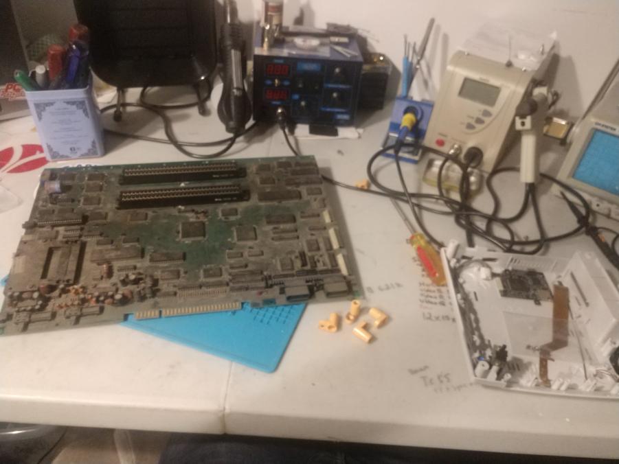

So update. We played around with the wave runner tonight. The PVM did not find the sync signal but we are able to remove the pins from the RGB cable coming from the Model2 and plug them into the GBS. Problem is we dont have a VGA monitor readily available so we will have to pull one out and try tomorrow.
In the mean time, we cleaned up the inside of the Mitsubishi projection monitor. I wish I got pictures but the thing had like 25 years of dust on it it was NASTY. We blew that all out and even the interior behind the fresnel lens.
The projection screen will not fire the 3 crt projector tubes up as I thought. The tv gets power on the front controls where the power light is and you can hear a faint buzz from the fly back. For now we still want to test that the Model2 actually is functioning using a different screen.
Lastly the Jetski when we held it straight had like kicked into place or something on power up and stayed centered a bit. We still need to check out all the air lines and re greasing everything in time.

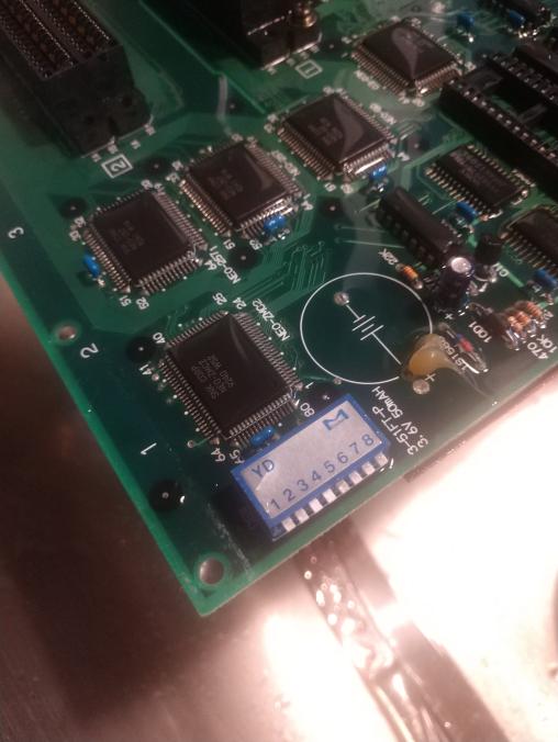

Also of note the one NeoGeo 2 slot board was disgusting i think a small mouse was eating sunflower seeds inside it. I actually washed that board, soaked the small battery leak area in vinegar and its looking good as new no real corrosion either! We also removed the batteries from all the neo-geo boards.
