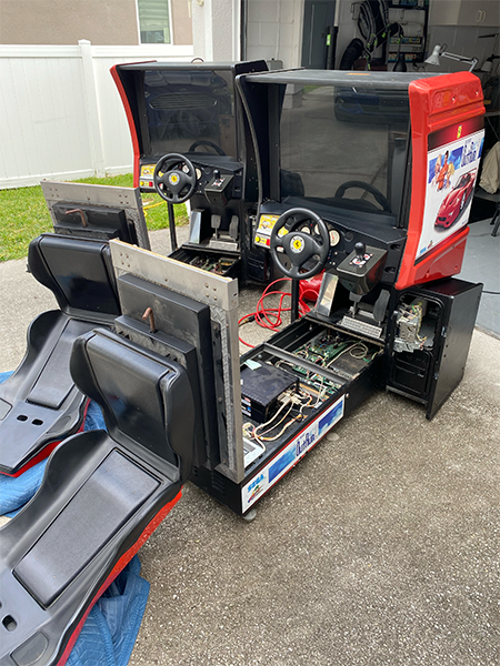

I picked up the machines a few days later and quickly realized the amount of work that these cabs needed. Someone really jankified these poor things. They have some really bad 19" LCDs with spray-painted cardboard bezels. Those will get replaced with CRTs ASAP.

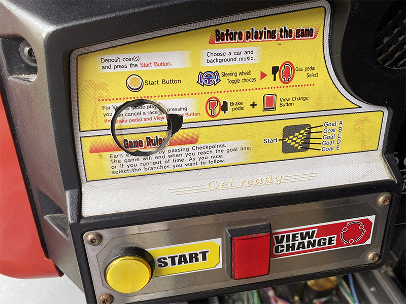

Someone drilled a credit button in the dash at some point, and then glued the original piece back in?
Oh and one of the coinboxes won't come off because a bolt is sheared halfway off, plus half of the bolts are the wrong size. Several broken buttons and a ton of missing screws all over.

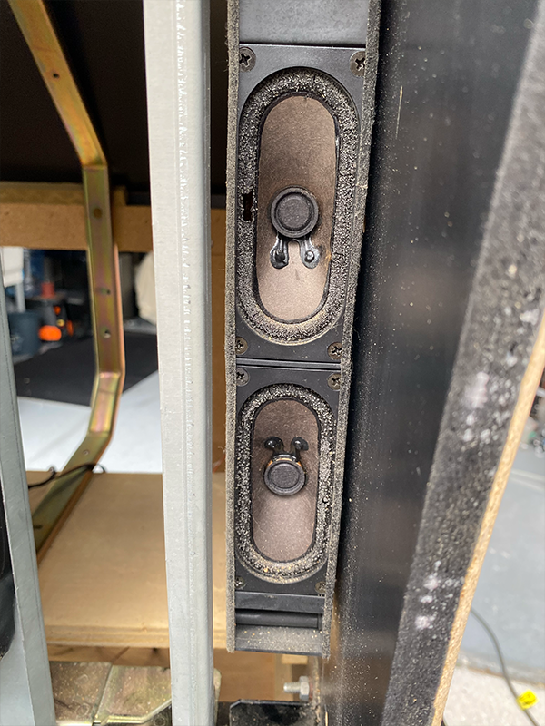

I was able to play the game at this point and it did work. The force feed back seemed a little loose, but it was technically working. One thing I noticed immediately was that the speakers sounded terrible. I decided the first thing I'd do is pull off the bezels to see how the speakers looked. Plus I really wanted to rip those LCDs out.
No wonder Magical Sound Shower wasn't sounding so magical. I have a blast city with the same style speakers that I replaced before, so I'll do the same with these. I'm really surprised Sega was still using these speakers when OR2 came out.

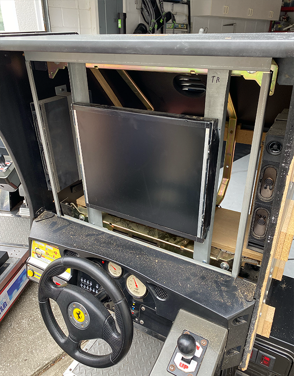

The early stages of the de-jankification process have now begun. One of the dashes was about an inch further forward than on the other cab. Looks like whoever put this thing back together after LCD-ing it didn't bother to do it correctly. The black duct tape on the sides of the LCD is a nice touch though.

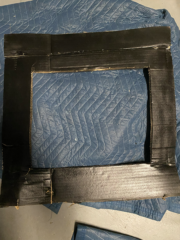

The "bezel" that was around the LCD. I am in awe at the craftsmanship.
There's actually a cutout in the dash for a credit button. I think what might have happened is that some player pushed it in and then it needed to be glued back on.
Ah makes sense. Unfortunately both sides are like that. I'm planning on filling them, sanding them down, and then getting repro stickers.
