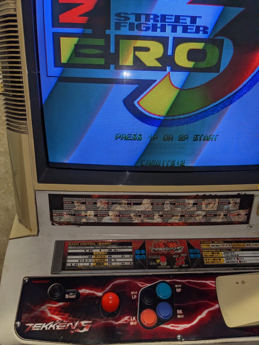

I put a Pandora's Box DX in my Versus City but none of the buttons worked, just the stick on the P1 side. My friend said I'd need a CHAMMA to JAMMA adapter but I just hooked that up and still none of my buttons work.

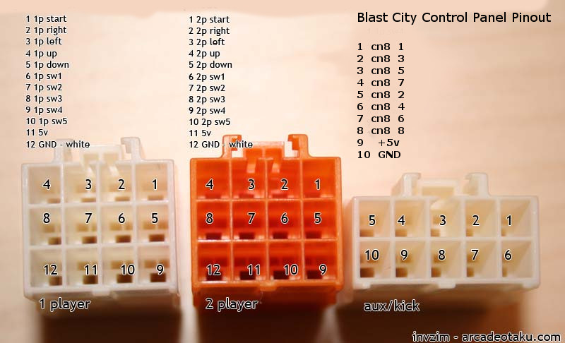

I mean could something be wrong from my buttons to the JAMMA harness. I found a JAMMA pin out diagram but I'm having a hard time making sense of the wires in my cab. I don't have a kick harness because I only have 4 buttons on each panel.

Follow your harness pinout carefully to each button. Then follow your ground pin to the cp and make sure each button has its ground connected.

As for the wiring, there's no guarantee that the color will be consistent all the way from the Jamma harness to the button. I'm not personally familiar with a VS City, but all Sega cabinets follow the same basic wiring for the control panel. Button 4 should be pin 9 when looking into the female connector under the control panel.

I tried using the Pandora without the adapter since I replaced the broken buttons. All 4 buttons work in Street Fighter games, with the top 2 buttons correctly set to LP and MP and the bottom two being LK and MK. Not very useful without a kick harness, but whatever. In 4 button games like Breakers Revenge and Tekken, button 4 still doesn't work.

I noticed something weird when using the multimeter. P1 button 1 is on pin 22 and button 2 is on pin 23, like normal. Pin 24 is not a button. I don't know what that orange wire is connected to. Pin 25 has button 3 and pin 26 has button 4. According to the JAMMA pinout I printed, 26 is unused.
