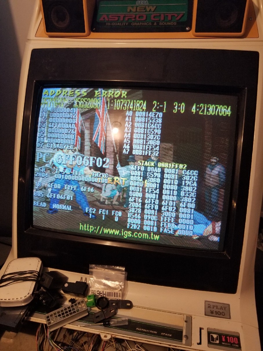

I got a PGM motherboard off eBay and I was able to get my martial masters cart to boot but it crashed a lot.
I took the pcbs out of the cart and inspected them and didn't see an issue. I put it all back together and now the PGM won't boot with the cart in. It'll boot just fine without the game but won't do jack with my MM cart in.
I don't have another game to test unfortunately so I'm looking for ideas.
I got this crash when I could get the game to boot on this mobo
